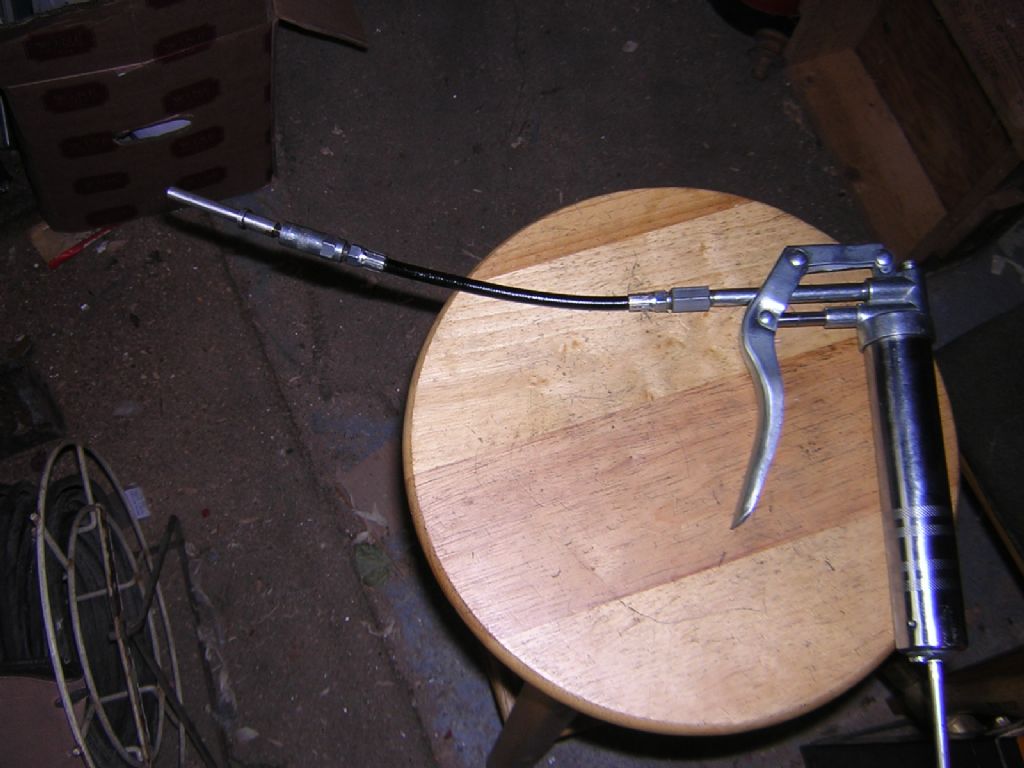

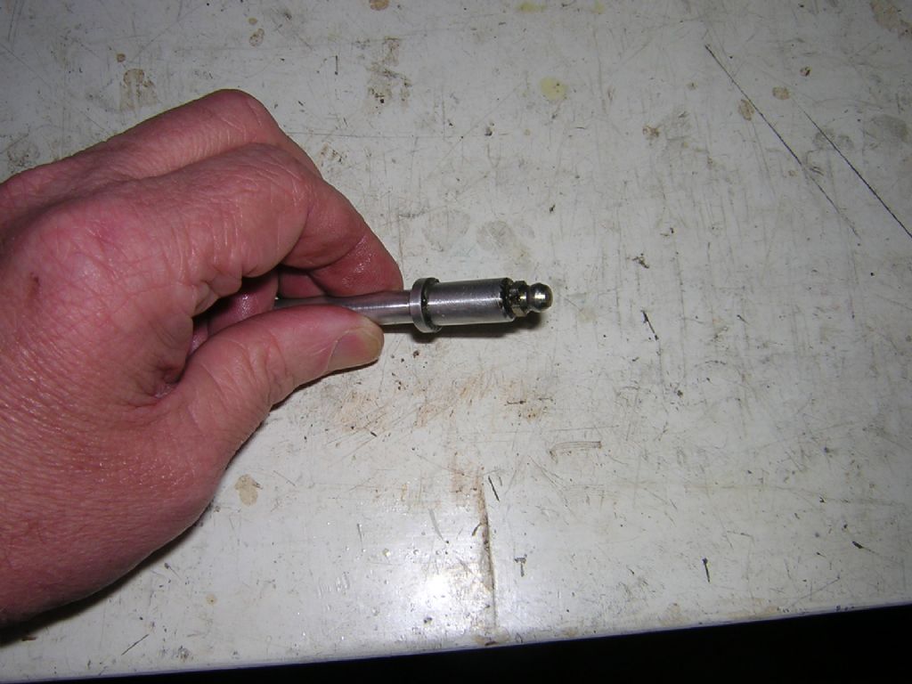

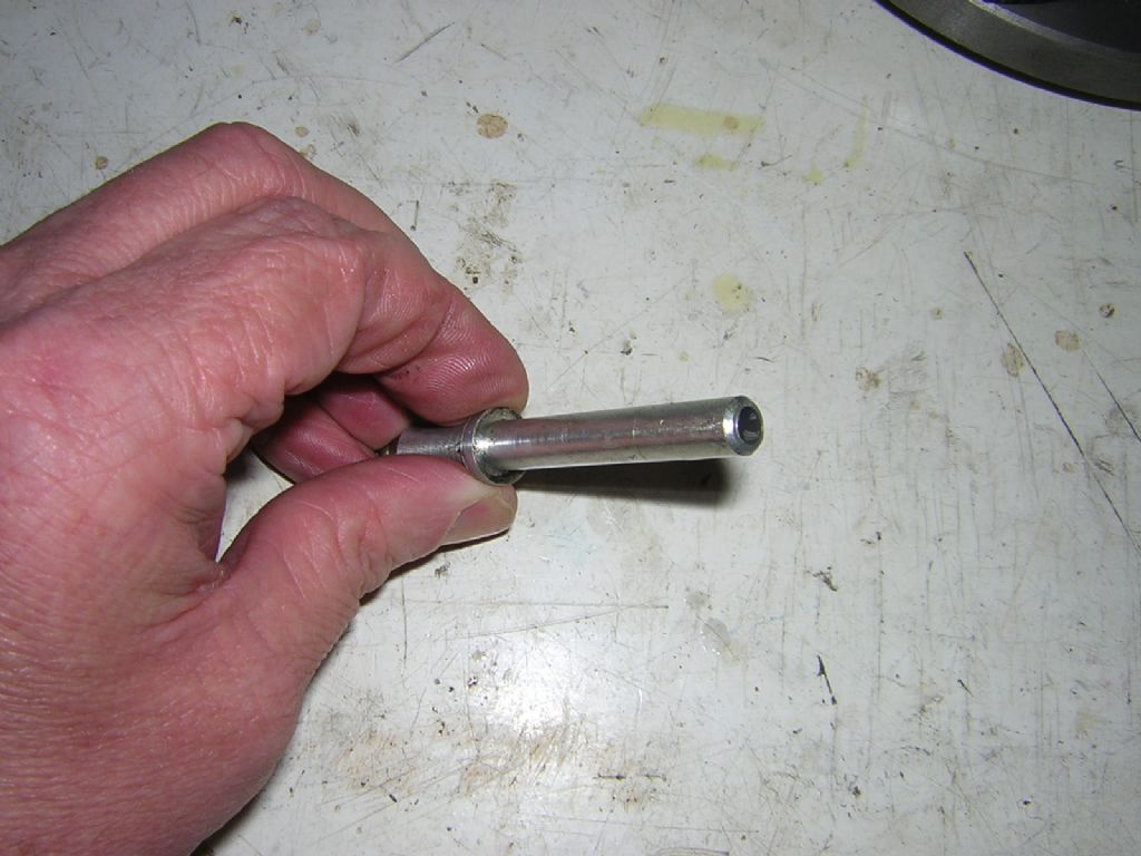

                Hi Harry, I made an adapter to allow me to use a grease gun, but filled with oil, to get to that nipple. It is just an ally rod, drilled through and tapped at one end for a grease nipple, and chamfered at the other end to suit the existing oil nipple. I use the grease gun held 'upside down' to stop the oil escaping.

                        Good thinking Ian just in from the work shop ! Bit of round brass 2BA thread on one end nipple on the other.
