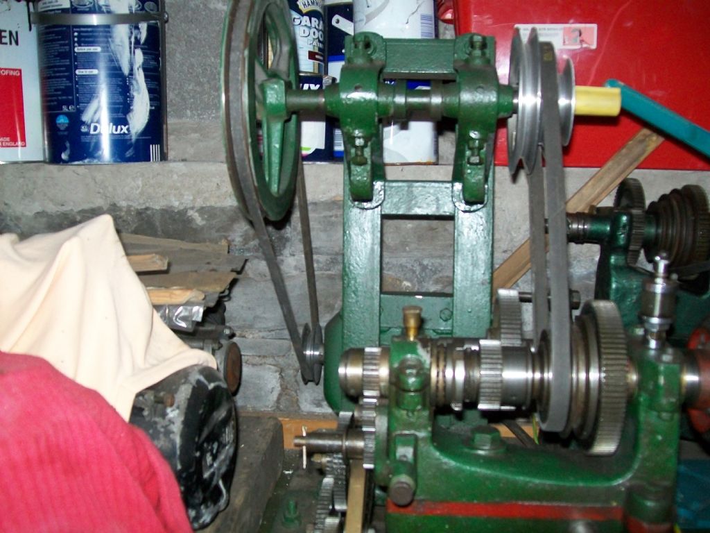

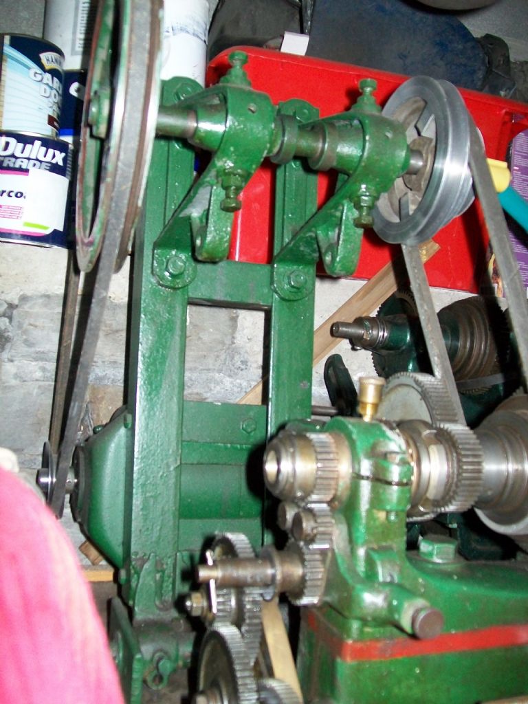

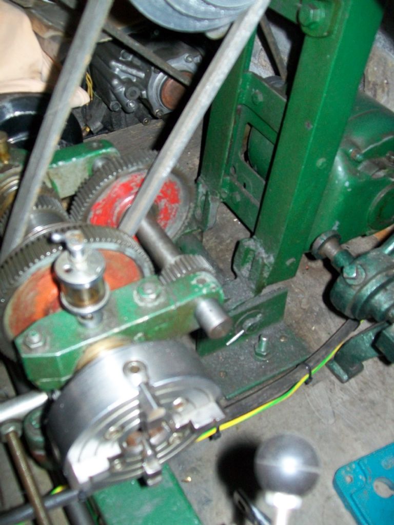

        Does anyone have a Grayson lathe simular to the one in my album. If you do, please could you show the setup of the pulleys and motor as I need to set my Grayson lathe now.
        Second point with this lathe. How do I know how much I am taking /cut as there was no measurement on the handles
        Pictures of my lathe are in my album
        Any help will be gratefully received or pictures of the setup would be great.
        Need to set the lathe up before a start on my Simplex loco

                      #76022
                      _Paul_
                        @_paul_
                        This is what mine looks like:
                        Regards
                        Paul

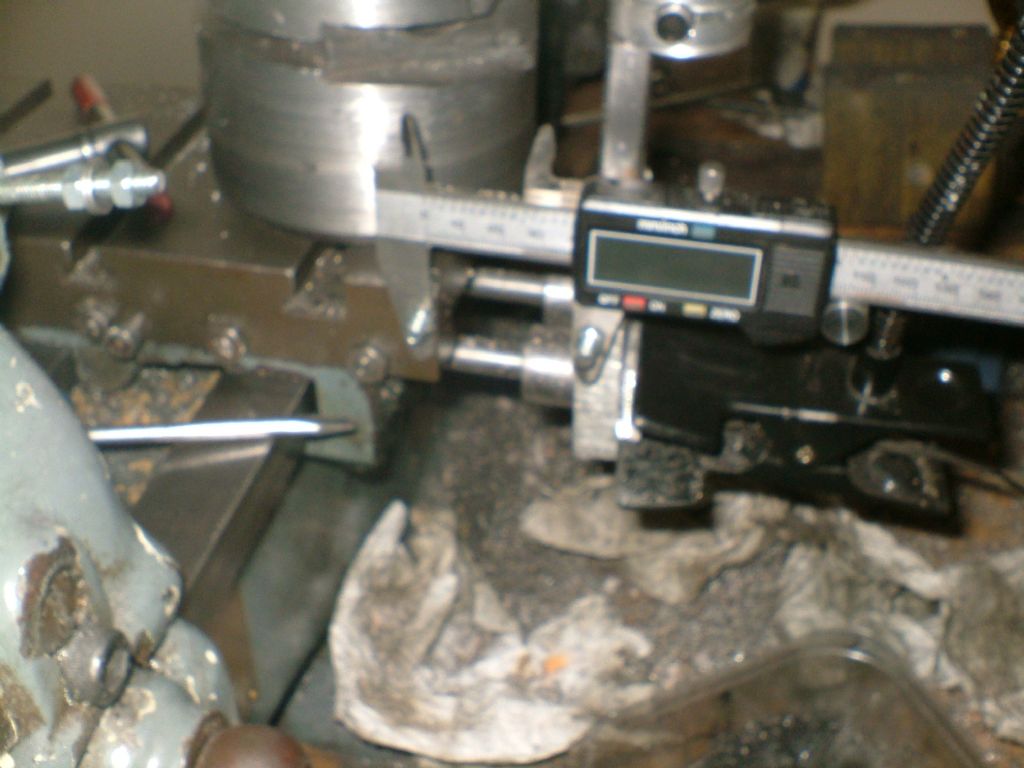

                            I would definitely recommend digitalising your cross slide.
                            This completely eliminates backlash issues and allows you to change between metric and imperial at the push of a button.
                            I got mine from this place because it has an auto switch off after around 2 mins of inactivity, the batteries are the cheapo AG13s from poundland, and it stores the measurement when it switches off, (some calipers reset at zero)
                            It’s no’ pretty, but it sure works great, wish I’d done it from the start.
                            details of my own one in here
                            http://www.model-engineer.co.uk/forums/postings.asp?th=55550
                            #82200
                            Mike Wainwright
                              @mikewainwright87512

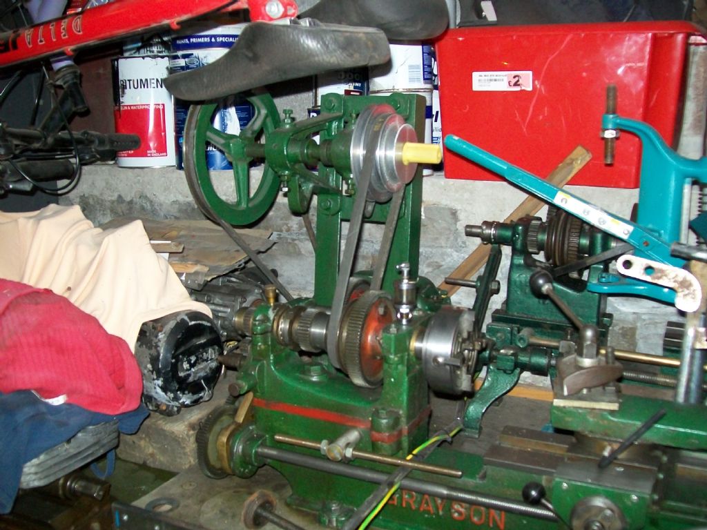

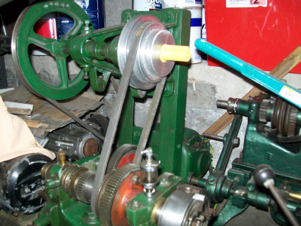

                              I have decided to get the Grayson working instead of buying a new or secondhand lathe. It has been stripped down and everything cleaned up. The old motor has been stripped and cleaned. New NVR switch bought and the motor has been wired up. I have made a frame for the motor and countershaft. The garage opposite me welded it up for me. I bought 2 new plummer blocks and a few nuts and bolts. All I need to get everything working is a flat belt for the headstock drive.
                              I have contacted http://www.lathes.co.uk but they want £35.00 for a metre of belt. Does anyone know where I can get a length of belt so I can join it together. I do not want to have to strip the headstock down again to fit the belt.
                              As soon as I can get this then I can see if the lathe is working ok. I know the headstock bearing were replaced and there is no play on the movement of the slides.

                                Can you let me know the width of the belt you require,[ if I remember correctly it is about 1″ or 1 1/4″ for the Grayson,] I might be able to help you

                                  If you have a look on E-Bay, use the search phrase “flat drive belt” you’ll find several suppliers who do it by the meter and can supply the alligator clips to join it.
                                  I bought mine from the chap in Penrhyndeudraeth, quick delivery and also wrote out the instructions for the clips. Very helpful.

                                    I assume that this is a flat belt drive. If you are desperate you could find a gents leather trousers belt of suitable width, scarf the ends and overlap them. Then drill a pattern of small holes in a rectangular shape through both bits. Fit the belt around the headstock pulley, bond the overlapped ends together with something like Evostick then stitch through the holes you have drilled with some waxed twine. This is what I did with a Myford ML4 (a close relative of the Grayson) that I had some years ago and it worked well. I never needed to replace the belt and it had the bonus that , with my great inexperience, if I had a “dig in” the belt slipped and disaster was avoided!
                                    On the other hand if you have a “V” pulley try RDG.
