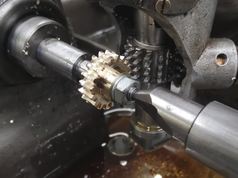

              Phil P
                @philp

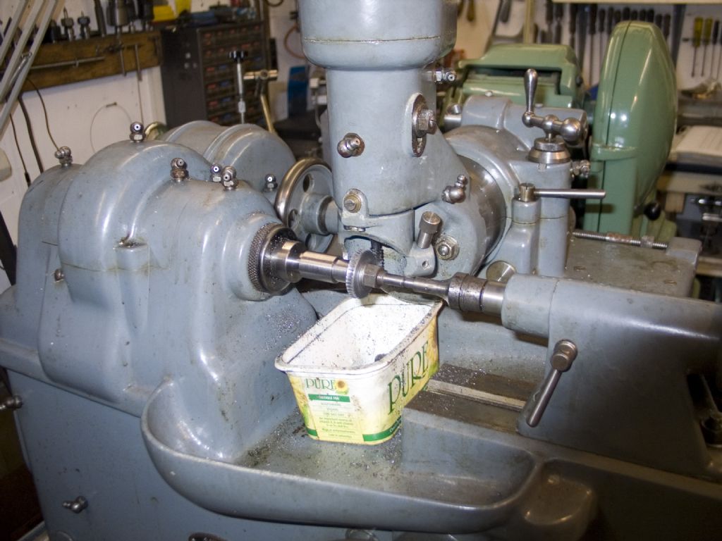

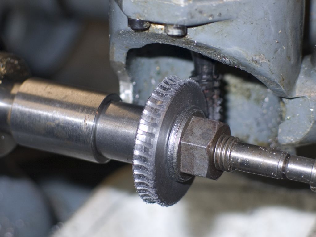

                Posted by Pete Rimmer on 01/02/2021 22:16:51:
                For hobbing a worm wheel you have no choice but to feed directly in (unless using a dedicated hobber with a 4-gear or electronic setup so you can make a full depth bevel cut in one pass). My machine can cut spur gears conventionally or worm wheels straight-in. To do a worm wheel with the teeth set at the helix angle of the worm I set the head over by the helix angle and feed directly in.
                Pete
                Are you sure about setting the head over to the helix angle for a worm wheel ?
                I would have thought it should be vertical to produce the wheel, other wise the worm that eventually drives the wheel would also have to be at the helix angle ??
                Phil
                #524269
                Pete Rimmer
                  @peterimmer30576
                  Phil,
                  If you set the head vertical, you'll generate teeth on the wheel set at the helix angle of the hob. If the angle of the hob is different to the helix angle of the worm, you have to adjust for the difference.
                  Pete.
                  #524271
                  Phil P
                    @philp
                    Hi Pete
                    Yes that is true, but in the ideal world the wheel should really be hobbed with the same diameter cutter as the intended worm otherwise there will not be full contact with the teeth if they are produced with a different diameter.
                    I was lucky with the one in the photo's, it is the worm wheel for my model barring engine, and the only suitable hob I had was actually the same diameter as the worm. That was a real stroke of luck.
                    Phil

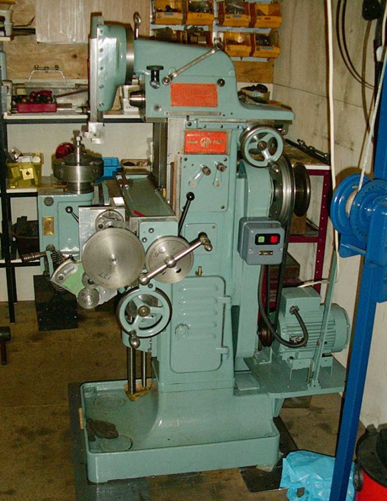

                      Phil P
                        @philp
                        I probably take it for granted, but I suppose we are pretty fortunate to have hobbing machines in our workshops.
                        Phil

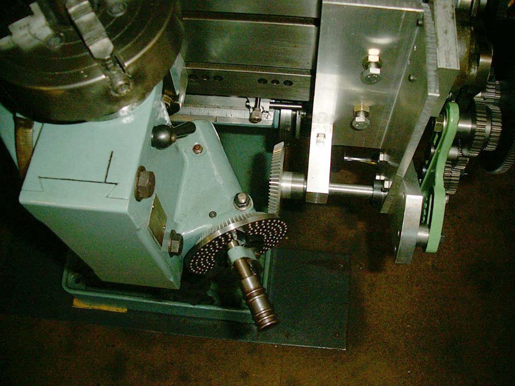

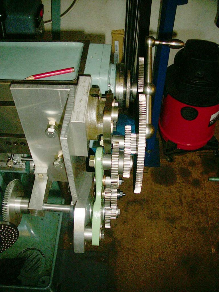

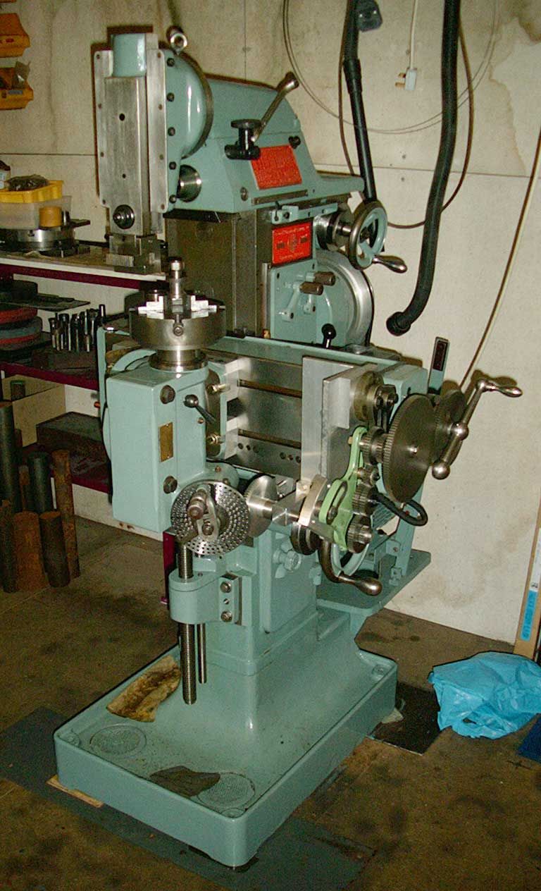

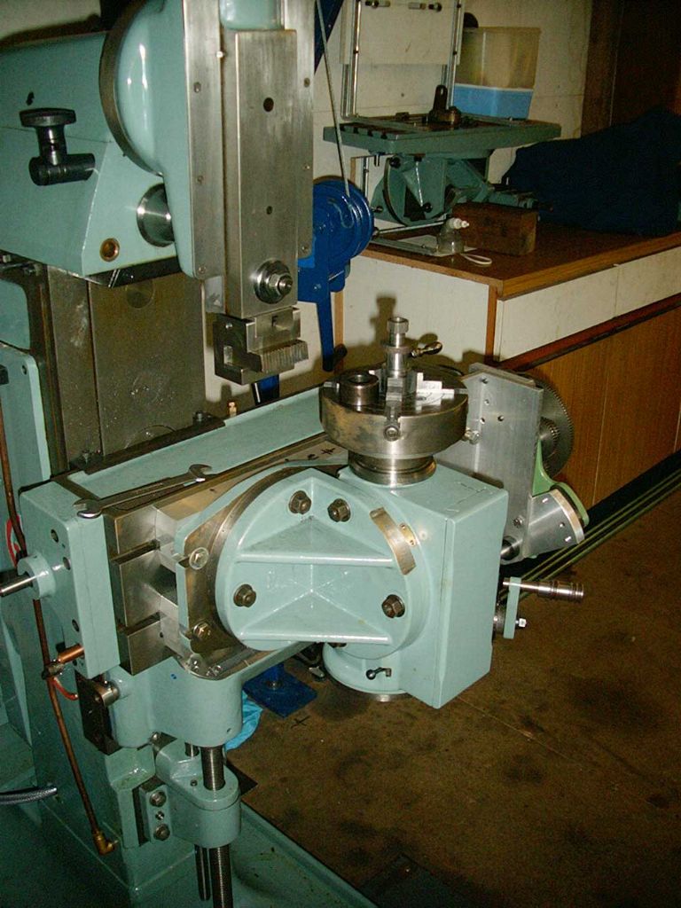

                          To disappear off on a slight tangent, I reckon that if you control the Z and the blank rotate in sympathy you can cut a straight spur gear with a simple straight sided form tool like you'd use for a rack. Much easier to grind the tool but a lot of cuts to generate the form. If it's CNC just let it get on with it.
                          When I worked on remote handling machines we got over backlash by having a little motor fighting against the big one to take up the clearance.
                          #524406
                          Phil P
                            @philp
                            Duncan
                            My late father rigged up my Alexander Master Toolmaker milling machine to generate gears with a rack form cutter by rolling the blank past the cutter a few teeth at a time. Very ingenious.
                            Some folks have seen these before, but its worth showing them again for the gear cutting geeks on here.
                            Phil
