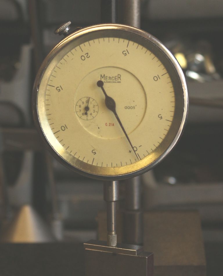

        Two slips wrung together WITHOUT oil give this result:
        Wrung together with oil give this result:
        The difference is there as can be seen – with oil we get +.00025" approx. I repeated this five times and got similar results each time.
        Rik
        #168328
          Trouble is, Rik … the Dial Test Indicator is not really a suitable tool for checking the thickness of Slips; so I'm not sure what your results actually demonstrate.

                    Michael – If this method of measuring is good enough for the inspection department at Cincinnati Milacron machine tools then its good enough for me!
                    As for what the results demonstrate, I would have thought that was perfectly obvious.
                    Rik

                        Posted by Rik Shaw on 01/11/2014 15:31:36:
                        Rik
                        Rik,
                        Based on your pictures, I presume that you have measured the thickness of your applied oil film.
                        With the greatest respect: I can see no evidence that you have measured the thickness of the slips.
                        Please … before replying, read Appendix B of the NIST document, and note my point about the differing interpetations of apparently simple terms.

                                Michael – I tried to put it to bed but it's not completely exhausted.
                                "With the greatest respect: I can see no evidence that you have measured the thickness of the slips."
                                The object of the photographic exercise was to demonstrate the thickness of the oil film using the DTI as a comparator. The thickness of the two slips is merely an irrelevance as the same two slips were used for the checks.

                                        Rik Shaw
                                          @rikshaw
                                          Michael – I think that my photos show that your "cheese" exists, I am having difficulty in understanding the point you are trying to make.

                                            I understand your test setup indicated the difference in indicated height between “dry” and oil filmed slips. ..
                                            And if I read the photo right about half a 0.0005″ division.. or about 250 micro inch.
