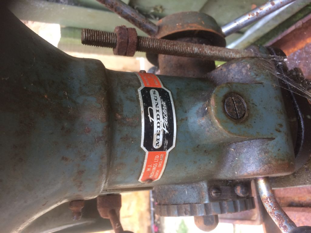

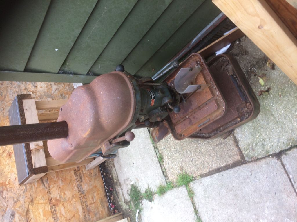

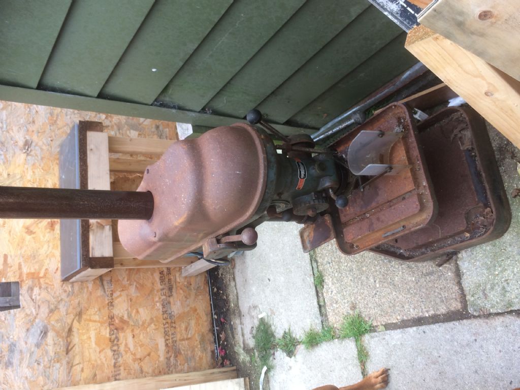

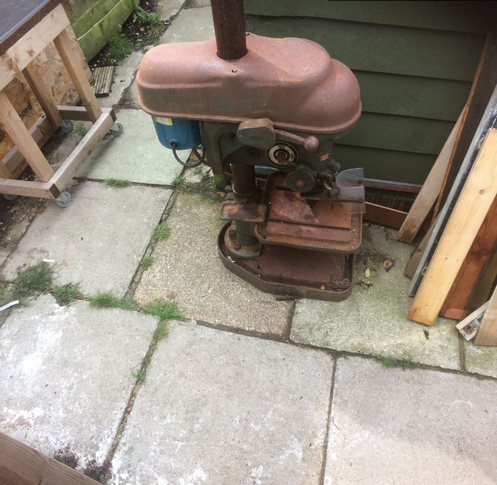

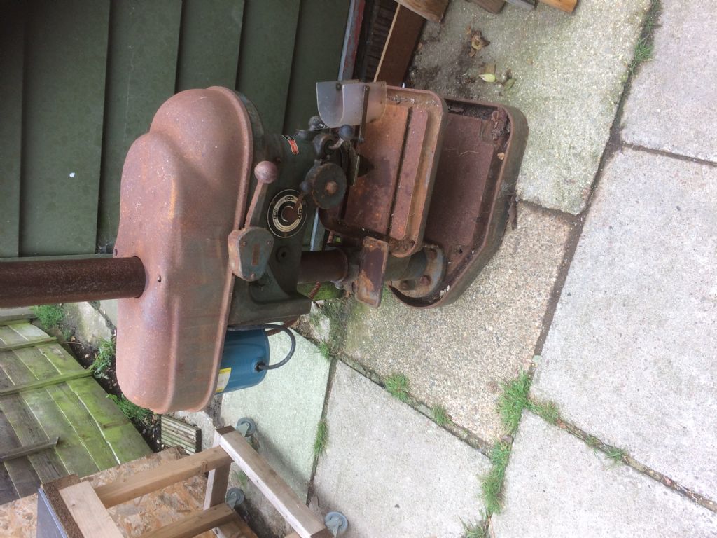

      one of the regulars in my local came up to me on friday friend s got a pillar drill he wants gone free picked up yesturday dingy old leanto on back of garage the rust is not as bad as it looks started cleaning it today it stands 6 feet tall 5 speeds on the pulleys high and low gear total ten speeds plus forward and reverse on motor dont make them like this any more very happy with my find sorry photos are wrong way roundimg_0934.jpgimg_0933.jpgimg_0931.jpgimg_0931.jpgimg_0930.jpgimg_0929.jpgimg_0928.jpg

          What a wonderful freebe. Try a Stanley knife blade on the rusty cast iron, you may find there is not much pitting at all.

                Very good machines,before you proceed too far with cleaning check that the morse taper spindle bore is in good condition ,old machines do turn up with damaged tapers and will retain drills and chucks.I once came aross an old Meddings which had the taper machined out to a parallel bore I never did fathom why , as the drill was free it was used for spares and the column was a useful length of tough steel.A machine tool fitter once told me the gears for the hi/low box are tufnol and easily damaged by operators changing speed before the spindle stops,his comment was "I have replaced an awful lot of those gears so wait till the spindle stops" .

                    The other thing is that the gears are supposed to be in an oil bath not greased. If the oil seal leaks and you are tempted to grease it use Landrover swivel grease which is formulated as a replacement for oil.

                      My bench-drill is a Meddings, though single speed-range and chuck only, but I am very happy with it. I often use the table/base as a surface-plate.

                          If you remake any gears out of Tufnol, do ensure that the laminations are the correct orientation. Made from a disc, cut out of sheet should be O K . Rod is a No No, or the teeth will soon shear off.
