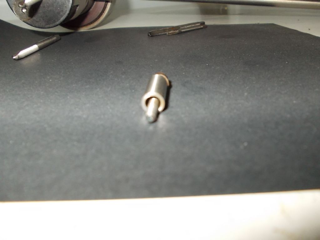

                            OK, let us suppose that you have a need to make some holes in a flat face, and they must all be accurate to size and precisely located with respect to each other and the edges of the piece. If you mark them out and centre punch then drill in the usual way the drill will wander and the marking out and punching will also allow errors. So instead of drilling out to full size, you drill and tap a small hole where each hole is to be. (With reasonable but not critical accuracy.) Then you take your toolmakers buttons and screw them onto the job at each location. The holes in the buttons have a bit of clearance, so now you can adjust the buttons so that they are in the correct location relative to each other and the edges. You know the size of the buttons, so you can set the spacings using accurate pieces of packing or by careful measurement, depending on the level of accuracy you want.
                            When the buttons are all in the right place, you can set the piece up in the four jaw chuck, and use the dial gauge to set one of the buttons to be centered. Then you take off that button, and drill and bore the hole to the correct size. Just drilling won't do, as the existing tapped hole may be off a little, so you want to bore it so it is trued up correctly on the axis of the lathe. You then set another button up to be concentric, and bore that one. When you are finished, all the holes should be accurately placed.
                            The same thing could be done on a mill, setting each button on axis in turn, but it is usually easier to do coordinate drilling on a mill, eg use the graduated handwheels to set up the coordinates of each hole in turn. (Or the DRO if you have one.)
                            Buttons are easily made from small slices of round stock, faced on each side. Quite commonly each face is recessed a little. For occasional work they need not be hardened. Stock that is accurately ground to size is nice as it can make the arithmetic easier. (I want two holes 1.25 inches apart and my buttons are made from 12mm ground stock….what size packing should I use between them?)
                            For some awkward jobs it might be better to use the button approach to make a jig, then use the jig to make the holes in the job match. Making the holes in the bedplate and cylinder block of an engine like the Stuart twin and compound launch engines would be an example of this sort of thing.
                            #176928
                            Larry Coleman 1
                              @larrycoleman1
                              Good description John
                              How those toolmakers buttons came about is a lot of small tool rooms did not have access to a machine called a jig borer and when you make what is called a follow on die or a die which has say five stages before a component is completed the accuracy between stages are very important. Because the strip progressed by what is called a crop stop or a pilot punch if the second hole is .001" out it is then multiplied x 4 at the final punch process.
                              So you have to be able to at least get those holes within .0001" and you can not mark out Centre punch and drill to that accuracy. The die block is then ground square and you choose an X & Y position. After marking it out with a height gauge you centre pop each hole position and drill & tap for the button screws.
                              Each button has about .060" of movement and is a miniature cylinder square so you measure from the X side minus half the button diameter and then from the Y side minus half the button diameter.
                              Then you place the die plate in the chuck and dial the front face rotating true. Then you dial up the button until it runs true then you check the plate face to check its still true. You repeat that process for each hole always measuring from the X & Y.
                              On most occasions you measured with a depth micrometer so your hole can be within .0001"
                              Now I earlier brought up the cylinder square because the toolmakers buttons are miniature cylinder squares.
                              Help me out here John is that to complicated ?
                              I will come up with some pictures shortly.
                              Larry
                              Edited By Larry Coleman 1 on 23/01/2015 04:06:32
                              #176929
                              Larry Coleman 1
                                @larrycoleman1
                                End view Toolmakers button

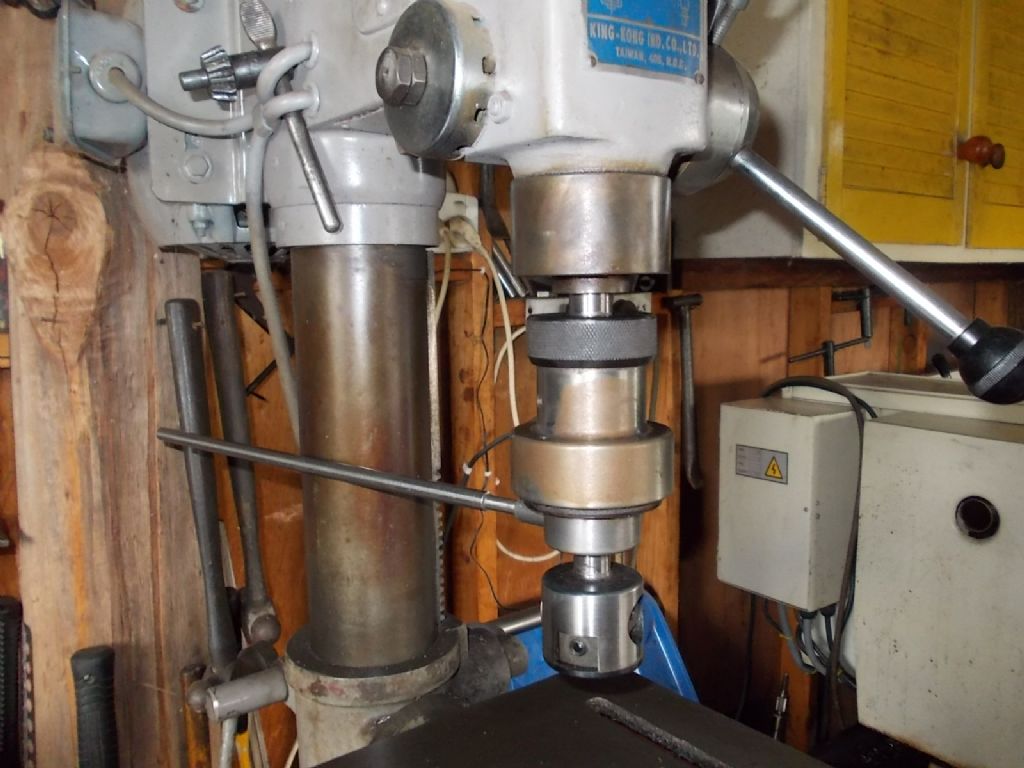

                                  Now getting back to what I was saying before. With small hole taps try and get Gun taps. They only have two flutes and when used for hand tapping you can not beat them. Must use tapping compound for best result.
                                  They are a little bit more expensive but its worth it.
                                  These taps are intended for use in tapping heads used in a drill press.
                                  Larry
                                  #176931
                                  Larry Coleman 1
                                    @larrycoleman1
                                    The attached picture is a tapping head for a drill press. All the taps used in them were gun taps.

                                                Gun taps are known as spiral point taps in the UK. They are intended for thin or open holes and the swarf is ejected forwards, unlike a spiral tap which is better for blind holes and generates swarf that comes back towards the chuck.
