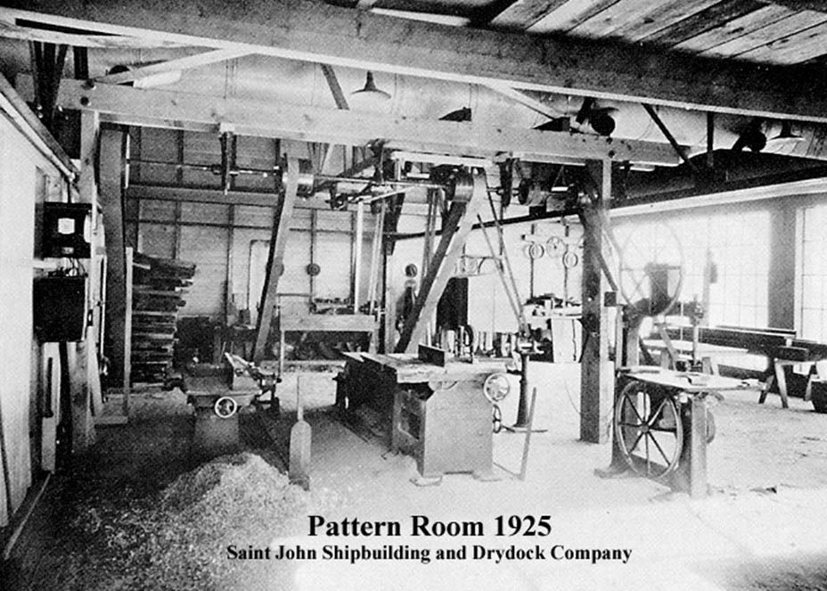

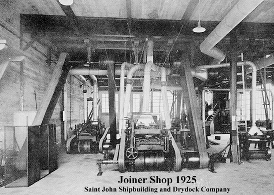

                  Posted by Larry Coleman 1 on 10/01/2015 09:35:46:
                  That is an excelent link and I liked the tree lathe. Thanks Ed !
                  I remember operating a lathe driven from a line shaft with flat leather belts. It was a WH&S nightmare but it worked well. On the fine cuts you jammed a bit of wood against the spindle to reduce the slop in the bronze bearing.
                  Larry
                  Here are a couple of examples of belt driven machinery. During my working life, I used these photos in one the courses that I instructed on machine guarding. Of particular note is the absence of a guard on the large band saw. Oddly enough, there was very little difference in the rate of serious accidents (those which result in injury and lost time for the employee) during this era and the rate of serious accidents in the present day. However, it is important to note that in those days, even in unionized shops, if you ignored a trade standard or supervisor's instruction you would most likely be escorted to the gate. One of my favorite sayings when teaching H&S was: "Nothing is foolproof because fools are so ingenious at bypassing safety systems and standards." Another favorite was: "The person in your shop most responsible and accountable for protecting your health and safety is YOU!"
                  Bill

                            “Bill Hancox”
                              @billhancox
                              Posted by Larry Coleman 1 on 11/01/2015 03:56:37:
                              Bill
                              What drove the line shafts, steam engine or diesel.
                              Larry
                              At the time, they were driven by coal fired steam. This yard is still in business but of course now fully modernized. In 1925 they built everything from wooden schooners and ketches to riveted freighters. As a young boy of 4 or 5, my father was stationed at a nearby army post. We lived right across the road from the drydock. In the summer, I spent many an hour at the fence on a bluff looking down at the various operations. Talk about steam. It was everywhere.Steam engines shunting material and cargo; steam powered cranes and derricks lifting and moving things. I also remember watching with fascination the old steam powered dredge that they used to keep the channels open. It was moved about by an ancient steam powered tugboat. In those days (early 50s) there were no two way radios in use. It seemed as though all communication was by various steam whistle signals. Thrilling sights and sounds for a young lad. In those days ship designs on paper meant little to people who were in the shipping business. The blueprints did not give them a clear enough picture of the lines and overall look of the boat. Hence the model shop, where they made scale models for the owner's approval. I wonder what ever happened to those models.
                              Bill
