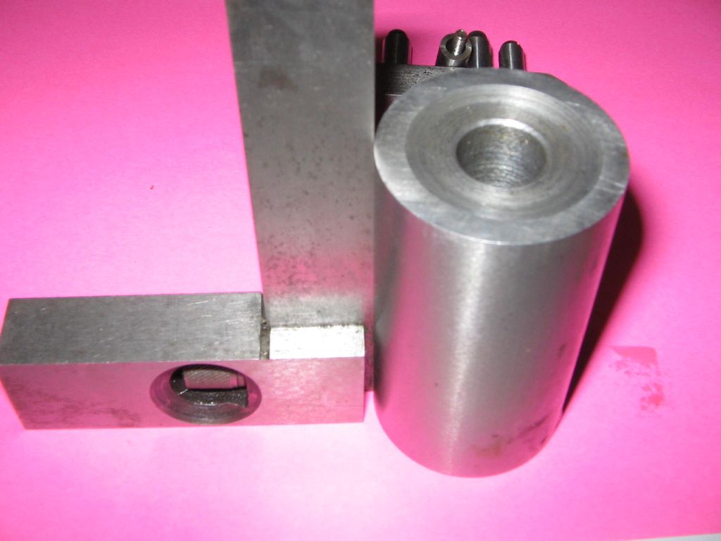

                                        Now lets get on to cylinder squares.
                                        Now from time to time you will have to check if your square is correct. So you put square on to another square and it shows an error so which one do you believe is right.
                                        The best way is to make a cylinder square if you look at the picture basically its a cylinder but it must have two requirements.
                                        The cylinder must be parallel within tenths.
                                        The dia and the ends must be machined in one setting.
                                        If both parameters are carried out it will stand perfectly square.
                                        Simple and effective.
                                        Larry
                                        #175445
                                        Larry Coleman 1
                                          @larrycoleman1
                                          The cylinder square
