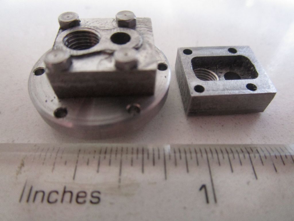

      A little more progress on the 1896 Ford Quadricycle. The picture shows a cylinder cover with the cylinder head attached and the other picture is of the inside of the other cylinder head.
      The bolts are 10BA!
      The larger screwed hole is for an exhaust pipe and the other hole needs a valve guide, valve with 2 locknuts and a conical spring to complete.

          Looking great. I didn't realise how small the cycle engine is I thought it bigger than that.
          David
          #527936
          Brian H
            @brianh50089
            Thanks David, it's not quite watchmaking but it is clockmaking and yes, I didn't realise how small things would be. I picked quarter scale because I though it would make a reasonably sized model.
