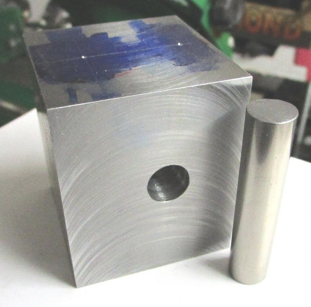

                                        John Baron
                                          @johnbaron31275
                                          Hi Guys,
                                          this picture is intended to show a fly cut surface with a HSS cutter at 250 rpm and 0.5 mm DOC on EN1.
                                          The actual work piece is a part for my grinding spindle support assembly.
                                          The pin standing next to the block will be a split collet that fits into the hole and clamps against a 20 mm post.
