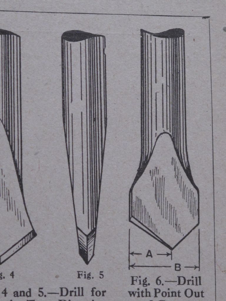

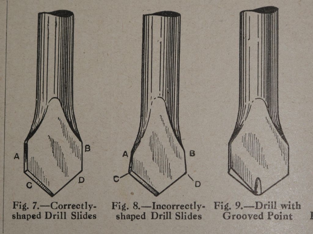

                        spade 3.jpgspade 1.jpg The point I was trying to make regarding the unsuitability of files to make spade drills, has nothing to do with annealing the file before attempting the manufacture. The file, with its thin and wide section is completely wrong for this application, because as soon as the drill started to bite into metal the torque would snap it like a carrot.
                        Back in the day spade drills were forged from round carbon steel bar, so giving them the molecular structure needed to withstand the torque pressures and providing a round shank with which to hold it in the drill.
                        The photo's are from an old workshop text book I have in my collection, which also goes to underline my point about missing digets.
