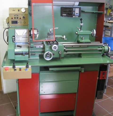

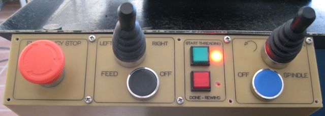

                                    Did the Full Monty on my Maximat V10 – About to do it on my brand new EMCOMAT 14D.
                                    I have posted pics of the full ELS/Autofeed conversion on the V10 – have NO idea at all how to link to those posts in this page – one of those website mysteries…
                                    My stepper is mounted as in Bandersnatch's post, on the right side, driving the leadscrew via a toothed belt.
                                    The steppers do not jerk if you use the correct size stepper and driver for the load. Microstepping works very well, on ANY size stepper – does not bring improved accuracy of angular position but does allow smooth acceleration and helps to avoid any mechanical resonance. Problem is that for example, 1/2 step has 1/2 the holding torque of full step so size the motor accordingly.
                                    A Berkshire fellow has implemented my design fully as well – he may do a post soon…
                                    There are many pics in my album on the stuff. None are really a DIY recipe, but give some idea.
                                    My implementation does full autofeed variable from 0.05mm/sec to 10mm/sec and cuts any thread from 0.1mm to 7mm pitch in 0.1mm increments, and 5TPI to 60TPI in 0.1 increments. Stops tool automatically at the end of thread as well!
                                    I recommend trying to implement something based on a stepper -NO more gears and changing gears and thinking about ratios, and noise..
                                    Implementations using wiper motors or the like can work for autofeed, but really need motor speed feedback to control the speed properly. Open loop speed implementation notoriously give varying feed speeds during the cut, depending on the cutting loads, carriage friction on the bed at different carriage positions, and so on.
                                    If the stepper size and stepper driver are chosen well, there are no missed steps, no changes in feed speed, and it works well.
                                    If only autofeed is desired, a simple variable pulse generator ( NE555 type for example – Easily found on Banggood, etc) and direction toggle switch can feed the stepper driver connected to the stepper.
                                    Joe
