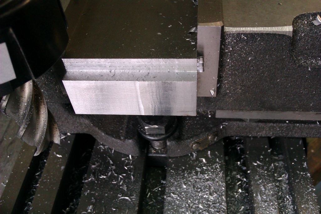

      Anyway while waiting for some paint to dry I thought I would try out a few cuts based on Andrews calcs above, in the past we have had a difference of oppinion on cutting rates for the hobby machineswink 2
      Constants
      X3 mill with 600w motor, slow speed range 100-1000rpm, 16mm 4 flute cutter (high quality Richon brand for £2!! ) 110mm spindle to end of cutter. X and Z axis locked. 10tpi leqadscrew.
      Cut No 1 ( two cuts infact)
      2mm Depth, 6mm width, 750ish rpm. You can hear a slight chatter and looking back at teh viodeo my feed rate looks less than the suggested 6"/min but a reasonable cut and the machine was not complaining.
      Cut No 2
      2mm depth, 6mm width, 500rpm
      I don't have a readout for speed on the mill so thought it would be worth checking the speed so used the lazer tacho and a bit of tape on the collet chuck to set the speed. To be fair my 750rpm on the first test was at "half knob" but the tacho showed I'm actually getting just under 1300rpm in the low range not 1000. Can't hear the chatter this time and wa sprobably able to feed a bit faster.
      Cut No 3
      0.6mm depth, 19mm width, 500rpm
      To replicate more what Jamie was doing I took a full width cut across the now 19mm end, to keep the amount of metal removed the same as above the depth was reduced to 0.6mm, width 19mm. You can hear it start to chatter as I tried out teh feed, a slight reduction stopped that.
      To be be continued
      Edited By JasonB on 26/05/2014 14:07:26

        The finish from cut No3 showed some vertical ripples so I did what I would usually do and took a skim to finish – 0.05mm depth, 19mm width 750rpm. I stopped this cut half way across to compare finishes.
        So in conclusing Andrews suggested figures should work on Jamies machine and they are not that different to what I would actually use with my feel and sound approach. But if taking a full width cut he may want to run a skim cut to finish. I would also normally use a bit of soluable oil as well but not enough hands on this occasion.
        This does seem to back up what most people have said and that its the set-up that is at fault not the machine.

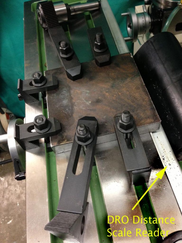

              Thanks for all the feed back. I am a little overwhelmed at the amount of info that has come back… THANKS TO EVERYONE FOR YOUR TIME AND ADVICE
              So where am I…
              A kind local with some experience popped around… He felt that the work was secure enough in the vice.
              Yes the collet was an issue and it was not fully located at the front of the nut… That aspect is now sorted.
              Ensured that the cutter was fully seated in the collet
              Tried milling as suggested from the other direction… Works a little better…
              Milling speed reduced and tried various speeds…. 300rpm, 400rpm 500rpm.
              The collect nut did have a habit of coming loose
              Everything has had a supper tightening down… still shaking the collet nut free….
              Feed rate is slow, Still not covering the full width of the piece.. The cut being applied is 1500th…
              I am still a little disappointed with the progress…
              It was then suggested that it might be better having the head milling from above and trying a slot drill… Re set up the head and adjusted the big vice to run so that the work piece will run along the the bed (LtoR) instead of front to back.
              This uses different vice clamp points and it was obvious at the vice was far less stable set up this way.
              So I have removed the vice all together with a view to clamp the work piece flat and directly to the bed. (So it will no longer be upright)
              This has given me a new set of problems..
              The work piece is as wide as the bed… So This rules out cutting front to back… Tried setting the work piece up so it would over hang the front of the bed… But I can't get the bed back far enough (DRO measuring device on the back)
              So this leaves me setting up the work piece so that I will have it overhanging the rear of the bed. I have very little space to play with before the cutter will make contact with the DRO measuring device. So I can't afford for the cutter to get pulled out of the collet anymore.
              The answer would be to raise the work piece up off the bed with a spacing work block… But I don't have one… And I was concerned that this would be less secure.
              At this stage I was a little frustrated with the project and thought it best to have a break from it. I also needed to look at some YouTube advice on clamping…
              As it was a very rare case in Wales of being a dry day and the sun was out. I then went for a short ride on my motorbike to the dams….. That lasted the whole afternoon..
              So I will look at clamping the work piece down on to the bed tomorrow night and see how that goes ….

                  I have been feeding at a slower pace than that (1/4 to a third) and a much shallower cut (1-2000th)
                  Here is a picture of the collet that you have asked for along with the cutter beside it. This is the clamping setup I am looking to use… I will try and get some thin packing for the underside of my work piece.
                  I still feel that the clamps won't be strong enough with out something solid to butt the work piece against to give it some more support.
                  What's your thoughts
                  Jamie

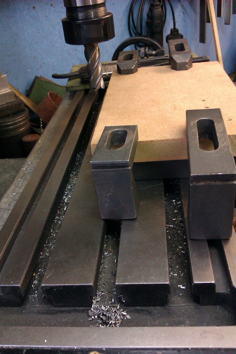

                    I'm sorry to say that holding a piece of plate in a vice sticking up in the air as you had it could in no way be considered OK, you are simply asking for trouble, get it bolted down onto the bed preferably onto parallels or failing that pieces of scrap, I would probably use 1/4 plate or similar, then at least you are giving your machine half a chance, with the proper setup it should be a relatively easy job, and will give you confidence, a milling machine without some decent clamping kit, is pointless, a bit like a motorbike without tyres.
                    Shaun
                    Seen the pictures after my post this looks much better, I would ditch the front two, the four on the ends are enough, then move the plate towards the front and sit it on packing and you should be good to go.
                    Edited By Involute Curve on 26/05/2014 23:49:50
                    #153657
                    John Stevenson 1
                      @johnstevenson1
                      Those 4 short clamps will be OK in the position they are in.
                      Then use the 2 long clamps as packing.
                      #153666
                        Jamie, the suggestion to hang the work over the front of the table is so you can machine the back of it, something like this with the cutter on the side that is away from you. Should put the cutter over the table. Probably best to add some studs and nuts thoughsmile o
                        Are you locking the spindle or using a second spanner when tightening teh collet or just using your hand on the collet chuck body? The very shallow cut may also be allowing the tool to rub and vibrate. Can you also say what it is 1/1500 of as thats not a usual measurement, what is the DRO saying. Could it be you are taking a 0.015" ( fifteen thou) cut?

                          I am also a bit confused on what depth of cut you are using? I would also agree that a very small depth of cut combined with a slow feedrate will almost certainly mean that the cutter is rubbing rather than cutting cleanly.
                          I am not familiar with the speed ranges on your mill, but if it is possible to get a speed of around 500rpm on the low range that is what I would use as it means there will be more power available at the cutter.
                          I would probably only use two clamps to hold the work down, but with the proviso that I have a bigger mill with bigger T-slots, so the clamps can be tightened rather more. It is good that you have studs and nuts close to the work, as they should be. thumbs up I don't know how accurately your T-slots are machined, but I often use a length of gauge plate in my T-slots to act as a location for workpieces. That has two advantages; it locates the work parallel to the table, and it resists the work being forced back. The setups illustrated by Jason, and the use of a couple of clamps as packing suggested by John should work fine, and is how I would tackle the job.
                          From your picture the collet now seems to be correctly inserted into the nut, it's not obvious the first time round! I note that the collet is 22-19mm? That seems a very wide range, ER collets usually only span 1mm, or less. If the shank of the endmill is 20mm ideally you should be using a 20-19mm collet.

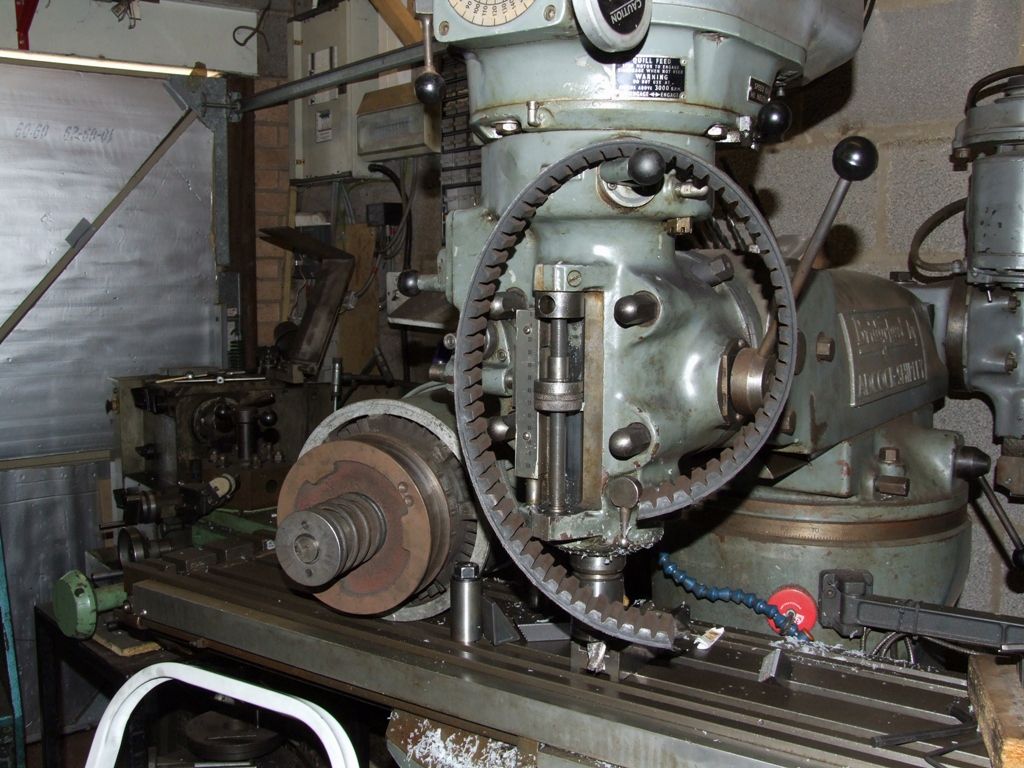

                                Hi Jamie
                                I can only concur with all the advice previously given, I have the WM 16 (smaller brother to what you have) & I have taken reasonable cuts with it, dependant on material. one thing that I did note was that you state that the cutter kept coming loose. . I wonder if you have got a collet spanner, you must ensure that the collet nut is securely fastened up tight, I hold the spindle with the spanner provided in the set that came with the machine (power off of course) then have the cutter extended out only as far as is necessary for the job, then pull up tight with the collet spanner, really hand tight, not hammered! there will be enough grip in the collet to prevent any movement of the cutter, if you haven't got a collet spanner there are plenty available on the tool suppliers sites or flea bay for as little as a fiver, or make one.
                                When I got my machine I trammed it in vertically & locked it up permanently with a couple of head locking blocks, so for the angles I needed to machine I use an angle vice or set up in my main vice, both set ups checked with digital angle gauge. I have no intention of moving my machine head from the vertical in the foreseeable future, before starting any cuts I ask myself.. is everything locked.. is all as rigid as it could be, after all these are only hobby machines not industrial grade but are quite good enough for what we 'hobbyists' need, happy milling thumbs up
                                George.
                                p.s. Have you considered MT3 indexible tip cutters? I have a 19 mm 2 tip & a 50 mm 4 tip that I use if I want to rip off any heavy cuts.I hope this hasn't come across as patronising, it is certainly not intended to be, just constructive commenting.

                                                Jamie Jones
                                                  @jamiejones42723
                                                  image.jpgMetal swapped new block on the mill's bed. Mill head upright with with work clamped flat.
                                                  I have set up a butting block and five clamps on the work piece. .
                                                  Locked everything down. End mill full in the collect with collet correctly fitted and locked off as tight as I can get it.
                                                  Mill speed 300rpm with the mill driving in low gear.
                                                  Tried 1mm and 0.5 of a mill. Things feel more comfortable…
                                                  BUT… The end mill in still getting pulled out of the collet with the collet becoming loose. I can't tighten the collet any more.
                                                  any advice is welcome as to how I can get around this:
                                                  set up below
                                                  #153994
                                                  Bob Brown 1
                                                    @bobbrown1
                                                    May be a silly question is it the correct size collet? From the picture it looks like the collet is one too big.
                                                    Worth checking the shank diameter as some times the shank is a different diameter than the cutter. ER collets are usually 10 to 11, 11 to 12 etc in 1mm steps for larger sizes 0.5mm for sub 7mm. I usual try to use a 12 to 11 for a 12mm shank cutter and not had a problem with them in mill or lathe.
                                                    #153996
                                                    Jamie Jones
                                                      @jamiejones42723
                                                      Won't fit in the next size down……
