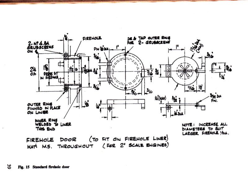

      Hi, Some help please. The traction engine i'm building (D & NY in 2in scale) dose not have any drawings for the fire door. I was wondering if anybody can send me some dimensions etc. I know I could work some thing out myself, but things like the vent holes in the door would be a guess.

            Garry, This is John Hainings standard 2" scale fire door as fitted to D&NY hope it helps.

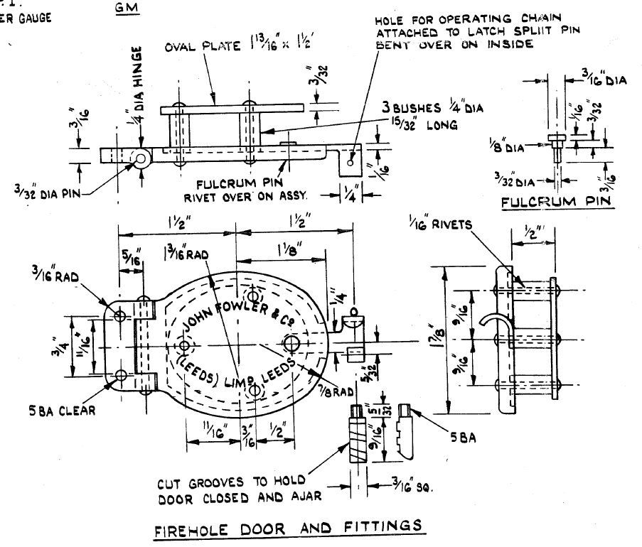

              And a Fowler one in 2"
              #422656
              Garry Coles
                @garrycoles69390
                Thanks for the replies. And thanks MichaelR I will use this one. And thanks JasonB, but my fire hole is round not oval.
