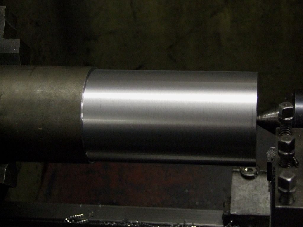

              This is EN1A, so rather easier than EN3B. It was machined at 370rpm and 0.15mm/rev; stock OD is 3":
              The short curled swarf can just be seen bottom left.

                                        On the issue of sfpm it is true that carbide can be used at much higher speeds than HSS. However, it is not always essential in order to get a good finish. It depends upon the material, and to some extent the shape of the insert. Neither it is true that you can't take small DOCs with carbide and retain a good finish. Again it depends upon the material and insert.
                                        For external turning I don't normally bother to take finishing cuts; if I put on a 20 thou cut I expect the lathe to take 20 thou off. Of course there's a caveat for that when involving slender workpieces and boring bars.
                                        As an example for the 3" diameter bar shown a few posts ago the final cut was 20 thou and it's within 3 tenths of a thou of size.

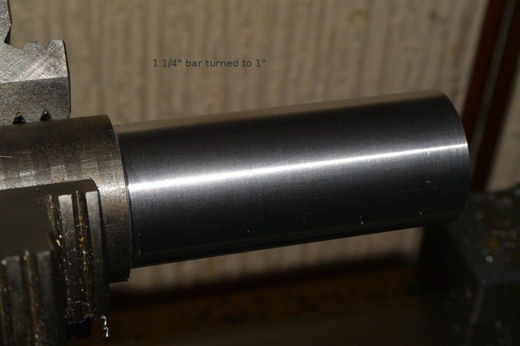

                                          The depth of cut aspect is interesting. I posted a shot of some moderately nice shiny MS turning around 1" dia. Depth of cut was around 1mm, 2mm off the dia Using a TCGT11 finishing tip. This is it.
                                          I have a lot sticking out of the chuck really and tried a circa 3mm deep cut – just wouldn't have it. Loads of vibration. Swarf length was about 4" running at about 4 – 500 rpm on a mini lathe. The scratches from it can be just seen on the work. The feed was 0.085mm / rev. Normally I would have speeded that up a bit ot improve the finish but a pain to do on a mini lathe.
                                          Finishing tips should reduce the depth of cut requirements of the larger tips before they start breaking the chips.
                                          What I haven't done is increased the speed to see if that has the same effect as increasing feed rate usually does when the finish is as above.
                                          Maybe I should add that the chuck marks aren't down to the work slipping – down to me rotating it as I close the jaws up. I like things to run as true as they can.
