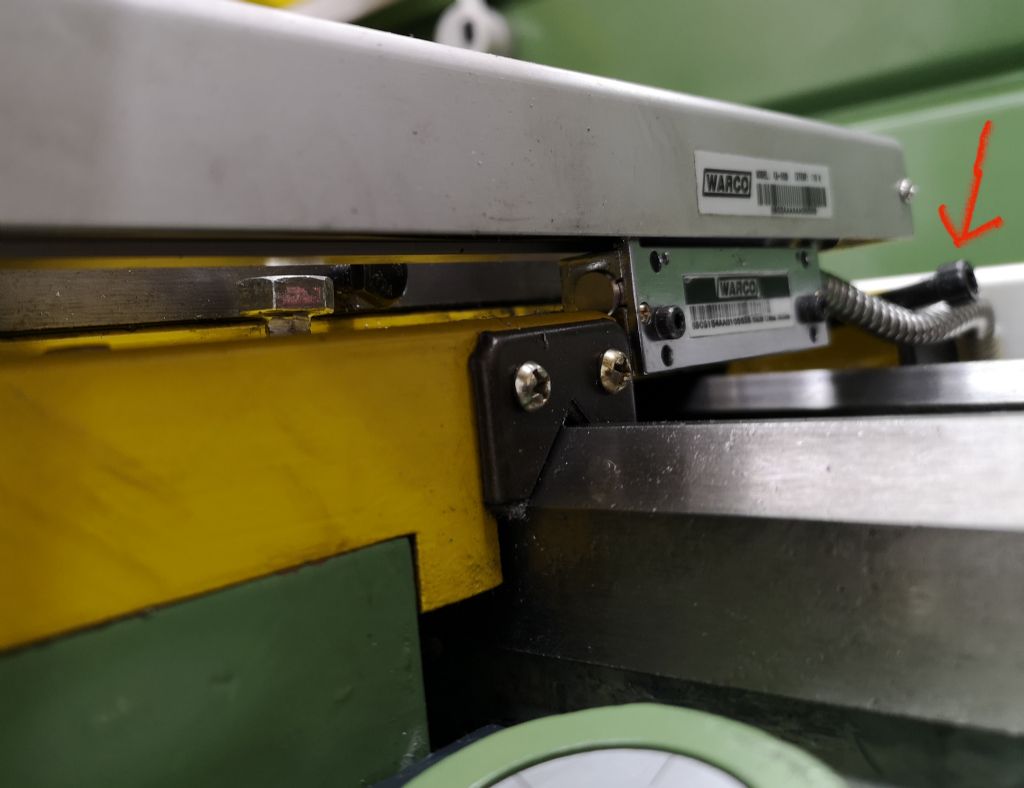

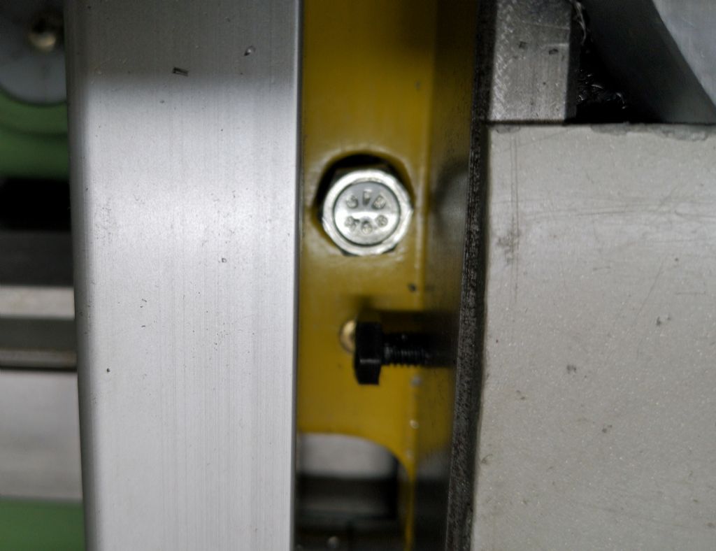

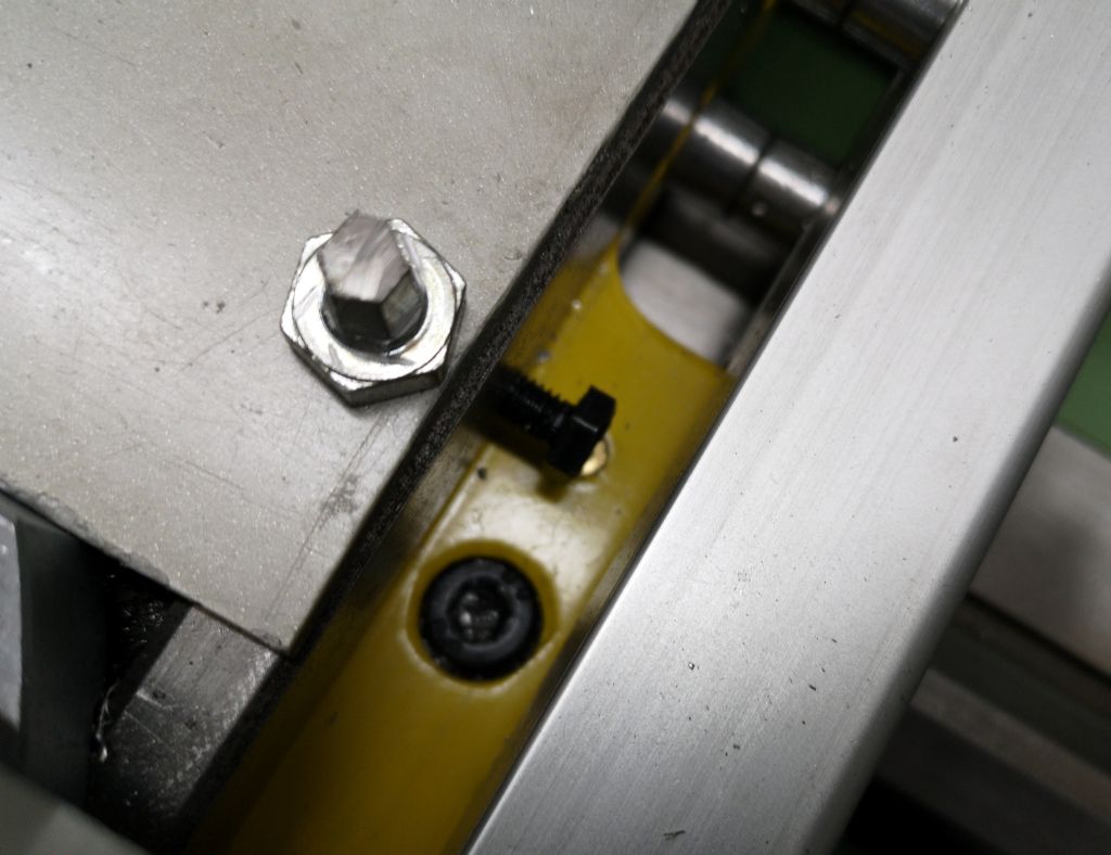

                                    I haven't made a great deal of use of my Warco 290V lathe since I got it last November and thought it was about time I tried milling something. Having read this thread and a good many others I came down on the side of locking the cross slide but the lock screws for both slides are hemmed in by the cross slide itself (depending upon its position) and the DRO gubbins. With only a 9mm gap under the DRO scale I was going to weld up a very short hex bar but as I was in a hurry to take advantage of the 5 degrees outside today (Tyneside) I figured a quicker route. Took me five minutes with the grinder to knock up a gender changer as in the pics.
                                    it's a bit rough and ready but a lovely tight fit. May make a mk2 shortly.
                                    here it is in place on top of the original hex bolt
                                    and it works, so all ok for today at least.
                                    HOWEVER while I'm here could any of you good folk tell me what the screw indicated by the red arrow in this pic does please?
                                    #437418
                                    Tony Pratt 1
                                      @tonypratt1
                                      The arrowed screw stops the tailstock smacking into the DRO scale.
                                      Tony
