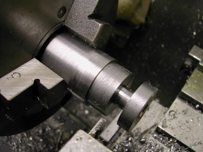

              Here are a few pics from the Racer build which though seen before by most may help you and someone else too at this point in time
              Most of mine are made from steel but that is not
              critical. They are all expanded by a normal cap head screw that has had
              the head turned a 60degree taper to match a centre drill Rough the
              mandrel to with .5mm and drill and tap and centre deeply. using a
              parting tool relieve a portion at the front of the mandrel.
              Remove from the chuck and make two or more cuts with a hacksaw down into the main part. Deburr then return to the lathe
              and screw the caphead in until it just nips then turn the od to a
              finished size to suit your bore. I’m sure you will find it quite
              surprising just how little torque you require on the screw to hold the part firmly for turning.
              These are great little aids, very quick and easy to make and work extremely well.
              Hope this helps
              Regards – Ramon

                  Following Jason’s posting I popped into the workshop and knocked up an 8mm mandrel in about 10minutes using the tapered socket head screw method.
                  I then used it to hold the pair of cranks on which I had to turn a small boss. Worked like a dream.!!
                  I was surprised how little tightening the screw needed before it had a very firm grip.
                  Since then I have read Ramon’s posting and will refine the construction of future mandrels with the deep centre drilled end and the relief in the middle.
