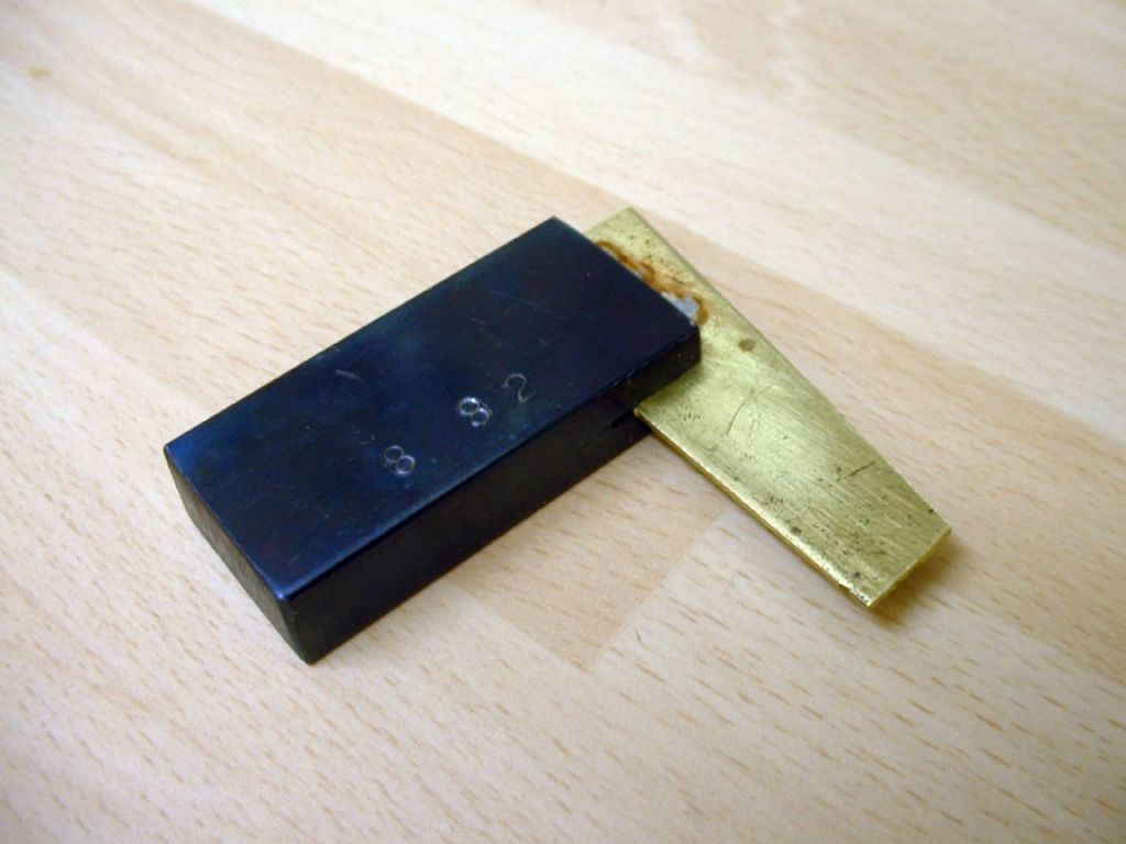

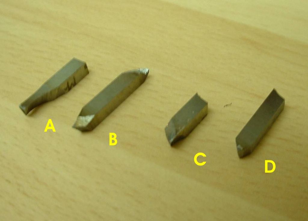

      I don't bother with making the Closing Nut, too complcated, so just buy from Arc EuroTrade.
      Don't blame you. My first time I made a closing nut and it took four specially ground toolbits from 1/8" HSS!
      Next two closing nuts both ball bearing ones – one from Gloucester one from Arc
      Also made an 8/82 degree square especially for setting myu top slide to the taper for both ER sockets and making my own 'emergency' collets.
