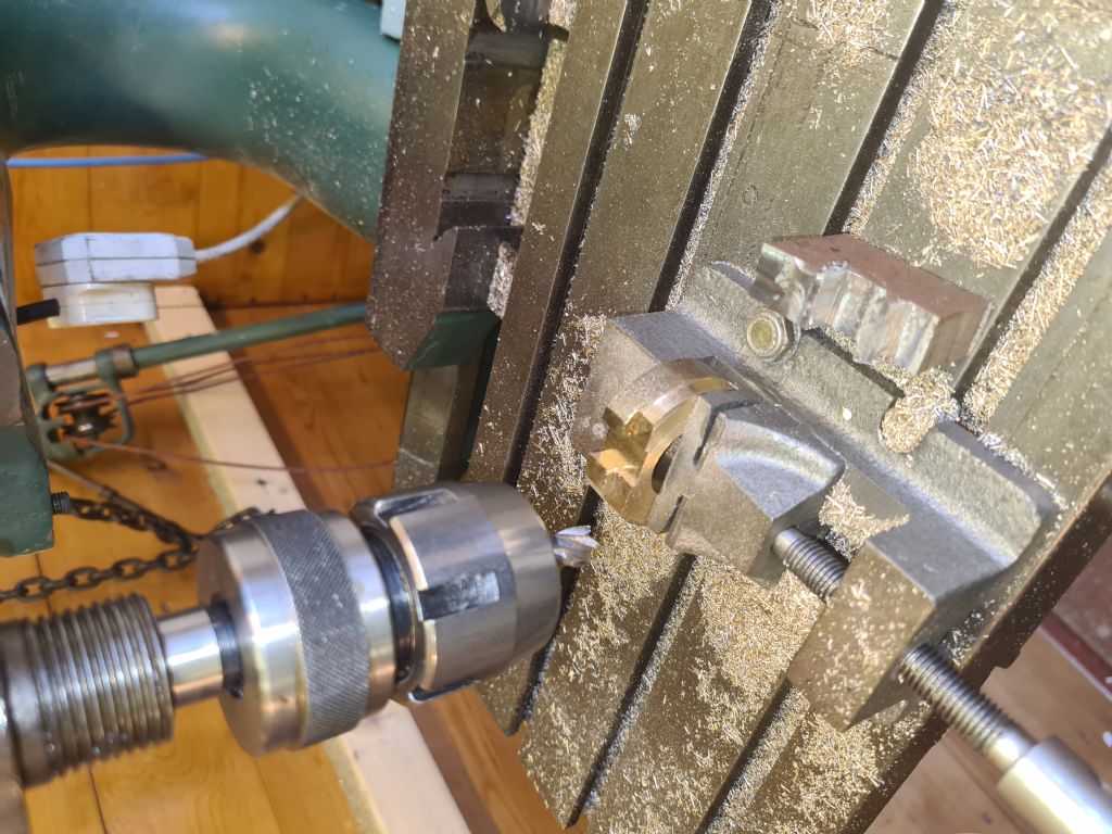

      Proof of the pudding 😁
      Chomps brass quite nicely but complains about a bit of gauge plate!

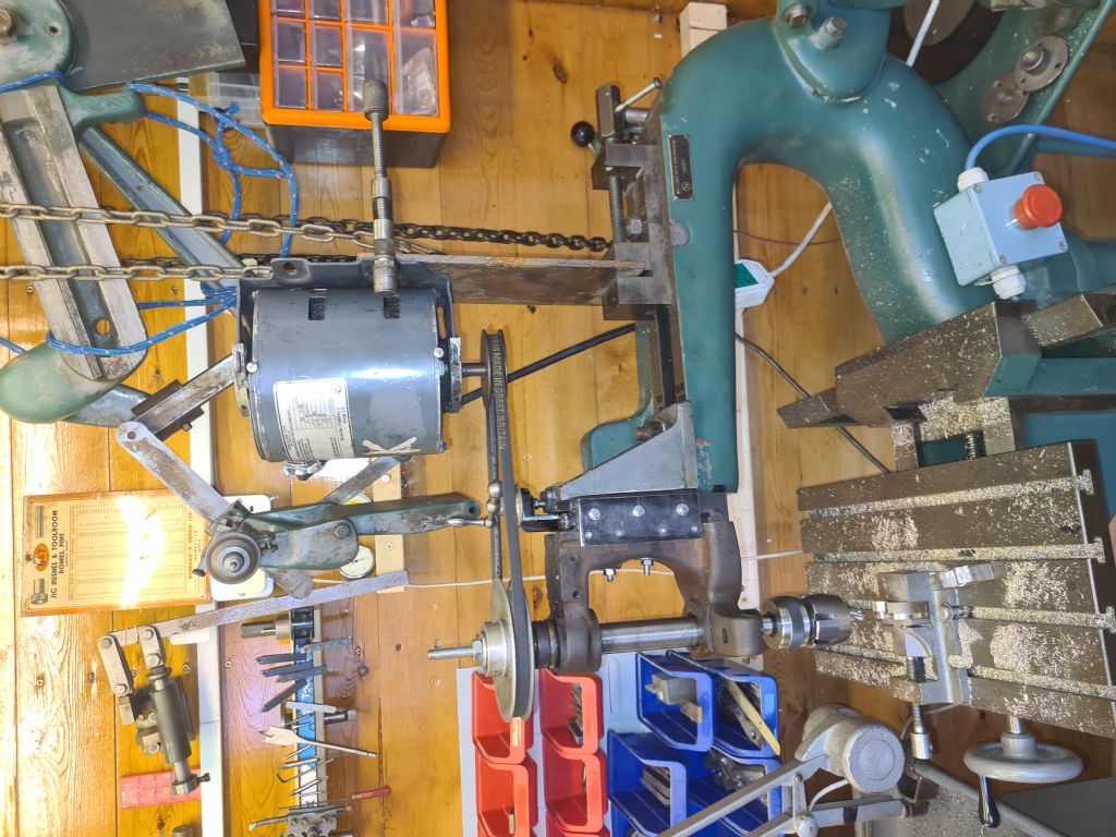

      Next stage is to improve the support mounting & make up a proper motor mount.
      First working prototype.
      Spindle / headstock is mounted on a myford milling slide supported by a fence / register bolted on to the side.
      The motor fixing is a temporary lash up & in the configuration shown gives a spindle speed of approx 780 rpm.
