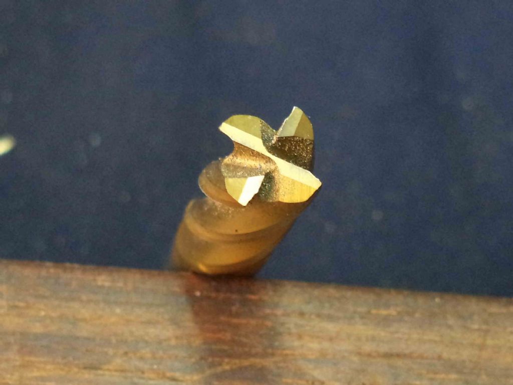

        In the olden days, most of the end mills that I acquired had a centre-hole which enabled easy sharpening of the end-teeth on my Quorn.
        Recent 4 flute end-mills now seem to have a pair of end-teeth that run fully across the diameter, making sharpening as I did it before impossible, without leaving a pip in the centre.
        The only way round that I can think of is to grind that one pair of teeth out of the way with, say, a saucer wheel, thus rather spoiling the cutter.
        Is there a better solution? Or are all end mills now "throw-away".
        Perhaps I should say that I'm referring to cutters of 1/2" dia. or less.

            I think a pair is gashes at 45 degrees to the cutting edges through the centre is the quick and easy solution with a saucer wheel if you have one- the centre portion has virtually no cutting effect anyway… while this may affect the aesthetic of the cutter, does it have a negative effect on the cutting action?
            I find that once 'gashed' the cutter can be touched up several times before needing hashing again..
            #315125
            mechman48
              @mechman48
              How about gashing a gap in the middle with the edge of your saucer wheel? Then you'll still be left with a 4 flute cutter

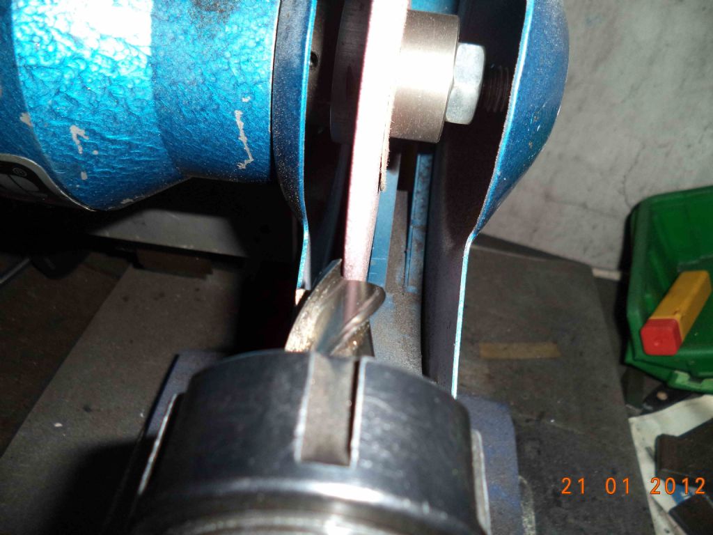

                      To save changing to a saucer wheel on the Quorn you can also produce the gashes with a cut-off wheel in a Dremel.
                      Jon

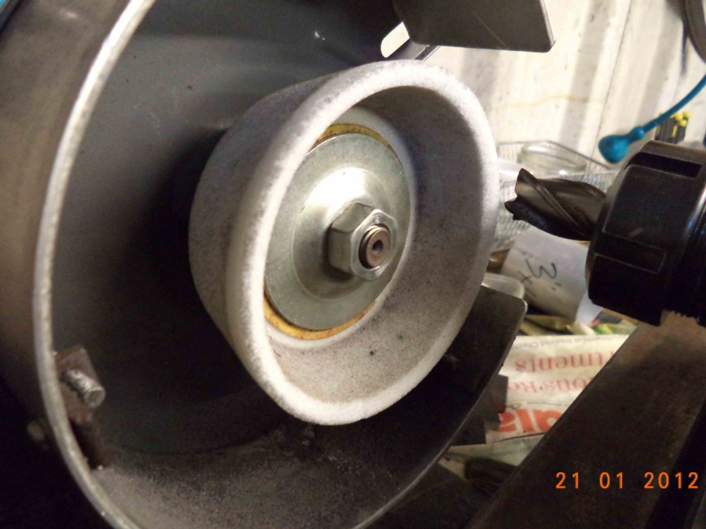

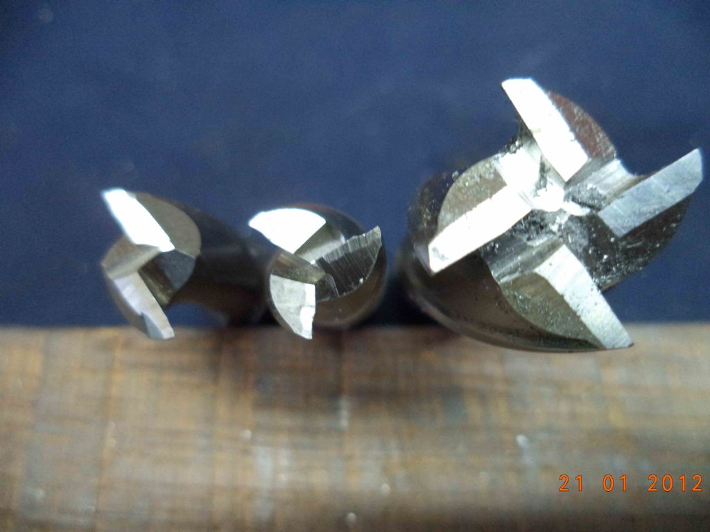

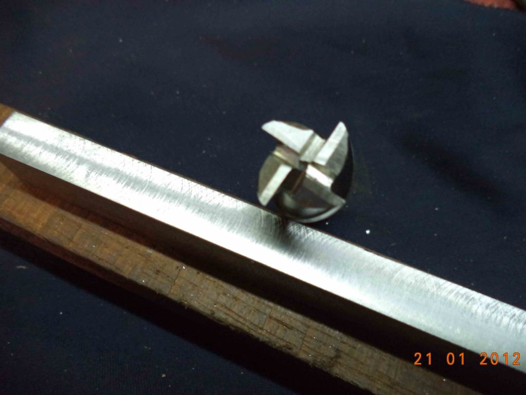

                      #315219
                      Stewart Hart
                        @stewarthart90345
                        Hi

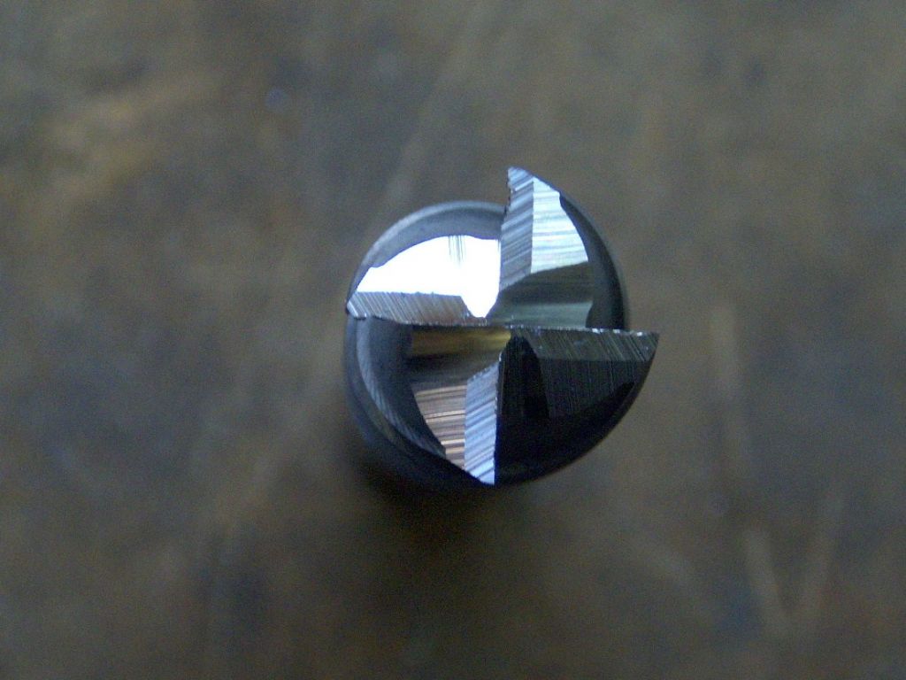

                        Don't get mixed up with slot drills and end mills:- slot drills you can plunge cut and usually have two or three flutes, end mills are for cutting horizontally, the four flute jobs that cut across centre are a bit of a mix between the two personally I wouldn't use them as a slot drill
                        I've reground all these cutters the two on the left are slot drills the four flute on the right is milling cutter, the two slot drill I re-cut the gash with a hand held dremell I gashed the end mill on my home brew cutter grinder you can see I've reground it quite a few times and the original centre hole has gone.
                        This is how I gashed it
                        And sharpended the face
                        And proof of the pudding EN8 milled on my X3
                        Stew

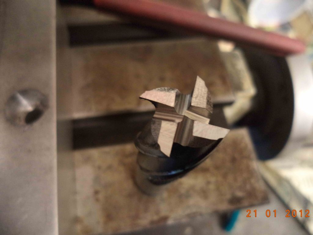

                                    Her's the picture you can see that the cutter has been well used with the edges chipped but you can see the centre cutting configuration.
                                    Stew

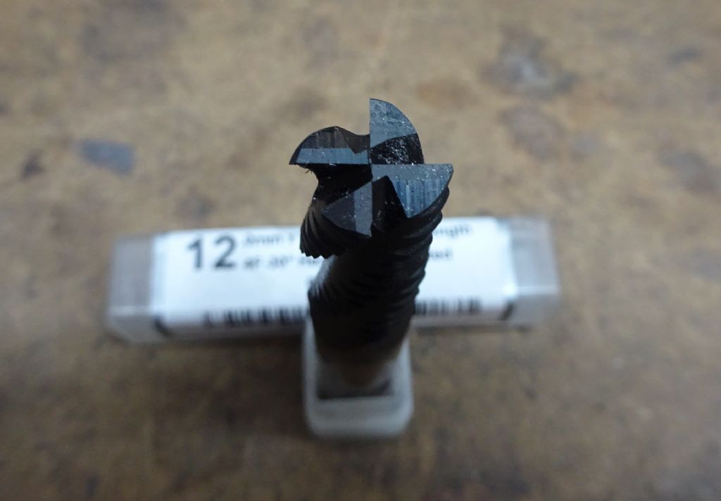

                                        Stew: I'd hazard a guess that the cutter shown is keenly priced far eastern? It's not clear how the edges meet in the centre. This is what I would expect from professional cutters:
                                        Of course, when all is said and done the cutters are intended to cut mostly on the sides, not on the ends.
                                        Andrew

                                          Similar to this Rougher
                                          Rougher
                                          And a not very good photo of a sharpened cutter retaining the two longer end cutting flutes

                                            Thanks for all the interesting comments. My cutters look like the one pictured by Stewart Hart, they could well be "keenly priced far eastern". They're just labelled "Clarkson"
                                            I take aboard the comment that they won't cut well at their centre, so I think that a gash across the middle might be the best way. I haven't got a Dremel, so I might try mounting a 1 mm thick abrasive disc in the Quorn.
                                            I'm sure Prof. Chaddock would have devised a method of restoring the full edge, but the set-up would be a very precise one, so I'll opt for the easy way!

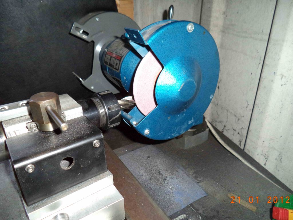

                                                I sharpen those end mills on my Clarkson grinder by holding them in a R8 collet and using a simple index wheel on the back. It works very well indeed.

                                                      The late, and lamented, John Stevenson used to sharpen End Mills and Slot Drills on the EMG12 and EMG 20.
                                                      Does anyone else offer that service now? I lack the courage to try regrinding on my Worden!
