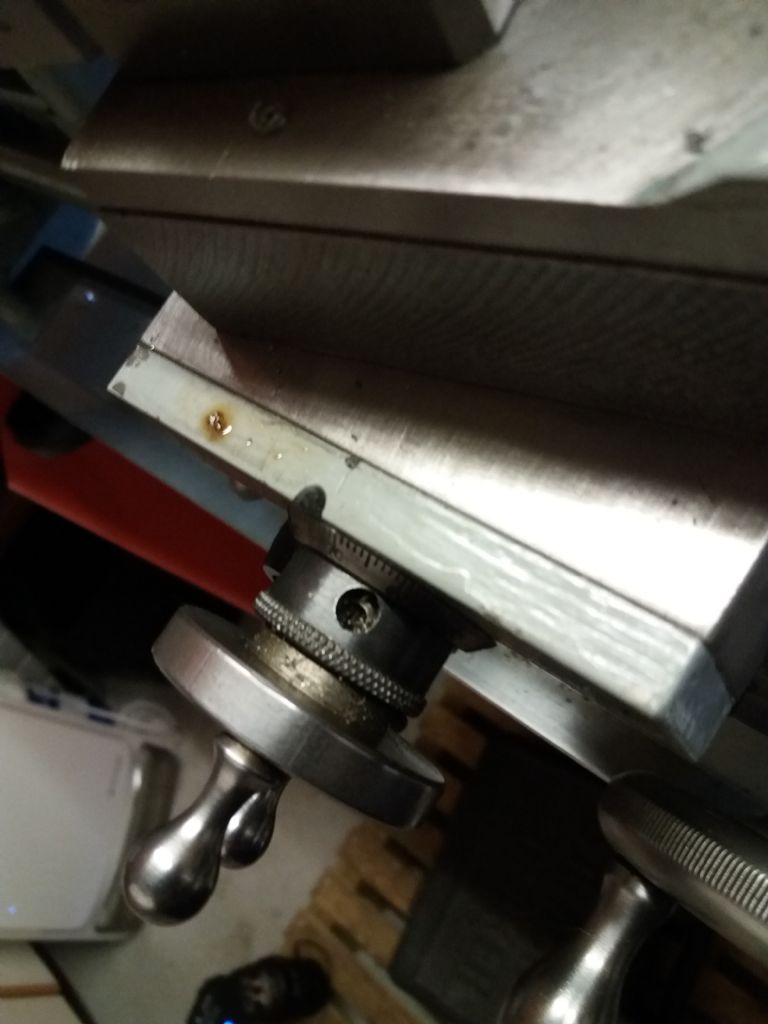

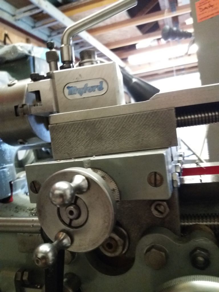

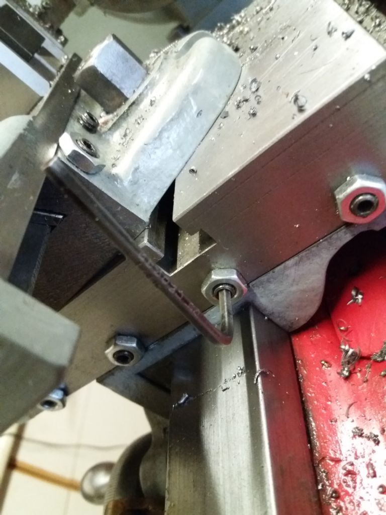

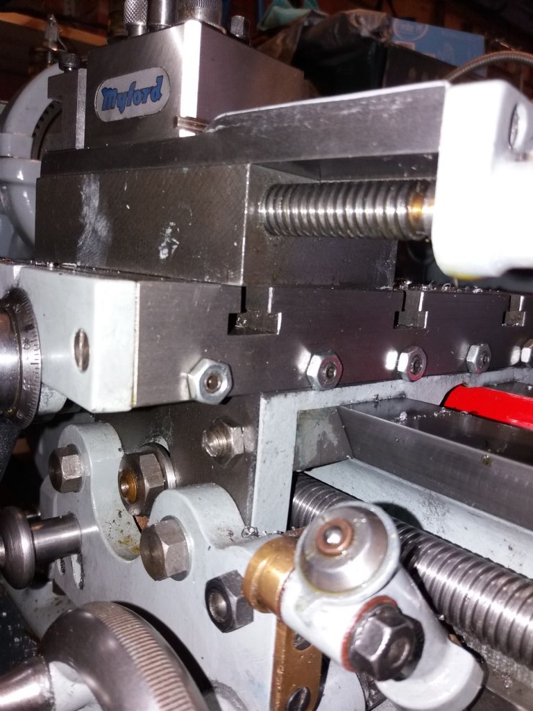

                  Hi Andy. The grub screw adjustment is to remove backlash and not to lock the slide way. If you rotate the micrometer bezel after loosening the outer grub screw you can see through the hole in the bezel another grub screw, lower down, and slightly out of centre. This is slackened to adjust back lash so that rotation is ok but minimum backlash using the outer nut and then retightened and checked again. I adjust the slide gib strips with the handle plate screws out so that you can push and pull the slide as you tighten the screws ( and on mine I have replaced the screws with longer screws and lock nuts) until it just slides smoothly without undue force, and then replace the handle plate screws. I use one of the centre gib screws to lock the slide when I have a big cut to do. The play in any of the slides will cause all sorts of problems and it is usually one of the gibs not adjusted closely of play in the spindle bearings. I suggest that you put a dial test indicator against suspect parts and give them a tweak to see if you can find any play. IE put a shaft into the chuck and check up and sideway play when pulled. Don't forget to adjust the main carriage gib strip.
                  please find attached pictures.
                  David

                          Hi Andy I actually used 1/4 UNC grub screws and lock nuts for the gib adjusters as the original Whitworth wern't available but as they are the same pitch and diameter but a different thread angle were ok. The information on toolpost mods etc are in some of the albums in my area including drawings but if you need further info send a message.
                          David
