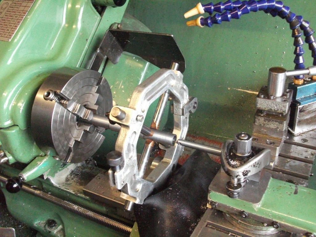

                                #287941
                                John P
                                  @johnp77052
                                  To be able to drill straight and true through shafts this useful publication
                                  from Camden books is worth looking at. "Making rifle barrels",it is about
                                  drilling long straight holes ,some of it is about using gun drilling which would
                                  probably be beyond the capability of most model engineers workshops but
                                  there are sections giving advice on conventional drilling which result in
                                  drilling straight holes.
                                  I have used these methods for some of the examples shown here in the second photo.
                                  The shaft seen here in the lathe is 8 5/8 inches long and drilled through
                                  at 14 mm (.551 in) .Using 2 extended drills a smaller diameter pilot drill
                                  has a bored hole formed to be a close fit at least 5x drill diameter and the hole
                                  drilled at least another 8 to 10 x drill diameter ,the 14 mm drill size is also
                                  bored a close fit and drilled to open the hole leaving at least 5 x depth
                                  of the smaller diameter so the hole depth can be advanced.By changing drills
                                  the hole is drilled right through.As can be seen in the photo a good supply of
                                  neat cutting oil helps by cooling and lubricating and washing the drill and hole
                                  of all swarf ,the drills should be withdrawn often to to clear the swarf and avoid
                                  crowding the flutes.Two similar shafts were made one came out on centre the
                                  other disappointingly was .002 inch off centre but probably within the accuracy
                                  of the 3 jaw chuck. At full depth the hole is only 16 x the drill diameter.Using the
                                  hole as the reference the shafts were re-centred and the finished from there.

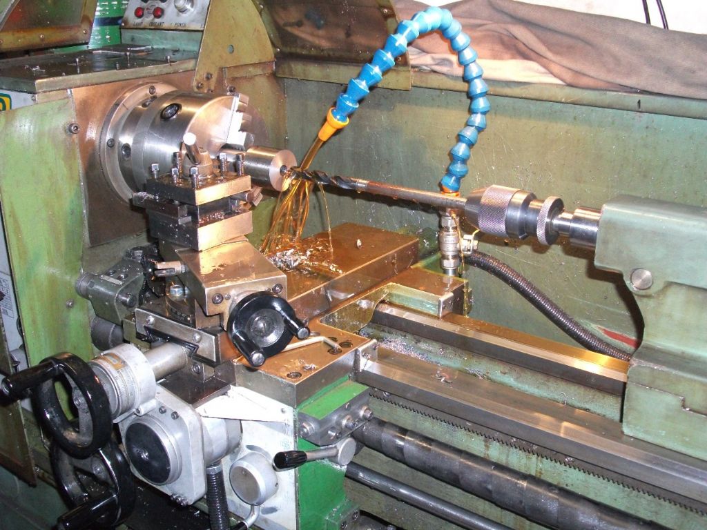

                                  The third photo shows one of 3 internal grinding spindles at 6 5/8 inches long
                                  and drilled through at 7.3mm dia ,the hole depth is 22 x diameter .As can be seen
                                  the shaft is held in the 4 jaw and supported by the fixed steady using a similar
                                  sequence as previously the holes were drilled ,one as before was on true centre
                                  the other .002 inch off ,the photo shows the last part of the sequence the shafts
                                  having been referenced from the hole re-centred and rough turned to true up
                                  to turn the 1 morse taper in the nose as in the photo .
                                  The drills are sharpened as 4 facet drills ensuring the cutting edges are the same
                                  each side.
                                  The moral of the tale is if you start off with true hole the drill will most likely
                                  follow it through.
