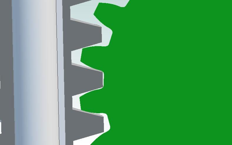

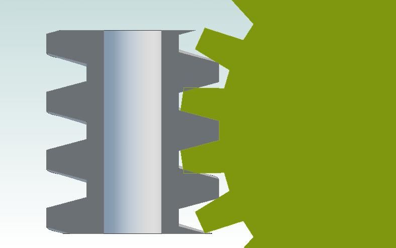

                                      Unless I missing something I just don't see how a worm wheel with straight sided teeth can mate with a Acme form worm? Here's a CAD section through a worm wheel, where the tooth space is a copy of the worm thread form.
                                      The sewction seems to indicate that the worm interferes with the adjacent teeth. Here's a similar thing, but with an involute gear form:
                                      I haven't got the tooth depth correct, but it's a right pain to go back and regenerate the gear, export to DXF, import the DXF, fix the sketch, extrude it and so on. The picture does seem to indicate that the worm does not interfere with the adjacent teeth.
                                      So as far as I can see an 'Acme form' worm wheel doesn't work, unless the teeth are made narrower, or the centre to centre distance is increased? Is that correct?

                                        A worm gear has an involute form – period.
                                        The wheel mark has drawn is know as an enveloping gear in that the teeth run up the sides.
                                        You can also get flat worm where the tooth space is to depth in the centre but doesn't run up the sides.
                                        The difference between them is that the latter is worked out like a normal spur gear where the OD is number of teeth plus 2 divided by the DP
                                        The former is based on calculations where the OD is the number of teeth plus 3 divided by the DP.

                                            Right then, so I decided to do it! I "generated" the form by subtracting a worm form solid body rolling around the pitch circle of the wheel while rotating by the correct angular relationship (IE. 1 worm rev divided into the pitch) and have attached the resulting solid body. You should see that we are all wrong (I think) as the form is only really involute at the mid plane. As Andrew identified, the profile tends to become closer to the rack form at the sides as they approach 90 degrees for a fully enveloped wheel.
                                            Anyway, depending on how many axis Andrew has on his mill (3 aren't enough) he should be able to get close to my solid body and as stated at the beginning, I can draw the thing at whatever precision he wants but the time and complexity go up in step. If you really look, you should also be able to see that I messed up the model on a few cuts and this resulted in 3 of the 10% increments failing – they are the ones that look like bigger steps than the others!

                                            PS. sorry it is not enveloping, it is late and I forgot when I extruded the blank……. also, this is really getting way past basic modelling so don't be put off if you are learning 3D, I know quite a number of pro cad jockeys that would not be able to do this stuff without help.

                                              Actually the flat worm shows it better than the enveloping one.
