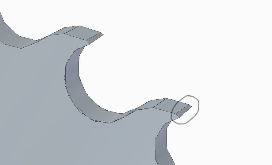

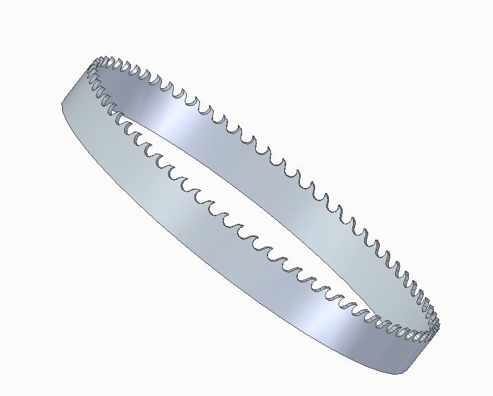

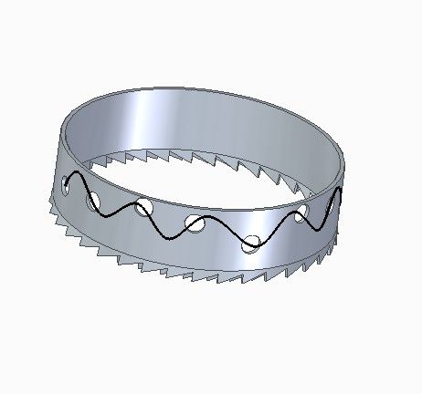

      I learn CAD by tackling ever more difficult objects, mostly successful, but the latest has me stumped. My nemesis is a hole saw:
      First attempt was easy enough, not worrying about the exact scale, below was done by creating a plane tangent to the cylinder, sketching a tooth on the plane, cutting through the cylinder with the sketch, and then replicating the cut with a circular pattern:
      There are three problems!
      First, the teeth don't align properly with the central axis. The error is more obvious on a small diameter hole saw and is caused by a flat sketch being projected parallel on to the curve.
      Second, the teeth need to be alternately bent a couple of degrees in and out to create the kerf. Something like this, but easier to draw and replicate in a circle with properly shaped teeth;
      Thirdly, the teeth in the real saw aren't all the same depth. It can just be seen in the first photo that the teeth nearest and furthest from the camera are deep and those to the side are shallow. Might be a manufacturing error except it looks neatly deliberate.
      I don't know how to model this saw in CAD! I've failed with FreeCAD and Solid Edge in both Part Design and sheet-metal modes. Very grateful for any suggestions please!
      Thanks in anticipation,

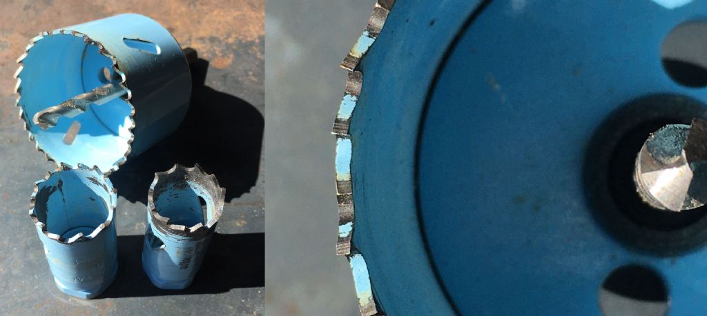

              As for the cutter in the first photo, I have never seen a hole saw like that.
              #611460
              Paul Lousick
                @paullousick59116

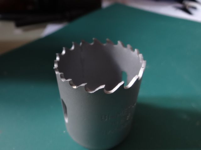

                Hole saws like the one shown are fitted to a spindle and use a twist drill to centre the hole. Available at bigger hardware stores. They can be used on wood and sheet metal.
                Dave, Another feature for you to incorporate is that the teeth ate set to give clearance for the saw. One tooth is bent out and the next tooth bent in. (The final grind appears to be in line with the drill centre)

                  The better makes of holesaw have the variable pitch to reduce chatter and noise, if you look on larger dia saws you can see it quite clearly. Also you get the odd part tooth where the rolled up blade is joined which confirms the teeth are cut then rolled

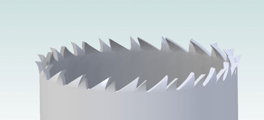

                            Posted by Andrew Johnston on 27/08/2022 22:42:16:
                            Use a loft from the sketch to a point on the rotational axis to create the tooth shape?
                            Andrew
                            PS: In reality I expect the teeth are cut straight during manfacture with no taper
                            This suggestion works, or at least is a considerable improvement. Thanks!

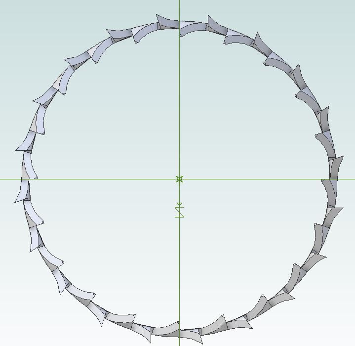

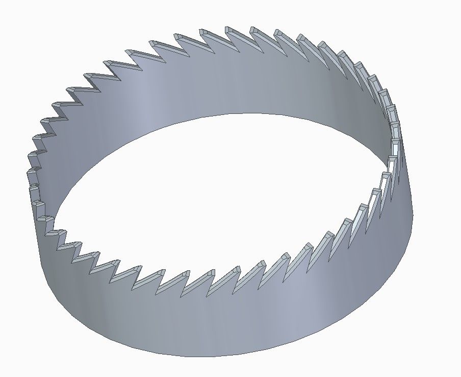

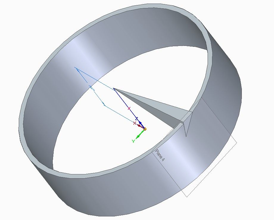

                            Having a busy day so to save time the example is with a V tooth. First picture shows the sketch on it's tangent plane, lofted solid to a point on the axis, to show it's shape (Discovery: Solid Edge won't loft to a line.)
                            The same loft applied as a cut:
                            And the tooth with some chamfering rotated as a pattern cut around the Z axis:
                            Progress, but the tooth relief isn't quite right, and there's no kerf (teeth bent alternately) or variable depthing.
                            Jason suggested the Sheet-metal workbench, which I've tried. As far as I can see FreeCAD and SE don't allow a bend to be applied to a curved strip. It is possible to kerf the teeth on a straight strip, but I can't find a way of bending a straight strip into a circle.
                            Normally I find it easier to 3D-model in CAD than to make the real thing. This seems to be an exception: bending strip metal into a circle and kerfing saw-teeth is easy in real life!
                            Back to the drawing board!

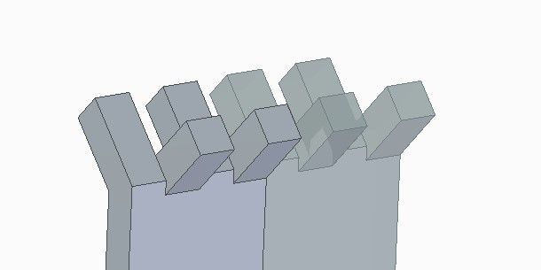

                                Can you select a set of points which form the profile of a tooth and move/rotate the those points in or out of the arc of the blade face?
                                #611571
                                  Needs a bit more work getting the inner and outer teeth the same size but basically what I said in the previous post using Boolean unite to make the flaired out tube and ring of flaired in teeth into one unit
                                  Edited By JasonB on 28/08/2022 18:56:27

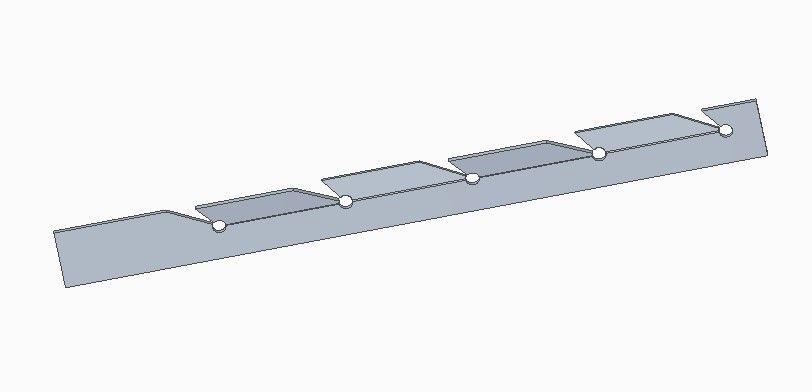

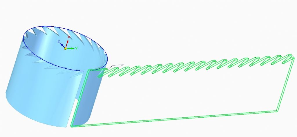

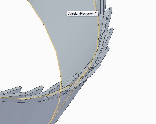

                                    SolidEdge Sheetmetal achieved this on a straight blade:
                                    Hard work though because the teeth have to be bent one at a time – takes forever. Also the round holes are essential to relieve the bends: seems SoildEdge won't apply bends that break the rules!
                                    A quick try with Ed's suggestion didn't work in Solid Edge (Sheetmetal) and I'll try in Part mode later.
                                    I like Jason's trumpet idea, pretty sure SE can do the same and will try after I've eaten.

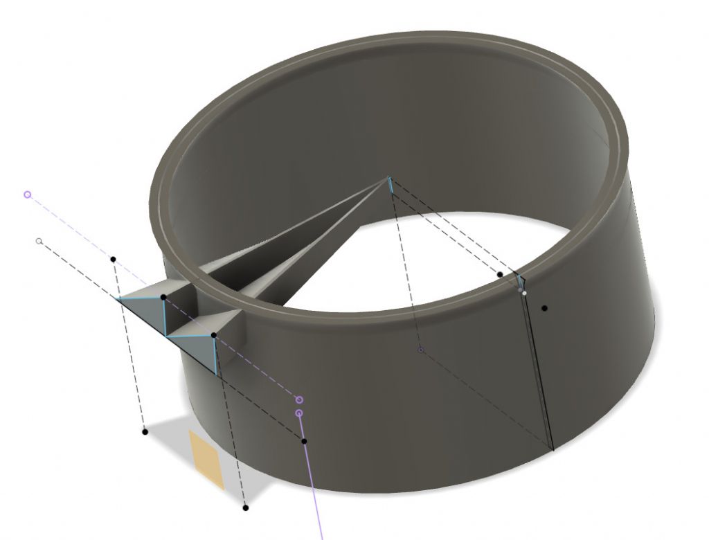

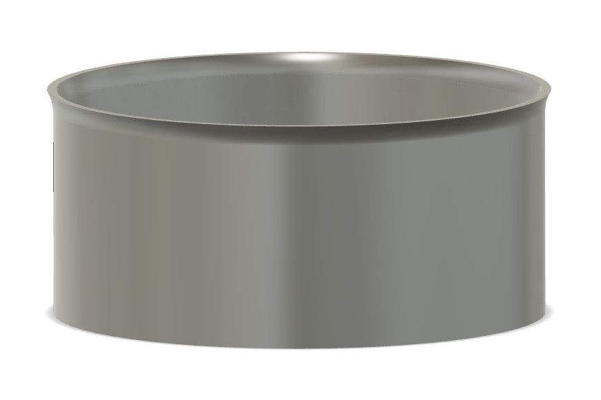

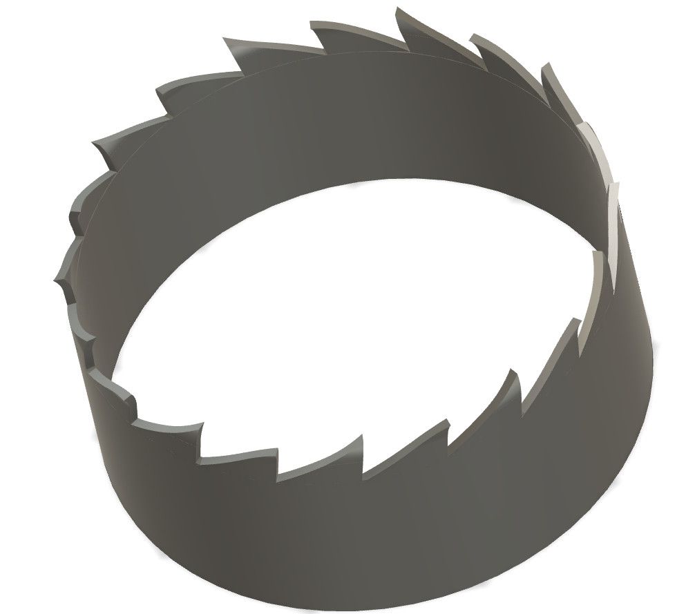

                                      Here's my effort in Fusion.
                                      #611669
                                        This my first attempt at Jason's Trumpet method, proof of concept, with no attempt at getting the tooth details right. However it works, and is quick!
                                        I'm impressed by Gary's Fusion360 version. How was it done?
                                        Ta
                                        #611696
                                        Gary Wooding
                                          @garywooding25363

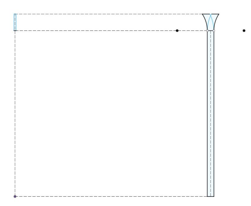

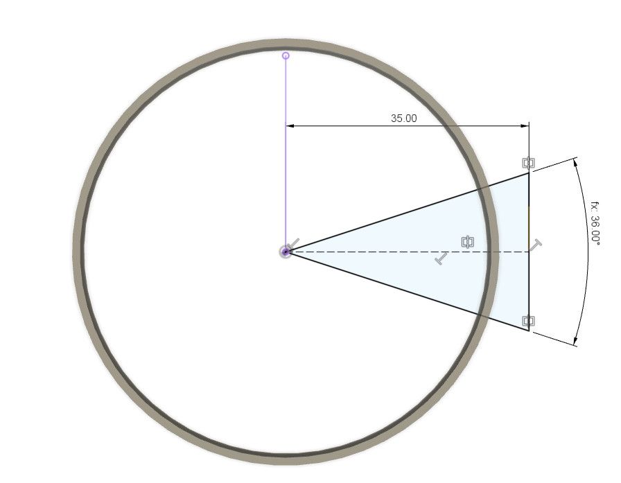

                                          I first created sketch of two versions of the profile of the blade; one with the lip curving out and the other with the lip curving in.hole saw0.jpg
                                          Then each profile was revolved to create two bodies in the same location. Here's the one for the top sloping out.

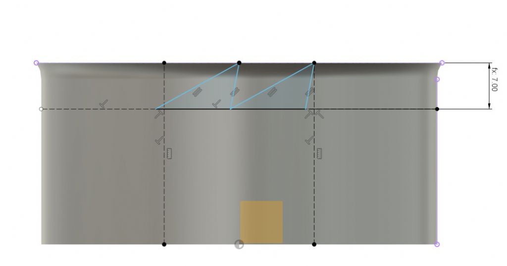

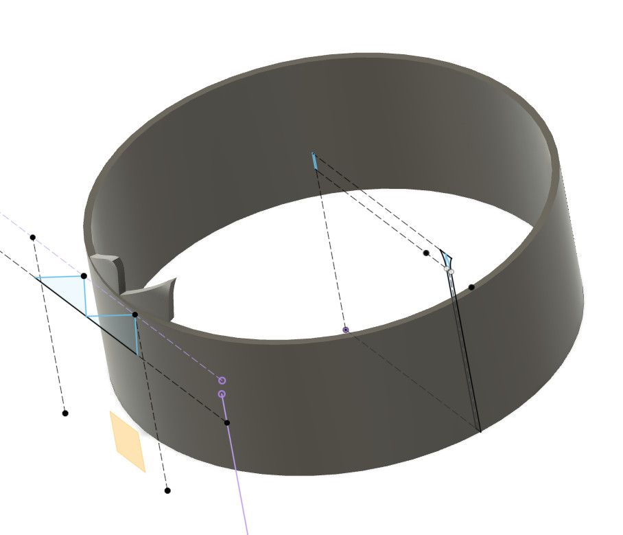

                                          A new sketch was then drawn from the top. This was to get the correct angle for the pairs of teeth – I chose 10 pairs.
                                          I then created a workplane offset from the original sketch, but through the line defining the angle of the previous sketch.
                                          I then cut then created a workplane to cut the two bodies along the horizontal line of that sketch. This created 4 bodies: two copies of the cylindrical parts, and one each of the in/out sloping parts.
                                          #611699
                                          Gary Wooding
                                            @garywooding25363
                                            Continued…
                                            I then lofted the two teeth towards the small rectangle in the centre.
                                            Because the in/out sloping parts were now separate from the two cylindrical parts I could create an intersection of one tooth and the in-slope section, and the other with the out-slope section.
                                            I could then do a circular pattern of the two teeth and then combine then with one of the cylindrical parts. That completed the job.

                                                Many thanks to Gary for his comprehensive description of how to kerf teeth on a hole saw with Fusion360. My next job is to replicate it in SolidEdge. (Almost certain the method will work, but I'm finding SE harder to drive than Fusion.)

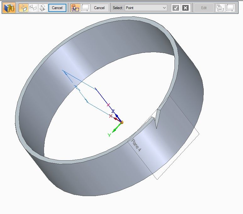

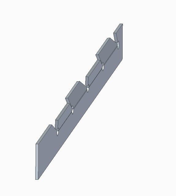

                                                  Re Howard's suggestion – drawing the teeth on a straight strip and then rolling it into a circle. Turns out to be possible with SolidEdge Sheet-metal but not as I expected!
                                                  The trick is to:
                                                  1. Draw a circle with a break in it.
                                                  2. Extrude the circle with 'Flange Extend' to create a cylinder (with break)
                                                  3. Unbend the cylinder (a button) , producing the flat strip needed to make it
                                                  4. Add teeth to the flat strip
                                                  5. Rebend to put the flat strip back into circular form. (another button)
                                                  Image shows the Rebend action just before confirmation:
                                                  unbend.jpg Dunno what's going on today, people keep me ringing up and banging on the door. Feels like family, friends and Postie have organised themselves to cause maximum disruption.
                                                  #611781
                                                    That was my first suggestion too, to draw it flat and roll it up like they are made.
                                                    Can rolling it up include the set of the teeth?
                                                    #611787
                                                      Posted by JasonB on 30/08/2022 16:27:52:
                                                      Seems not! So close and yet so far…
