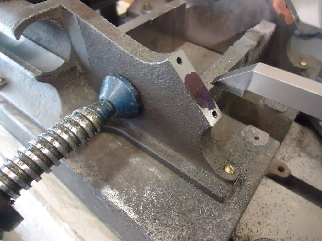

      Today, I made a start on the first of the two standards for my Double Tangye build. I have bored one leaving this one to do.
      I made a boring bar to do the job out of a long 3/4" diameter bolt. The HSS bit sits in the end at a 45 degree angle and the bit can be advanced under control using a 4ba socket grub screw………

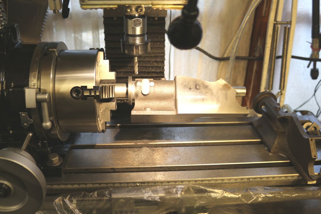

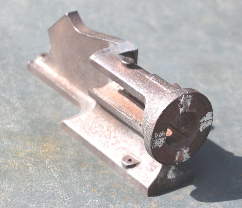

          Having partially machined the pair of standards it was time today to do the job I have been putting of for weeks and that was to machine the cylinder mounting flanges but more particularly, the rear of the flanges indicated at "A" this being necessary because the cylinder retaining nuts need to sit square on the back of the flange and also the rough casting would not allow space for the 6BA nuts.
          So having previously bored the standards to take the crossheads I used the same mandrel to mount the first standard to the chucked rotary table on the milling machine. I used a small end mill to reduce the casting diameter to allow space for the nuts and used the same end mill to face the rear of the flange.
          This still left the area on the underside of the flange un-machined due to the corners of the casting foot "B" fouling the collet holder. I had no choice other than to "peck" it out with the end mill and finish with a small square file.
          My die grinder smoothed out the step left by the end mill. I admit it does not look to pretty at the mo but when the painting has been done I am sure it will look OK.

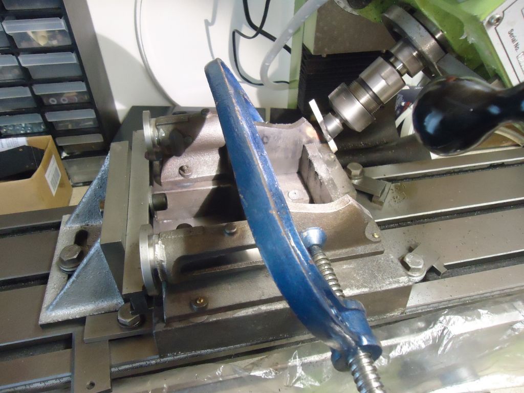

                Because of recent workshop relocation and other stuff I have not been able to make any progress on my Double Tangye build. I have, more or less, got myself organised enough to make a start so into the shop this morn and machined the 450 angled crankshaft bearing cap mounts on the two standards with a fly cutter.
                Just a matter of removing a little at a time until the scribed line comes central over the length of the pad.
                I must admit that working out how to do this took much longer than the machining itself. If you look at the first pic you can maybe see that the finish machined cylinder mount faces are up against an angle plate "register" clocked square to the mill bed. This ensures that the dimensions from said faces to the centre lines on the angled pads are equal.
                Next job (easy) is to drill and ream a couple of holes through the base of both standards and into the base casting to take a couple of dowels. I need to remove the standards for further work and this ensures they will go back in the right place.
