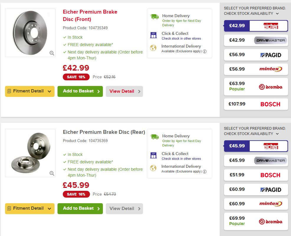

                          Terry Kirkup
                            @terrykirkup37827
                            As I said, you all have me convinced it's a bad idea so thanks again for thatdiscs.jpg!
                            Here's the price of discs for my van, just for info. If I bought the best that would be £216 for the front only. Not as cheap as claimed elsewhere! But I don't buy the "best" and wait for cheap deals coming up. My offspring and their hubbies are all heavy-footed so-and-sos just like me, the wife's car is driven least and suffers most. There probably is something valid about the lack of asbestos in pads now but I think the steel is much inferior too. Most of the changes I am forced to make are due to steering wobble setting in, immediately cured with new discs, not heavy grooving or scoring.
                            I'm sorry to have dragged model engineering into a driving instructor's course! No further advice (on lathe butchery) required
