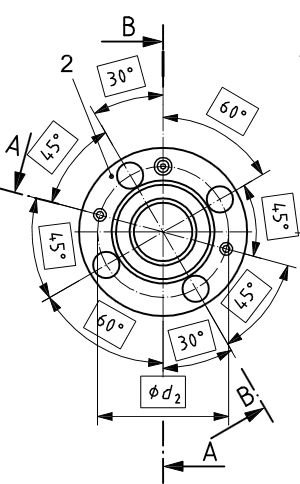

Two of my lathes have what is usually referred to as the 'A Series '
Yes the driving dowel is offset but as it's also held by 4 studs it's a bit overkill.

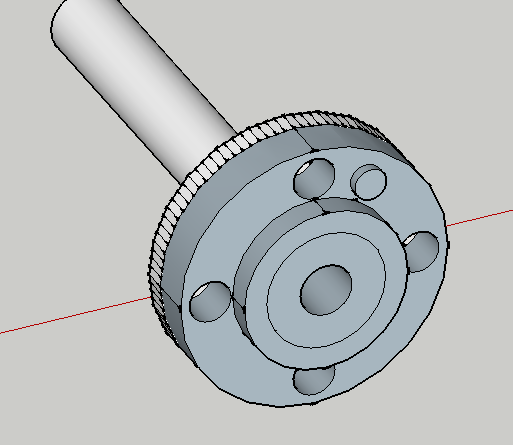

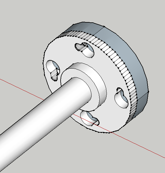

As John says in the post above the full sized versions have the same taper as the 'D Series ' but fixed studs into the chuck on the back.
They also have the 'keyhole' plate which allows you to offer the chuck up with nuts on the studs, rotate the keyhole plate and nip the nuts up.
Many don't realise you can fit them with the nuts on and then just nip up.
Personally I think they are quick, I can swap chucks on my machines faster than the camlocks.
Another advantage is it's positive, tight is tight and no looking at lining up arrows or going round a second time.
They cannot come undone under severe interrupted cuts like camlocks can and often do
