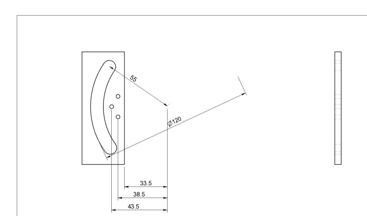

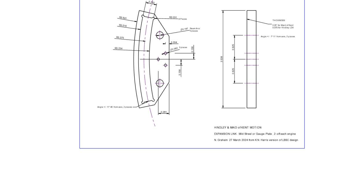

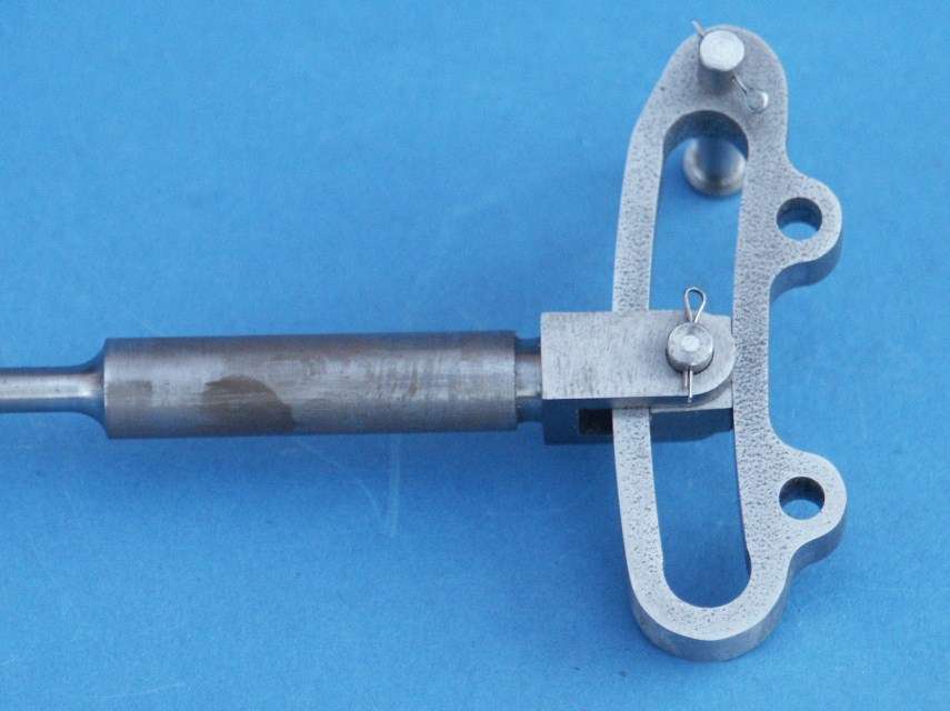

      Err, I think I’ve backed myself into a corner.
      I don’t know how readable the attached drawing will be on here.
      I’m adapting the K.N. Harris version of the motion-work for LBSC’s ‘Maid of Kent’ design, for my steam-wagon’s engine: the cylinder sizes are similar enough.
      I’ve drawn the Expansion Link in decimal and angular format so to make all the arcs and holes by polar co-ordinates and rotary-table; but cannot see how to dimension the straight back edge of from the link centre-lines, hence derive its distance from the origin. I can work it out and describe it by a Note, but I want to be able to verify the dimensions within the drawing itself.
      For this edge, according to Mr. Harris, potentially controls the suspension-point’s location, although he does give the important distance of that from the slot centre.
      The arcs all obligingly provided their radii, so if pick the intersection of any one of them with the horizontal line – which I cannot see how to produce in either direction on the Drawing – it simply repeats that.
      Nor can I see how to enter centre-lines between non-parallel entities the ends of the slot (the overall length is easy, from the side elevation).
      Only, I’ve turned a rather confusing original drawing full of thirty-tooths (and I found an arithmetic mistake among them!) into a complete puzzle. Alibre can tell me exactly what I had drawn, but I can’t see how to ask it the critical one.
      I can calculate the polar co-ordinates to drill those three small holes as I have placed them, but I would like to use the system’s own maths to confirm my placing w.r.t. the centre of the link. The original drawing dimensions this assembly in a rather back-and-forth way.
      A thought: would it work if I put all the lines on one Layer? Or would that create other difficulties?

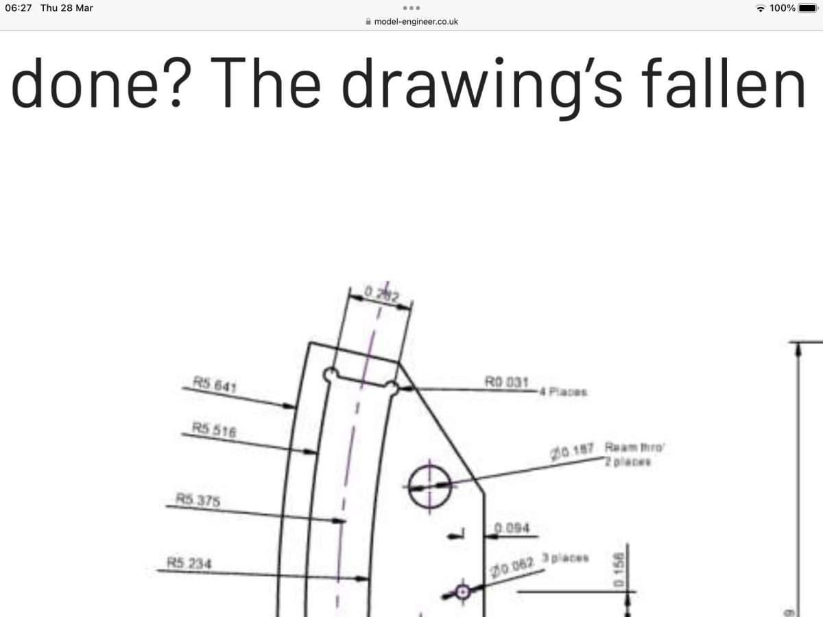

        I cannot advise regarding Alibre … and would not presume to try … But I will give you the small encouragement that one instance of your drawing is visible in the post.
        Visible, but not very easily legible [but that’s presumably a forum problem]
        Edit: __ This screenshot of a pinch-zoomed area should nicely illustrate the disappointing quality of presentation on the forum page:
        IMG_9486

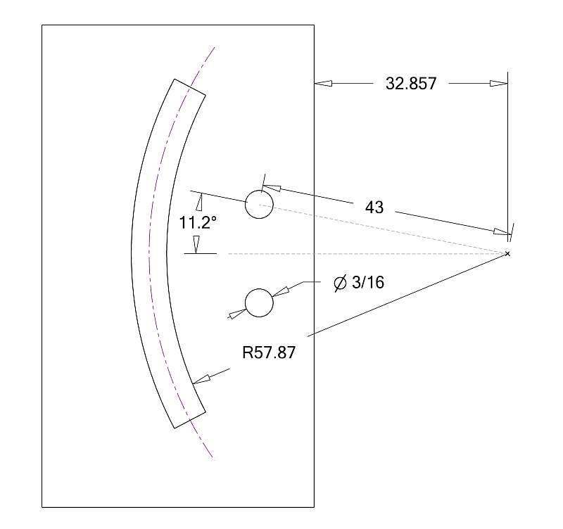

          N link

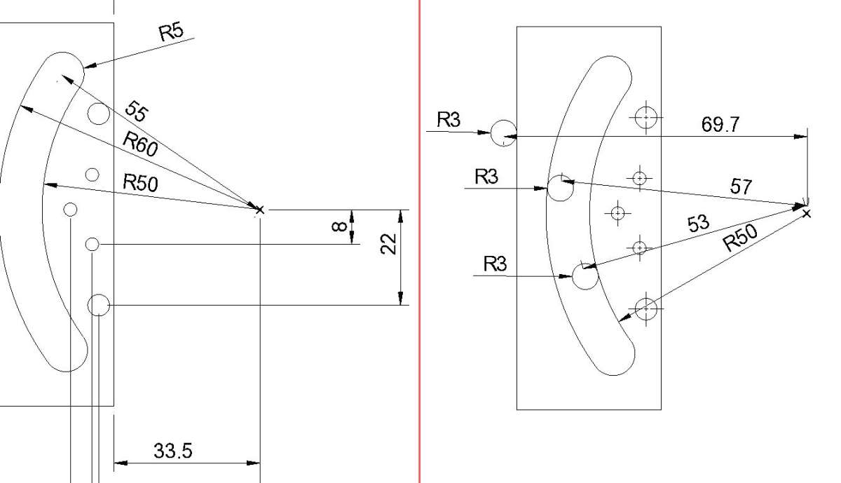

          First dimension the radius or diameter of one of the arcs that make up the curved slot, place dimension on the inside of the arc not outside That will establish a ctr point on the drawing sheet this comes up as an orange dot which being the ctr of your rotary table is the ideal datum to then work from.
          n link dot
          I have then used that point and the various small circles to dimension their ctr position from datum
          I have also dimensioned the flat edge from the datum.
          PS I would not presume the quality of the captured alibre drawing is a forum problem. You get out what you put in.

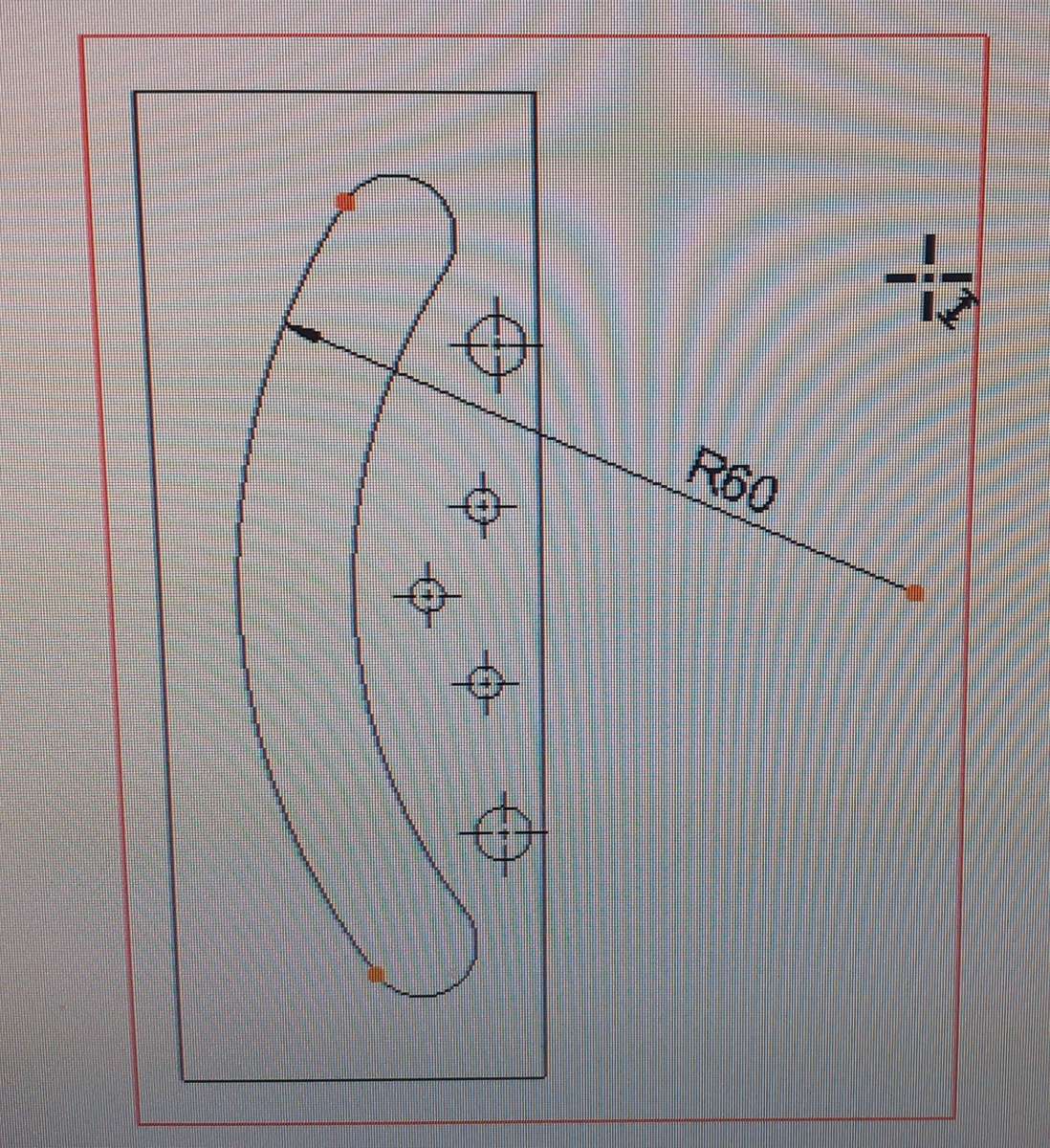

                Something like this?  Not sure I’ve grasped what you are actually wanting…Expansion link
                The ‘trick’ is in order of selection – the ‘slot’ dimensioning tool only appears if (with dimension tool active) you select a straight edge and then a circle/arc.  A dialogue should pop up offering a number of choices about how the dimension is to be arranged – you may have to try more than one to get what you need.
                You can use the same ‘slot tool’ to dimension your small corner holes relative to the straight edges of your part (or to any straight line that you add to the view).

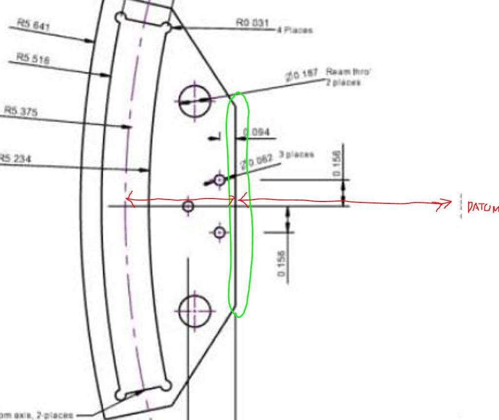

                  David, how are you getting the dotted ctr line to show down the middle of the slot? When I place my sketch elevations I don’t get that even ticking show ctr lines. This means I can only dimension from the straight edge to one of the sides of the slot not the ctr line
                  It would be better to dimension the vertical edge back to the datum wher the cts of the radii are then all sizes can be taken from that datum eg zero DRO on ctr of rotary table.

                    I used the centre-line tool to place the centre-line

                      Thanks David, simple once you know it’s there, another one to remember for future use.
                      I get the slot options come up Ok and do somtimes alter the option number but most of the time Alibre seems to pick the one you want anyway.

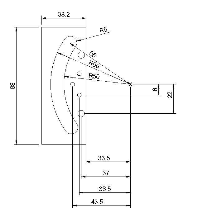

                      I think it is the right of the two red dimensions shown here that Nigel wants but could be the one on the left. I was going to draw his part exactly but without one of those it can’t be done. position of the 3/16″ holes also missing.
                      n dim

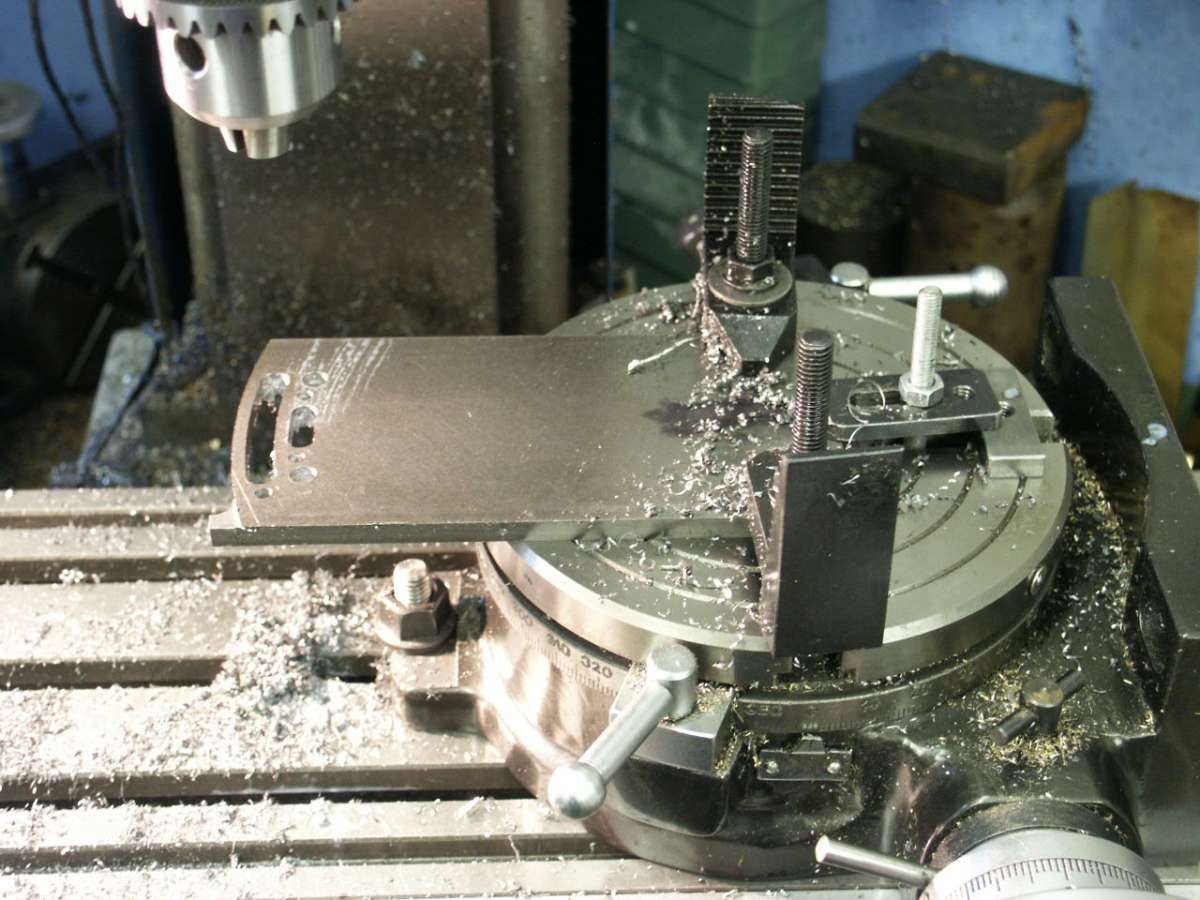

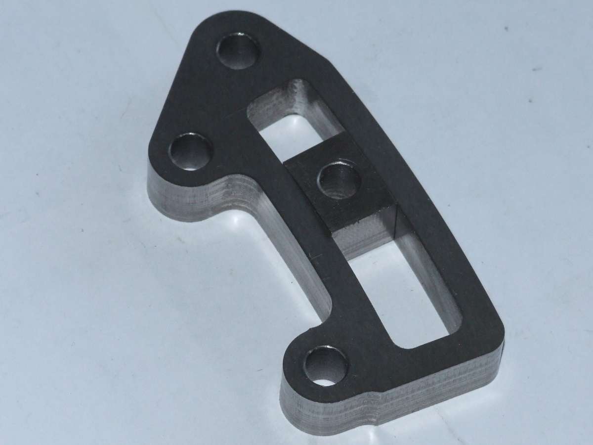

                          Just bolt a bit of plate to the rotary table. Add a couple of angles for the chamfered corners and it can all be done at one setting. The holes in the corners or a larger half round at the end were often use dso the die block could run out into the gap and not leave a ridge as the link wears.
                          One I made earlier, I’d bang it out on the CNC now.
                          expansion
                          PICT0110

                            Like so (obviously my sizes are random – just to show that the dimensions can be placed).
                            Expansion link2a

                              Ah – that is what I want, but I could not see how to do that. Each time I selected the centre-line it obligingly quoted the radius. I could not select that centre-point
                              This link differs from Jason’s, which seems to be for a traction-engine with its suspension-point beyond the end of the slot. Mine is a locomotive type, with central suspension offset behind the slot slightly.
                              The three small holes are for rivets that hold the two lifting-link brackets on, and the original drawings give you some rather awkward arithmetic to place everything as they should be.
                              The lifting-link trunnions are on the horizontal centre-line a set distance back from the slot centre-line. The assembly in in three separate parts, and as the original drawing is not easy to work out I decided the CAD could verify my sums, but could not see how arrange that!
                              The two 3/16″ holes’ locations are measured on a radius from the same centre as the rest. (The crankshaft axis on the finished engine.) That radius and the height above and below the centre-line are on the K.N. Harris drawings, but I could not see how to put the radius on the Alibre drawing. Their heights are on the side elevation, along with their angles, to set them out by polar co-ordinates; but that still needs the radius on the drawing! I think I’d have to do that by a note.

                              Yes – I was envisaging making these links on a rotary table as you show. Only being loco links they are more complicated than your TE pattern one, with fiddly lifting-link trunnions.

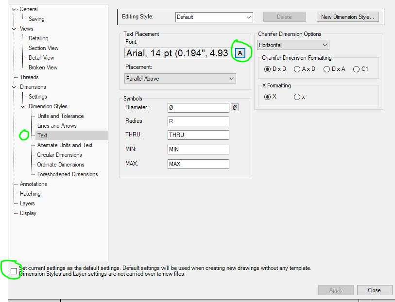

                                Might want to think about increasing the height of the text as I find the default 9pt a bit small, it will make it easier to read in the workshop and also clearer if you post any more images here, try 12 or 14pt Ariel. To do that click “dimension styles” at the top of the screen. On the screen that opens select “text” down the left hand side, you can then click the box with “A” in it and that brings up a window with font size and style, choose what you want and before saying OK tick the “make default” box then you won’t have to do it again.

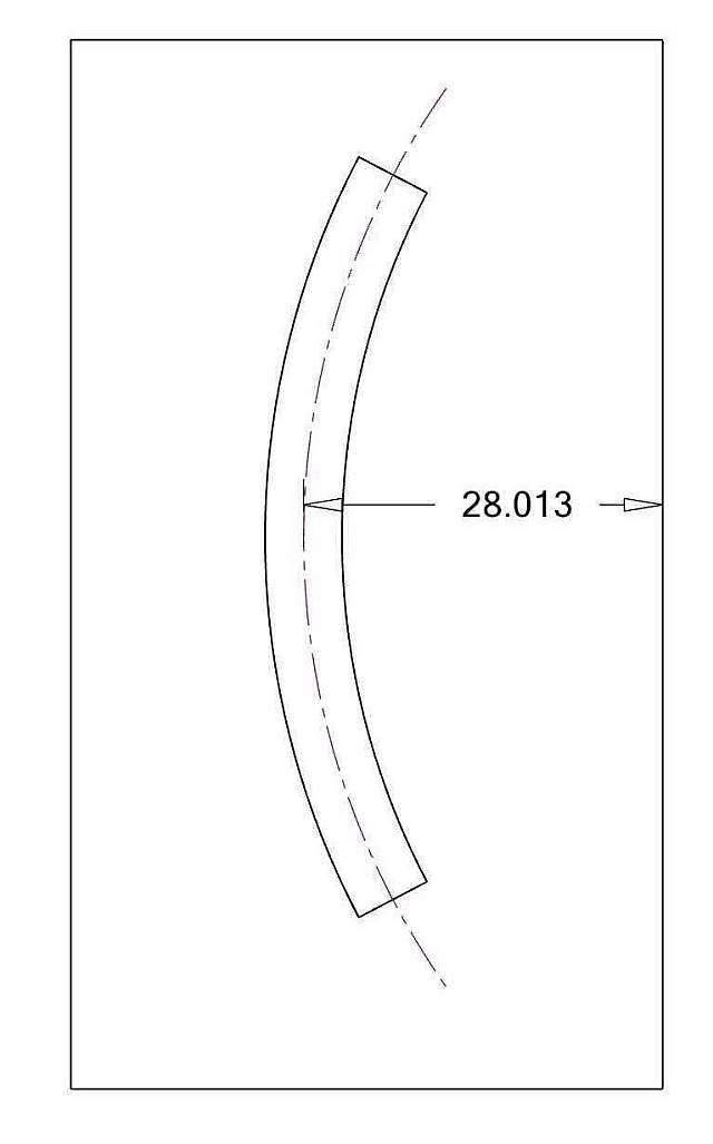

                                  As Jason showed in his first response, dimensioning an arc (even if you ultimately don’t want that dimension) will add a yellow/orange node at the centre point – you can use that to add further dimensions from.
                                  The ‘slot dimension tool’ I mentioned gives another way to tackle this.
                                  If desired you can add items (e.g. points and ‘construction’ lines) into a drawing view manually if that will help to generate your desired result (right click within the bounding box of the view, choose Activate Sketch in View).  These can help with subsequently adding angles…
                                  Expansion link3a

                                    Jason (& Nigel) – things like font size are inherited from the drawing template.  The ‘set current settings as default’ will only apply to drawings on blank sheets (no template used).
                                    It is possible to edit the provided templates – though these are set ‘read only’ in Windows by default.  Probably better to open the template file and ‘Save As’ to your own location, and then adjust the properties, add logo, etc.

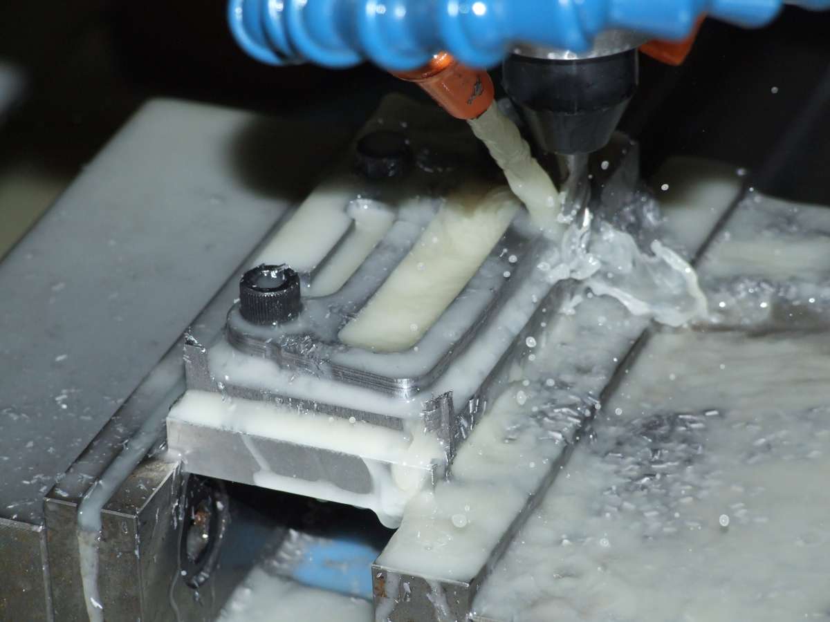

                                          That’s what I did when making an expansion link set for a fellow traction engine builder:
                                          2011_10030014
                                          In the CAM program I left the slot undersize by 0.01mm and the mating die block was CNC machined 0.025mm oversize. The slot was finished by draw filing using Hoffmann roller as a gauge. Finally the die block was filed to fit the slot. Material was 1/2″ thick gauge plate.

                                              Aha! I have just opened the drawing in Alibre and wandered around the tool-bars a bit.
                                              I have found the radial centre tool – it is off the “paper” at the scale I used. Plus those other dimension and other formatting menus.
                                              I stripped the two height dimensions from the two small holes, and that revealed an extended centre-line that stops with orange dots just left of the slot centre-line, and just outside the outline to the right. So there is a CL intersection but I can’t dimension from it to anywhere else. The dimension wants to go from the dot instead.
                                              I found the centre-line tool on the regular Drawing menu and the main tool-bar by exploring, and that obligingly put the centre-line on the slot.

                                                    Layers in Alibre 2D drawings are as you surmise basically for managing line appearance – there are a number of default layers, but you can also add your own. I often add an extra layer with visibility turned off when I want to do more complex things than the standard ‘Hide’ options provide for in the drawing.
                                                    ‘Weight’ is the thing to adjust for line thickness of a layer – also experiment with the setting of the ‘Realtime Line Widths’ option in System Options -> Drawings -> Viewing/Interaction.  That setting affects the on screen display (printouts should always match your line weight settings).

                                                      David –
                                                      Thankyou.
                                                      My query was to try to escape a sort of mental block that arose when I tried to convert a rather mixed original dimension system into one I thought would be more logical for making the part.
                                                      The link’s curved front and curved slot are formed using a rotary-table, so I tried to re-draw it in Alibre in a corresponding way. The two 3/16″ holes are also dimensioned on a radius, on the original drawings: and all radii are concentric and centred on the axis of a shaft a long way from the link.
                                                      So far so good.
                                                      Then I was faced with extra features dimensioned originally in rather roundabout ways,  that add complications of their own. The critical dimension for those is from the centre-lines of the slot to a pin on a bracket rivetted on via those three small holes, not on the link itself as drawn.
                                                      Jason’s and Andrew’s photographs show a different, and much simpler, version of the same functional component. Effectively the type I am using replaces that large hole out on the end of theirs, with a pin set off-centre on a bracket in the middle – two brackets actually, one on each face.
                                                      I was baffled by trying to dimension from that centre-line intersection to the long straight back edge and the holes, to verify my arithmetic.
                                                      I wondered if drawing the complete assembly would help. It is 5 separate pieces of steel (1 link, sandwiched between 2 brackets with their pins) with some quite critical dimensions involved.
                                                      Well, one side of it anyway, an Assembly of just one bracket and the link. That must involve aligning it by at least two features, and I would find that hard enough.
                                                      This item is not an easy proposition at all, neither to draw in CAD nor to make physically! Especially without all that CAD/CAM luxury.
                                                      I take Nick’s point that dimensioning anything from a point out in fresh air is bad, but in this case I have no choice.
