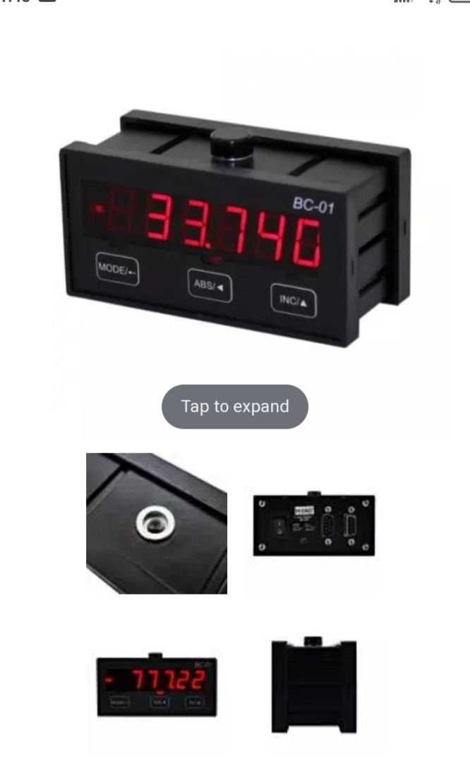

      I'm considering fitting an Arcuro Tools Standard digital read out BAR to my Myford Super 7 lathe cross feed. Before re inventing the wheel, has any one already fitted one and would they like to share with me how they mounted it. John

                Machine DRO sell small single and double readouts compatible with their various scales they sell

                    I'm going to fit the embedded scales to my lathe soon, I can't remember exactly what the price is to upgrade, about £25 per readout to upgrade to 0.001mm resolution, which seems pretty reasonable to me.
                    This is their single readout, probably about 45mm~50mm high so pretty compact.
