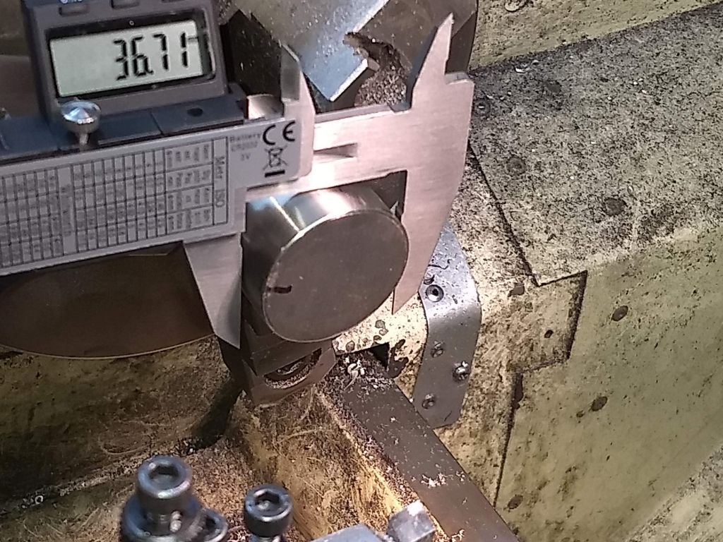

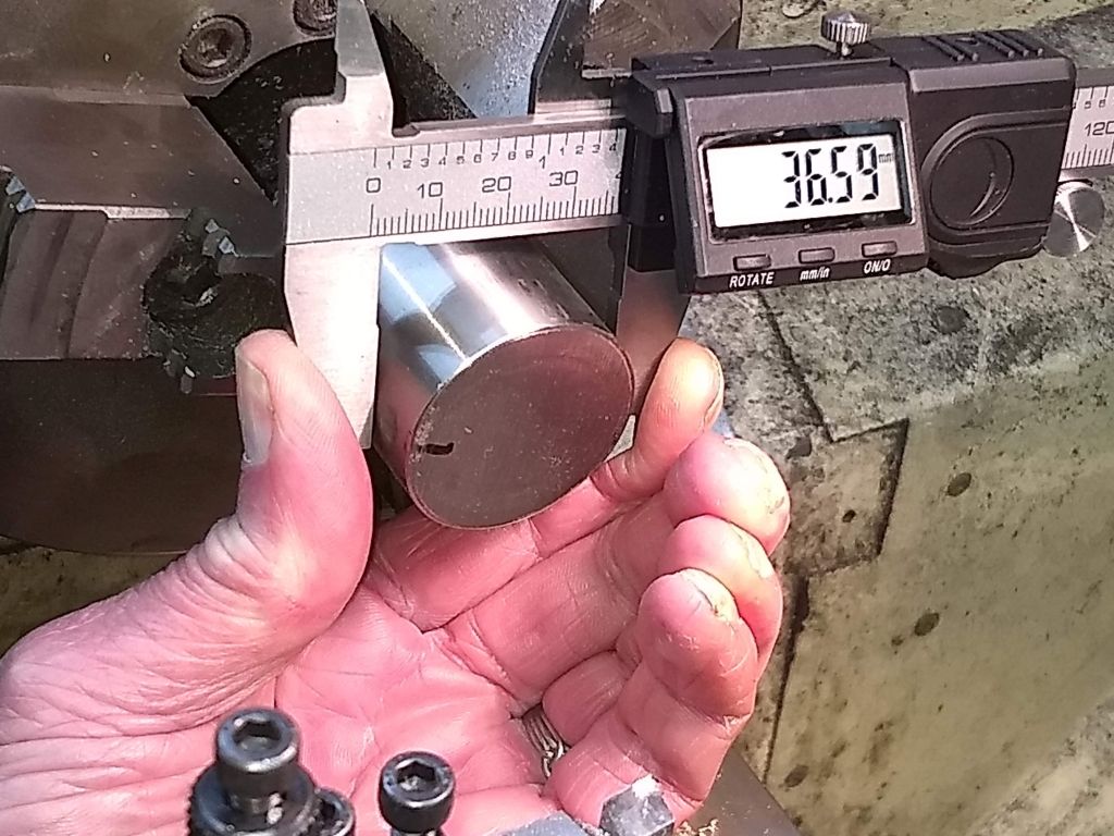

                                                    The tilting display callipers arrived yesterday. They seem OK and the rotating display appears to work fine. The following 2 photos show how the display can be tilted to make lathe measurements use easier when in right handed mode, or rotated to allow use left handed. Either way, seems to me, is better than the standard RH type.
