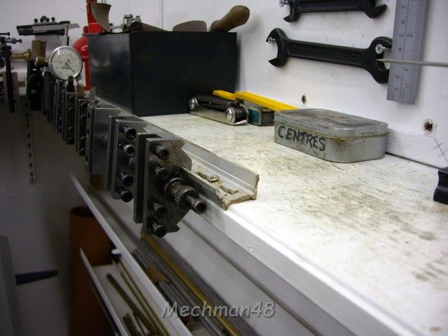

            mechman48
              @mechman48
              I have used clip in shelf brackets screwed to the back shelving…
              ​George.

              Steve Addy
                @steveaddy35670
                Thanks guys. That was quick.
                I know Malcolm of ME Laser, so I could ask him.
                The two pins make sense and I was thinking of mounting them upright as they are used. Now I'll have to have a look to see if they are better as in George's pictures as I hadn't thought of that. Should be better for storing ones with large boring tools

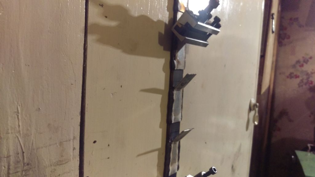

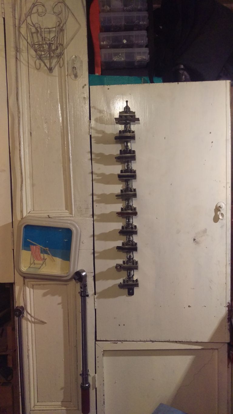

                Nick Wheeler
                  @nickwheeler
                  Mine is made from ten pieces of 25x1mm steel strap 70mm long with a roughly 30degree bend in them. These are welded to a length of 25x3mm steel left over from a previous project, and the whole thing is screwed to the cupboard wall next to the lathe.
                  and
                  That's about 30minutes work, which includes the 'design', and about a fiver in materials.

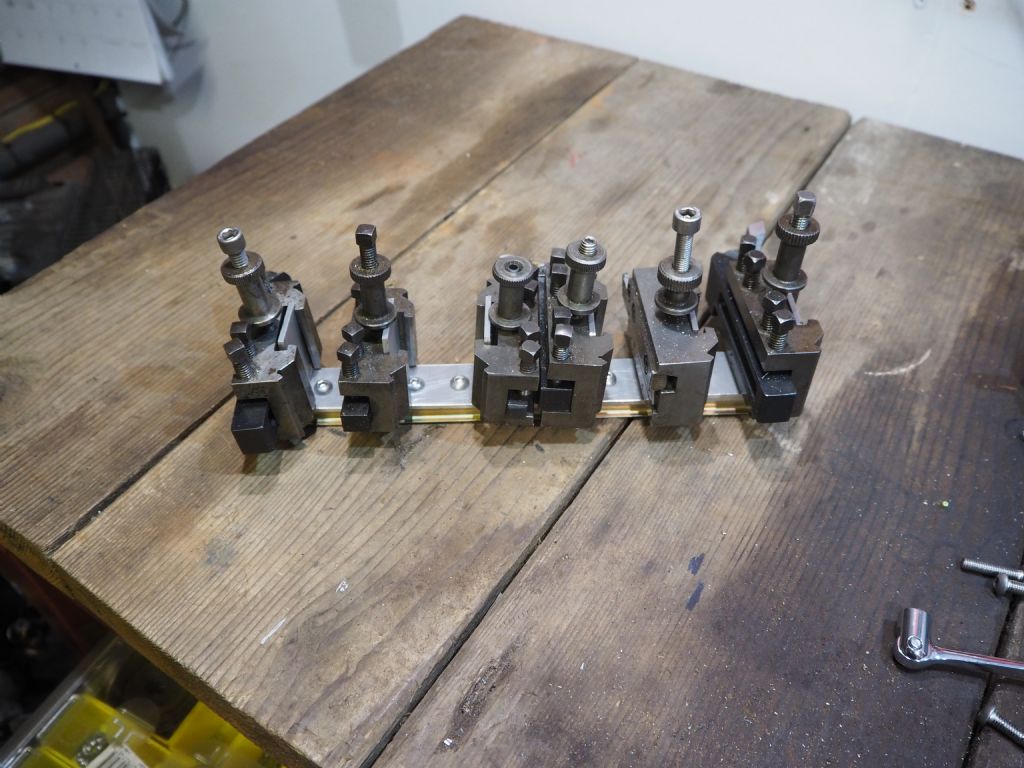

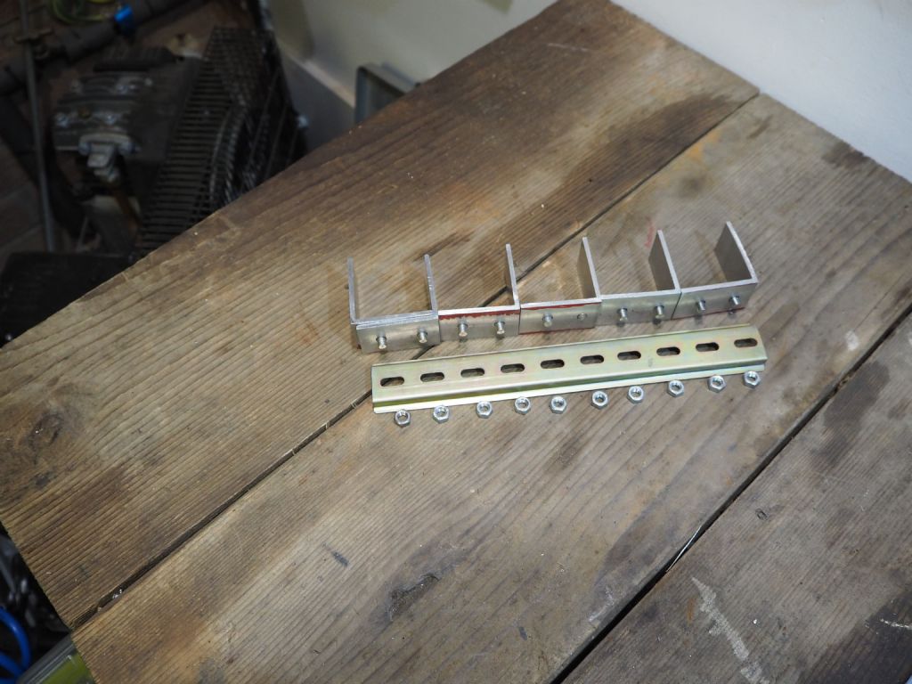

                        Antony Price
                          @antonyprice56876
                          It has been a busy month, so I’m only just catching up with the Forum!
                          I can’t take credit for the idea. I stumbled across it on Pinterest.
                          The aluminium angle was an off-cut from when I relocated the leisure batteries in the mobile home.
                          The DIN rail was left over from when I rewired the milling machine. The screw slots in the DIN rail, made putting it all together very easy, and the design can be scaled
                          I did make a Lantern Chuck to size the screws, but that has already proved useful for other projects

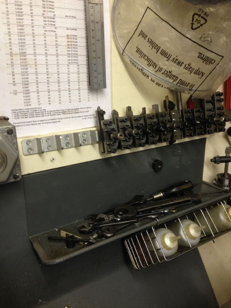

                              Gordon A
                                @gordona
                                Offcut of mdf architrave, (top half slopes back at about 10 degrees) + offcuts of 1" (25mm) aluminium angle cut to length to fit slot of toolholder.
                                Dickson Toolpost - Tool Holder Rack

                                  #284965
                                  thaiguzzi
                                    @thaiguzzi
                                    Posted by Gordon A on 11/02/2017 21:02:48:
                                    I like the cutting fluid bottle rack. Neat idea.
