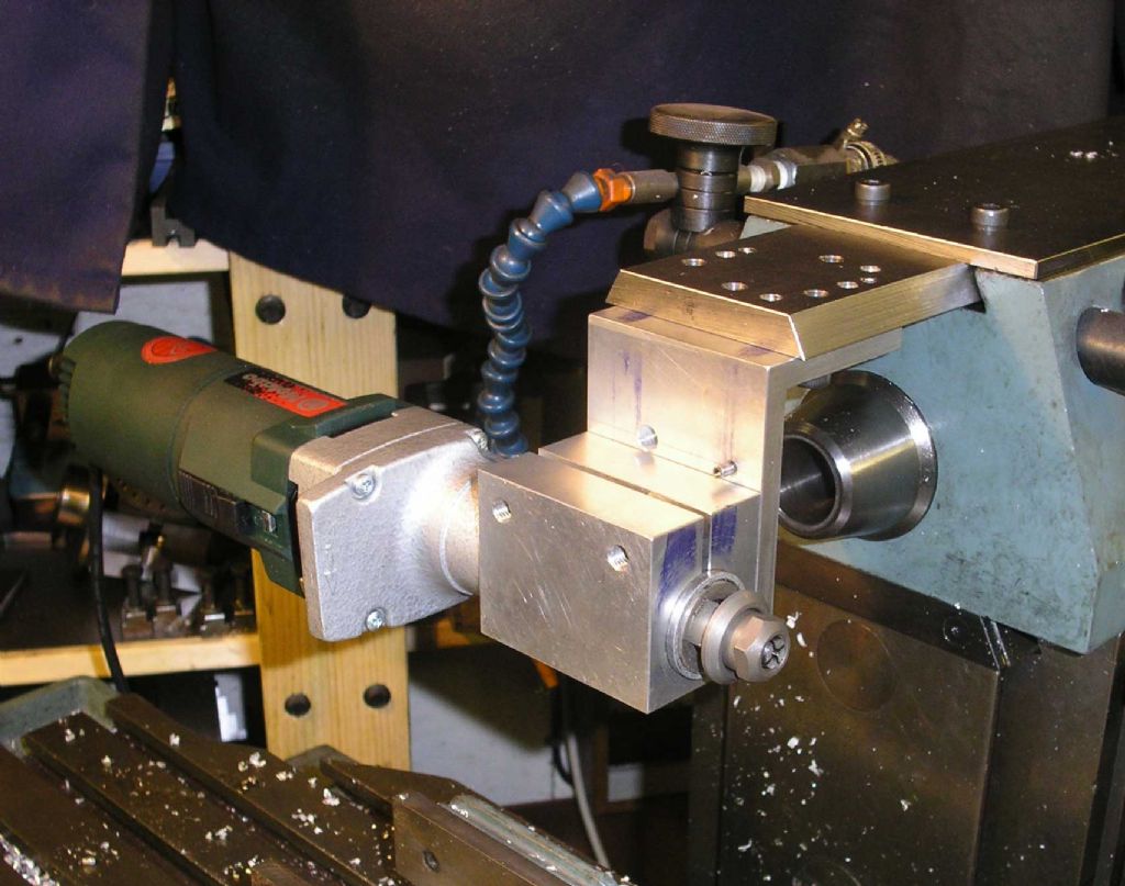

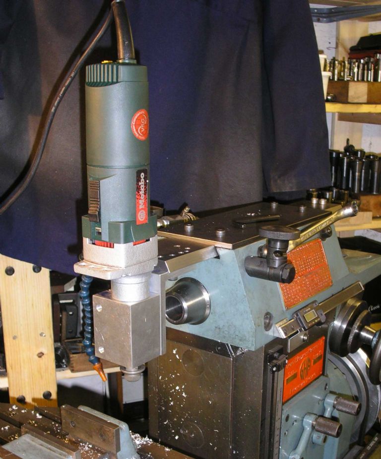

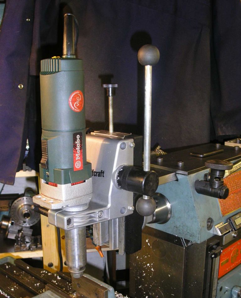

                        The machine as standard has just the one two speed motor, this drives the horizontal spindle, and then if fitted the vertical head and slotting head.
                        The feed screws are also powered by the same motor, the actual feed rate can be changed by swapping pairs of gears inside the main column of the machine.
                        The high speed head is an absolute "must" for smaller cutters, I was extremely fortunate to find one for my machine after I had owned it for a few years, and I have not seen one for sale since I bought it.
                        I rigged this die grinder up for a while prior to getting the h.s.h.
                        Phil
                                          The high speed head is an absolute “must” for smaller cutters, I was extremely fortunate to find one for my machine after I had owned it for a few years, and I have not seen one for sale since I bought it.
                                          Phil

                                            Ryan
                                            Leave it with me and I will have a look for you tomorrow, I still have the die grinder in it’s original box.
                                            Phil P
                                            #818408
                                            ryan.carter848
                                              @ryan-carter848
                                              Thanks Phil, you’re a legend cheers!
                                              #818461
                                              Phil P
                                                @philp
                                                Hi Ryan
                                                The die grinder is a Metabo Gs E 7145
                                                2000 to 5500 rpm, 710W
                                                I think it will be an obsolete model now. It was apparently replaced by the GE900, but I am not sure you can still get those.
                                                https://www.shopfloortalk.com/forums/showthread.php?t=13961
