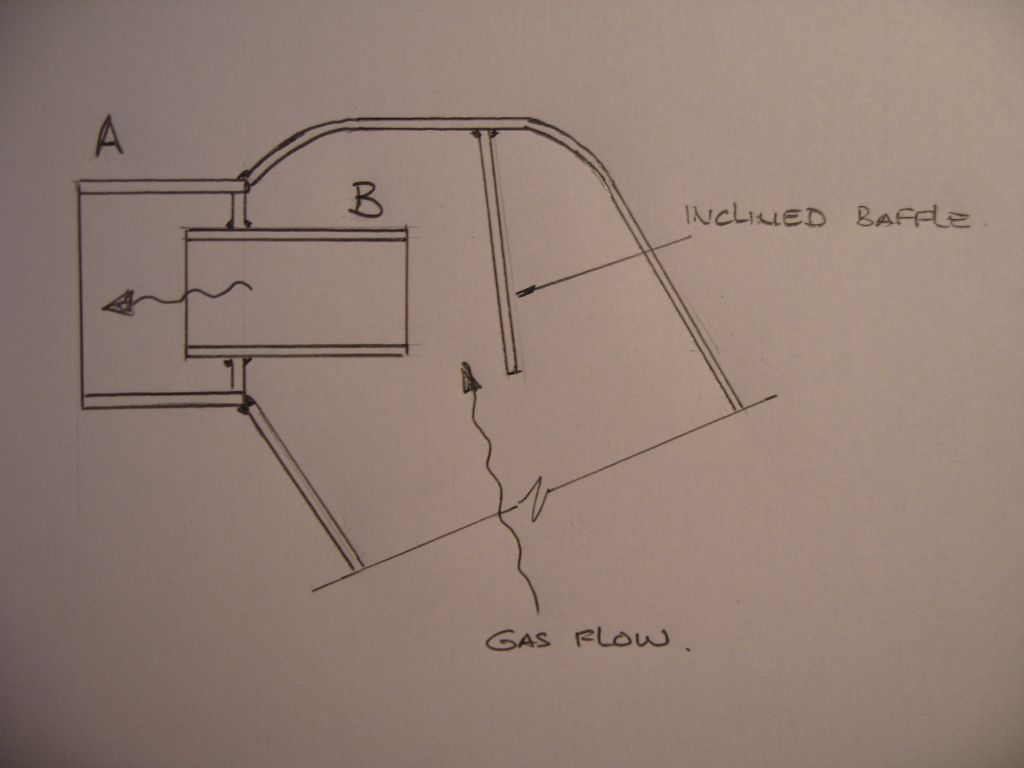

      Hello all.
      For those of you that have been following the challenges of renovating a Honda SL125, it is now running, on the road, insured and officially an 'historic vehicle'. I am currently 'de-snagging' the vehicle.
      A current 'snag' is that the exhaust is (very) loud.
      It has an aftermarket muffler which isn't as well engineered (or expensive as an OEM unit – $2999.95 U.S.) but has the correct contours and is aesthetically correct. I propose to modify the aftermarket unit by putting a diffuser in the exhaust stream to hopefully deaden / reduce the sound. I propose that the diffuser will be similar to the OEM design – see item 6 on the sketch below.
      This would require removing the existing outlet pipe and an internal baffle (Rotabroach cutter maybe) to provide room for the diffuser.
      I am relatively confident I could make a diffuser to suit from steel, and that the primary design parameter is that the diffusers combined 'flow gas' area should be not less than the open cross sectional area of the current exhaust outlet.
      So my queries are –
      Is the above design parameter reasonable and do you think a quieter exhaust note would result?
      Are there any other issues I should take into consideration?
      Should I leave things as they are and claim ' historic vehicle / old technology' if challenged?
      Lastly, and this is the most interesting bit,- have any of you any different solutions that could be applied to this to result in a quieter exhaust.
      All the best, and thank you in advance for any input / comments
      Alan.

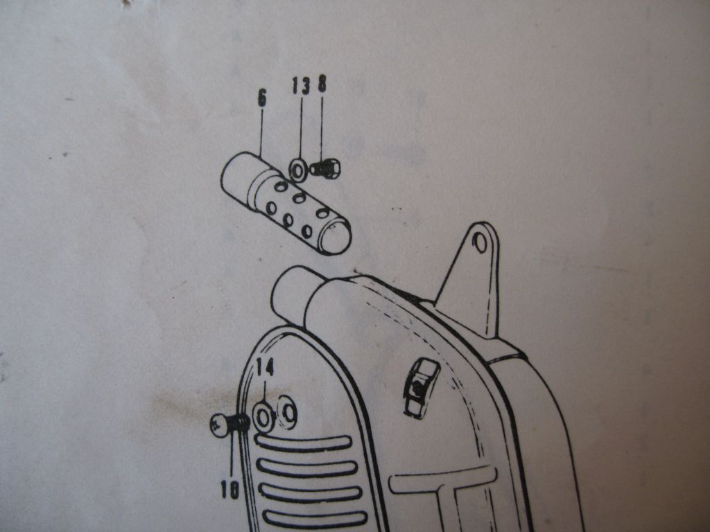

                  P.S. Just a thought while writing this. The black box on the exhaust system is described as a 'muffler'. Is a muffler an alternative term for silencer or is a muffler technically different to a silencer?
                  Best regards to all.
                  Alan.

                  #551552
                  Redsetter
                    @redsetter
                    Alan,
                    Looking at the photo, the enlarged end of the outlet pipe will have a megaphone effect, somewhat like a loudspeaker cone. Extending the inner pipe, or simply inserting a bush to reduce the outer pipe diameter, might be interesting. Whatever you do, you will have to get it very badly wrong to compromise performance. Let us know how you get on.
                    I think Muffler is just Chinese/American for Silencer.
                    #551558
                    Emgee
                      @emgee
                      Alan
                      I believe what you intend to do will reduce the dB level from your exhaust system, provided the combined area of the wall holes are equal to the existing outlet area performance should be similar.
                      From the sketch it seems the your new diffuser has a closed front, is that correct ?
                      However if the outlet area is currently larger than optimum reducing the output area may increase power output with less noise.
                      Emgee
                      #551559
                      Clive Foster
                        @clivefoster55965
                        That diffuser is basically a simple annular discharge outlet functionally equivalent to a slot outlet fishtail but significantly less effective because the flow path length is the same all round. Properly made fishtails are better because the path length varies depending on where the gas actually comes out of the fishtail and expands into the atmosphere. Considerable potential for destructive interference reducing sound levels. If you are lucky there may even be a bit of pipework in that diffuser giving some sort of reverse flow effects.
                        Messing about with different styles of diffuser / absorber bungs is likely to be interesting, frustrating and inconclusive in fairly equal measure.
                        One things for sure as an aftermarket unit the internals were never designed in any real sense of the word. Usual philosophy seems to be "Just stuff something it that looks like it might work." It is, after all quite hard to make a completely ineffective silencer / muffler. Especially when market demand is for something a bit more rorty than standard.
                        The aftermarket one on my BSA DB32 Gold Star had a single lonely baffle about 2/3 rds of the way along yet was silly quiet up to around 3,500 or so RPM. Above that standard "Who started World War 3" service was resumed. I felt the characteristics well suited to my youthful use. After all successfully creeping in at silly early hours in the morning to be followed by bleary eyed breakfast time maternal interrogation "And what time did you get in last night? I didn't hear anything." not being a standard Goldie specification requirement.
                        If you really want something effective its probably best to bite the bullet and accept that the back will have to be cut off and proper innards inserted. After experimentation with a relatively crude but near enough the same shape to fit mock up.
                        For innards consider a pair of hockey stick or "J" shaped pipes with closed ends, one on the inlet and one on the outlet set back to back and overlapping for most of the length of the silencer. Drill holes in opposite sides of the pipes so the gas can get from one to the other. Holes at top end of inlet and bottom end of outlet to give some element of reverse flow and expansion. Maybe add a longitudinal wall between the pair to make the flow behave better and another transverse one at the top end of the inlet pipe to properly close things off.
                        A second wall at the top would let you further drill the output pipe and stuff in some wadding to make a short absorption silencer which would take out some high frequency sound removing the hard edge to the exhaust note. That would be similar in principle the the short absorption silencer accessory BSA sold to shove up the tailpipe of a Goldie fitted with the proper, baffle-less, "megaphone" silencer properly intended for racing use. Surprisingly effective at rendering the exhaust less offensive but I never felt the real noise levels were much reduced.
                        A simple pair of J shape pipes is pretty effective though.
                        Clive

                            Alan Donovan
                              @alandonovan54394
                              Hi all.
                              Thank you so much for all your input. There are plenty of options for me to try. I have provided a sectional sketch of the outlet end of the muffler below.
                              I have found a piece of pipe in my 'it may come in useful one day' pile that is a snug fit on the exhaust (diameter A). So first off, I intend to start with just a short extension tube and see what effect that has. I could then try and add some sound insulation on the inside of that and see what effect that has if still noisy. – basically as per Phil P's suggestion.
                              I will probably try the diffuser style of modification as well just to see how that compares to 'tail pipe' mod.
                              To answer Emgee's question the diffuser would have a closed end according to the diagram, but my thoughs are to push the diffuser against against the baffle therefore effectively closing off the end.
                              I will try the easy solutions first before moving on to the more difficult stuff.

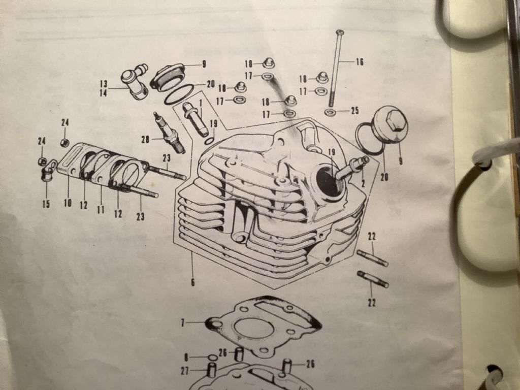

                                  #583093
                                  Rich Griff 2
                                    @richgriff2
                                    Hi Alun, just joined this place.
                                    Sl125, split it solid cylinder head ?
                                    I am sure you now know of T, F, O and the rotor ign advance marks.
                                    Might you have any Motor Cycle Mechanics magazines of the 70's.
                                    It was a monthly magazine.
                                    Always in the back of the mag, in the smaller black and white adverts, usually on the RHS page, appearing regularly, an advert for a honda cb125s big bore kit, showing the unmistakable cb125's engine, with a morphed cylinder head artwork.
                                    That art work would look great on a cb125s tank I have in the shed.
                                    I have been looking for years now, for a mag with the advert, or a copy of the advert.
                                    Might you be able to help ?
                                    Thanks.
                                    #583094
                                    Rich Griff 2
                                      @richgriff2
                                      Sorry Alan, Alun should read Alan.
                                      Cannot find edit button.
                                      #583096
                                      Rich Griff 2
                                        @richgriff2
                                        Solid or split cylinder head
                                        #583176
                                        Alan Donovan
                                          @alandonovan54394
                                          Hi Rich.
                                          The concept of a split cylinder head was totally new to me. A quick check on the internet and (I think) I understand what that concept is now. So to answer your question …… No, it does not have a split cylinder head, it is a solid head. I have posted an extract from the Honda parts manual to show you the type of cylinder head it has. Just in case I have misunderstood this concept.
                                          To answer your second question, ……
                                          Sorry, I do not have any old ‘Motor cycle mechanics’ magazines from the 70’s. So cannot help with the advertisement or artwork.
                                          I can only suggest that you start a new thread on this forum detailing what you are after. Someone may be able to help.
                                          All the best.
                                          Alan.
                                          #583185
                                            Posted by Rich Griff 2 on 30/01/2022 13:58:47:
                                            It's only available for about 30 minutes after pressing the Add Posting button. Allows enough time for mistakes to be corrected after a quick proof read, but then the post is locked. It's confusing if someone else comments on a statement that's changed or deleted much later.
                                            #583189
                                            Rich Griff 2
                                              @richgriff2
                                              Yep, that looks like the one I mean.
                                              You know of CMSNL ?
                                              No doubt you are aware of the "Jesus" clip on the bottom of the cam chain tensioner " bolt" ?
                                              Be very carefully not to over tension the cam chain. I have seen these clips ( E retainers ) lying on the cam chain area floor.
                                              I modified ours ( cb125s ) replacing the Jesus clip with a washer and split pin, but the bolt is very hard in the clip area.
                                              Tax and mot exempt ?
                                              Anyways, enjoy…
                                              Edited By Rich Griff 2 on 30/01/2022 21:14:55

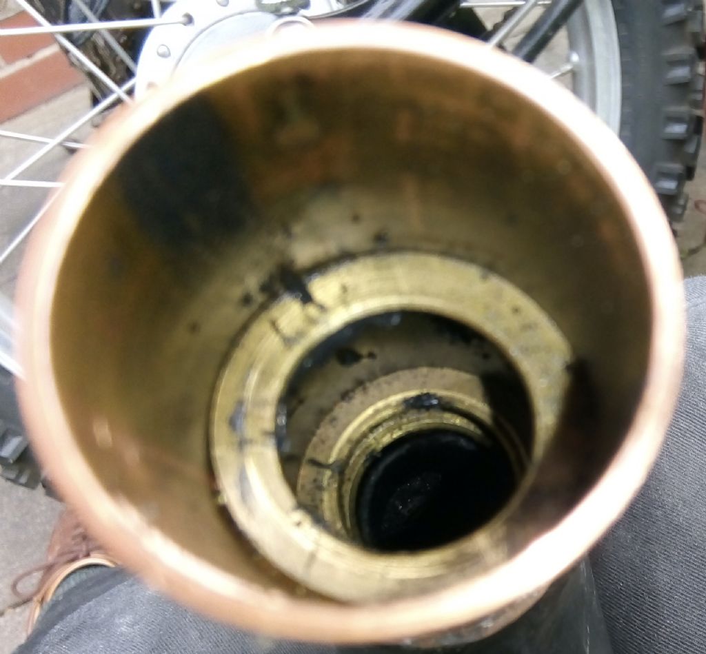

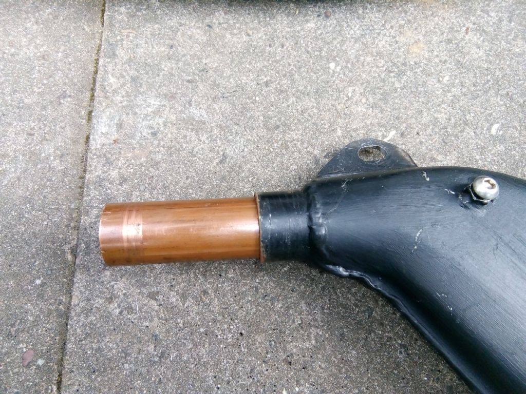

                                              #601494
                                              Alan Donovan
                                                @alandonovan54394
                                                Hi All.
                                                Well it has been a long time coming, but further to my original posting, I have had some success altering/reducing the noise emitted by the SL 125 silencer.
                                                I tried a plain extension tube – no good. No room to put in a perforated baffle as per my original post – so no good
                                                I then found a piece of copper pipe that was a 'snug fit' inside the outer pipe of the silencer outlet, if that makes sense. See sectional sketch of muffler outlet – above – for details.
                                                I managed to make and insert three baffles into the copper pipe and the whole assembly was lightly hammered into the tailpipe. I had intended to put some wire wool into the inlet side of the muffler – but decided against that – it just didn't seem right in this case. The exhaust sound is now quieter and the harshness of the note has gone, so I am happy.
                                                So this is what I ended with ……….
                                                Copper tube hammered into place. The visible extension is about 2.5 inches long – 3.25 inches overall length.
                                                View on end of extension pipe, with baffles inside.
                                                I hope the final result is of interest to you.
                                                Thanks again to everyone for their input – I am pleased with the result.
                                                All the best.
                                                Alan.

                                                stevetee
                                                  @stevetee
                                                  I had an SL125 in 1973 – brand new. It was very quiet. That removable part '6' was described as a 'spark arrestor' compulsory in the States. If you have a one piece head that is usably unworn you are very lucky. Most of them were scrapped by youthful over tensioning of the cam chain when the engine was cold, as the engine heated up the alloy head expanded , but the steel chain pulled the cam down into the head, eventually ruining it. A great little bike , it would go anywhere I was brave enough to point it.

                                                    #602508
                                                    Mike Poole
                                                      @mikepoole82104
                                                      I would check out the legality of using copper tube in an exhaust system. There are many quotes of it producing toxic fumes. In that location I doubt it would be an issue but if it is illegal then you don’t want to give the plod an opportunity to cause problems for you.
                                                      Mike
