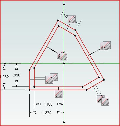

      Hello. I read an article in the 25-year edition about Dave's 3-way tool post. There were only dimensions for the smallest version. Does anyone have the dimensions for the larger version? I have a 9" South Bend which is similar to the Boxford. I live in the US.

          Dimensions of the castings are in he Blackgates catalogue:
          **LINK**
          Hope that's what you need
          #234895
            The only critical dimension is the thickness of the bottom part, this should suit your usual tool size.
            Other dimensions can simply be 'in proportion'.

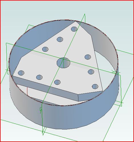

                    I think this is the smaller one
                    Could be cut out of a bit of 80mm CI bar for £12.50 or a casting for £17
                    #243274
                      If you take the differerences in length between the A @ 2.875" and B @ 3.25" then proportionally you end up with something like this assuming the drawing above is for the A type. This would just come out of a bit of 90mm bar
                      Edited By JasonB on 18/06/2016 14:27:23

                              I thought the idea of these toolposts was that they could be made on the lathe and only the lathe that they are going to be used on, typically a flimsy myford?
                              Biggest cut is the 1.25" wide by 2.25 long edge, which is going to be the same size whether you make it from a casting or solid, a few more passes or saw cut just means a bit of time not more powerful machine requirements. Easily done with a flycutter or indexable 40mm cutter up the spout. The casting if I remember rightly does not have the tool slots rough cast so in both cases you will have to mill the 1/2" x 1/2" slots.
                              I know my far eastern hobby machines would have no problem making one. Infact the 4-way that I made on my Unimat3 many years ago had similar areas to machine and that coped well with it from steel!

                                              Yes I can see its advantage over a 4-way particularly when using tailstock support, though as I said in that old 2012 thread the extended Dickson holders do a similar job or more often than not I will now just use a DCMT tip in a reasonably thick holder to get in close.
                                              I was Just a bit taken aback by the comment that a piece this size was considered hard work on a typical lightweight hobby machine. It's no bigger than a 3.5g inside cylinder block or mid sizes Stuart cylinder and hundreads must have been machined in the past with just a lathe which more often than not would have been the trusty Myford. I don't have the original Lammas article but would have assumed as he only detailed the small ML4 version that that was the lathe he had used to make it for, even if he had a mill it would likely have been in proporting to the lathe.
