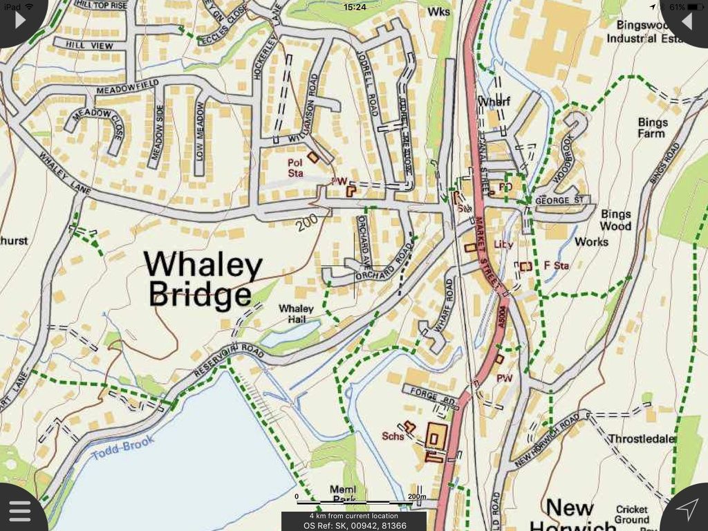

                        Posted by Michael Gilligan on 06/08/2019 21:42:09:
                        Posted by duncan webster on 05/08/2019 19:53:41:
                        Ah but, if you just have a syphon, once it empties the dam down to the level of the intake it will suck air and stop working, so you either need an air pump to re-prime the system, or a valve to stop the flow before it gets too low.
                        Also, the dam is 24m deep (to the water level, never mind the extra height of the wall), so you can't empty it with a syphon anyway
                        I'm not suggesting it would be a practical idea, Duncan … but I'm struggling to understand your assertion.
                        Please look at the elevation profile that I linked on the 'What did you do today …' thread when it all started.
                        [quote]
                        See the Google Earth & Elevation composite on this BBC page:
                        **LINK**
                        [/quote]
                        Edit: or check the contours on the OS Map surprise
                        Edited By Michael Gilligan on 06/08/2019 21:57:02
                        The well known fount of all knowledge Wikipedia says it is 24m deep, https://en.wikipedia.org/wiki/Toddbrook_Reservoir we've already been into why you can't syphon more than 10m or so (unless you have degassed water and a laboratory). However I've just looked at Michael's link and the BBC think it is less than 24m, but more than 10m
                        Edited By duncan webster on 07/08/2019 10:16:16
                        #423026
                          Posted by duncan webster on 07/08/2019 10:12:50:
                          [ … ] we've already been into why you can't syphon more than 10m or so (unless you have degassed water and a laboratory).
                          Sorry, Duncan … I'm still really struggling to understand why you can't syphon more than 10m or so, given that the water is 'all in one piece'
                          Regardless of the actual physical depth of Toddbrook reservoir, I'm certain that its bed is above the local elevation of both the Goyt and the Canal.
                          I would be genuinely grateful if you can explain the syphon problem in terms that I understand blush
