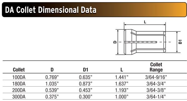

        I have some DA collets which were bought secondhand. Checking against the published dimensions I appear to have a partial saet of DA200s. The checked dimensions are CLOSE TO the published for that range, but not exact. What degree of tolerance should one expect for the D1, D2 and L values ? (I'm assuming the holding value will be to spec)

            Thank you Neil – I appreciate what you say about possible fragility but my query is actually about identification. The D1 etc. values shown on the 'net are Imperial to 3 decimal places and the items I have differ by 2 or 3 third place values. They are not marked as to type so I'm wondering if I actually have DA200s or some other type? The closeness of approximation is such as to generate a doubt but I can't find acceptable tolerances for collets and holders. Hope that makes sense – (got to be a first time for everything!!sad)

              Depends on what published sizes you are looking at. a quick google for DA200 gives the larger dia as 0.531", 0.532" and 13.7mm ( 0.539" ) and lengths of 1.188", 0.19" and 30mm (1.811" )

                This may help, if your collets are close to these dimensions should be OK, also remember there is a max tightening torque.

                  Thank you Jason and Emgee – " if your collets are close to these dimensions should be OK, " ,,, that's what I was after; Yet another raid on the piggy bank!

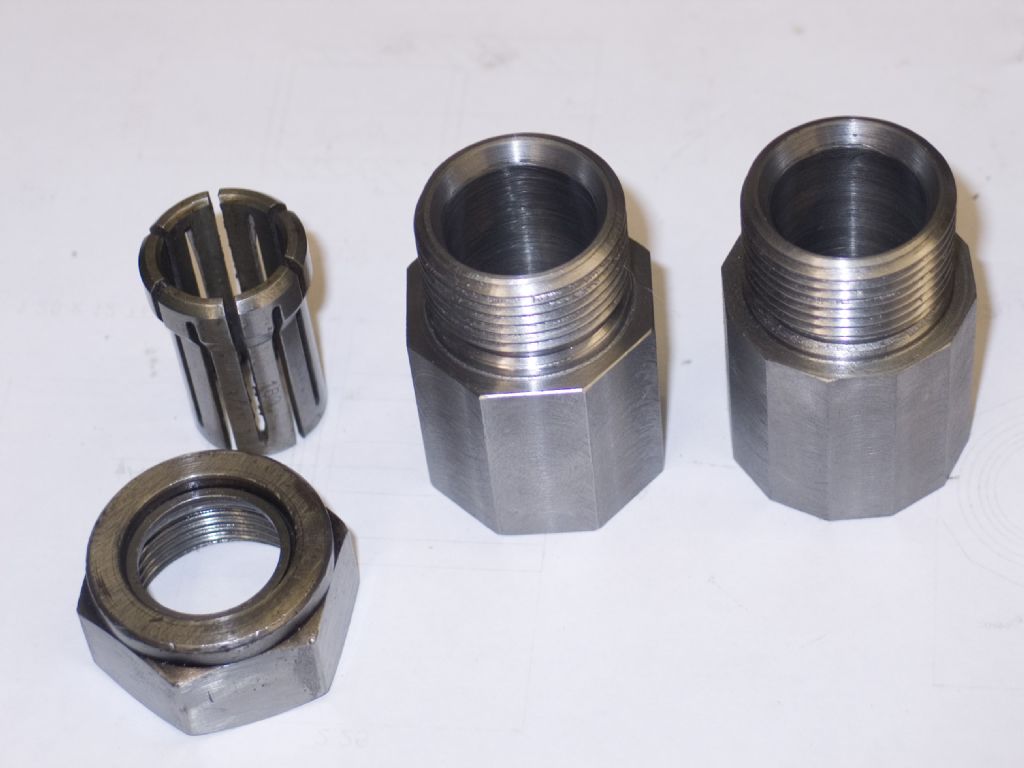

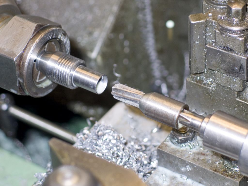

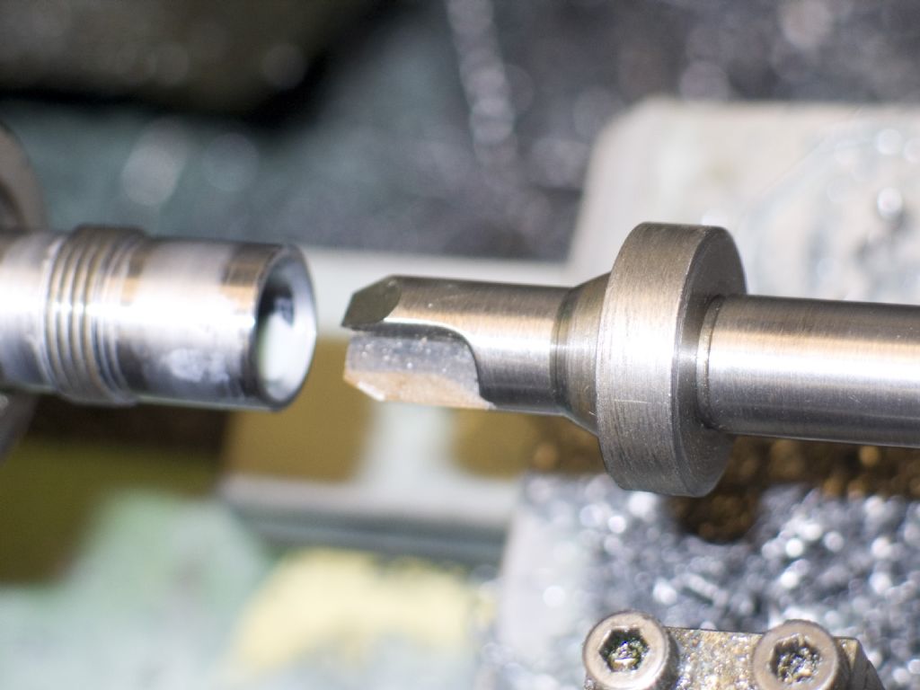

                    These collets are actually designed to collapse over the full length, they have a double taper where they get pushed into the collet holder, and a single taper that the nut pushes against.
                    Probably not quite as effective gripping power as an ER but still pretty good, I have used them for years with no problems. If you make your own collet holders the two internal tapers have to be precisely located with respect to each other to ensure they share the load and collapse in a parallel manner. I have made special reamers with tapered depth stops to facilitate this.
                    It is the middle two at the bottom of the next photo, they are for DA200 and DA300 collets.

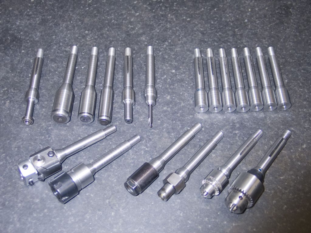

                    I also use DA180 for work holding.

                        Just to tidy this one up – the DA200 published dimensions are NOT exact. The new and old sets are interchangeable as regards holders.
