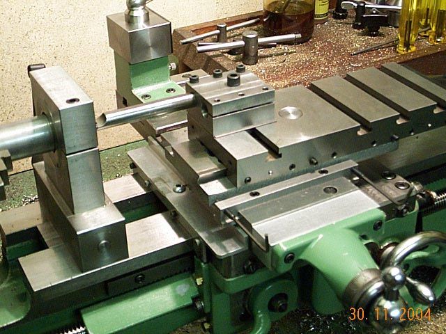

                  In default of a TTA I have fitted a spare ML7 cross slide to my S7 cross slide:
                  Fine adjustment of the "top slide" is via the gadget installed in the front tee slot.
                  Edited By ega on 02/04/2020 16:19:18
                  #461854
                  ega
                    @ega
                    PS I haven't used this setup for some time but, looking at the photo, I can see that the "top slide" gib is on the wrong side for taper boring, something to bear in mind for the future. That said, I don't recall any problem of lack of adequate stiffness.
