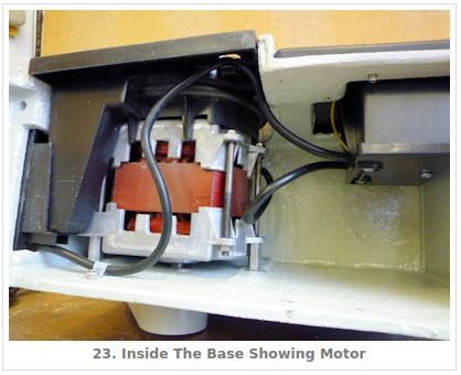

                              Aren't the motors in these sealed?

                                This is the motor in my BDS 460 belt sander:-

                                  OOooer..laugh

                                      Johns motor is the same basic design as that in my Draper sander. Casting shapes may be a touch different but the semi open design is just as potentially vulnerable to sanding dust and debris if its allowed to build up.
                                      Sanding / linishing dust was certainly what killed my first motor. Was horrified by how much had gotten in when I opened it up.
                                      Made an effort to pull the bottom off and clean the second one out "fairly often" but by the time I passed it on it wasn't a very happy camper with starting issues and a tendency to slow down after a few minutes. Still running onb light duties and very occasional use for my friend. but he took it mostly because he had avery occasional need that didn't justify purchase.
