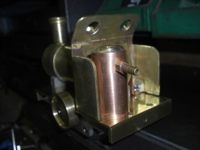

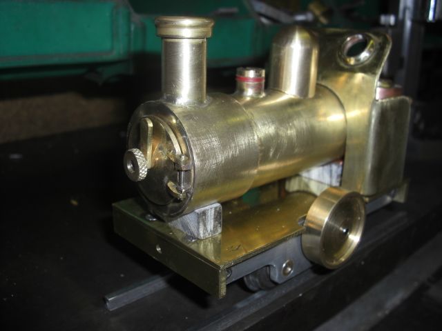

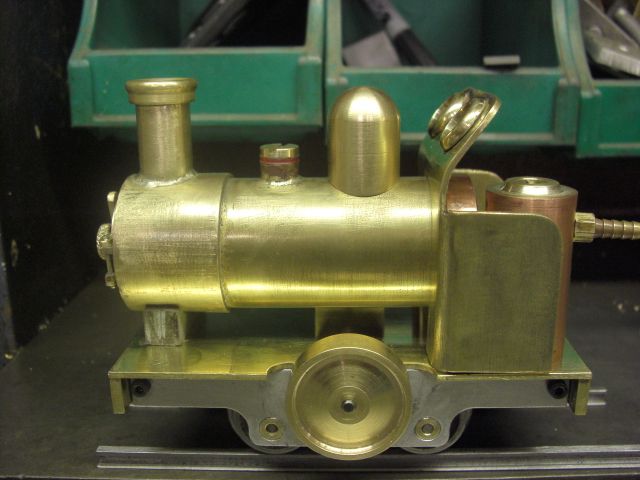

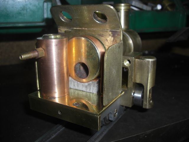

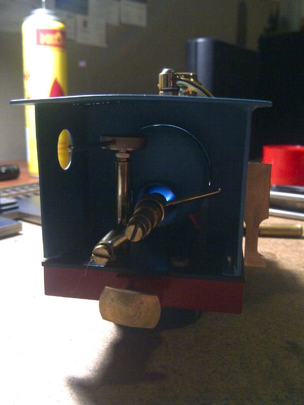

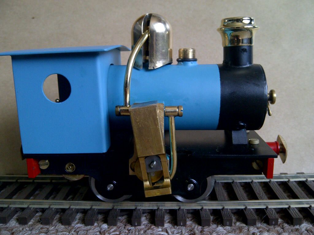

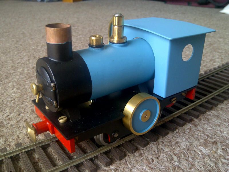

                    HI Kevin
                    I used the drawings from John Tom that were in PDF form and found them to be relatively good.
                    I made my own gears and pinion in the lathe and they 'turned' out fine!wink
                    I've also made a couple of changes to the overall look of the little loco.
                    See pics below
                    If you need any info on the build, let me know!
                    Good luck with yours!

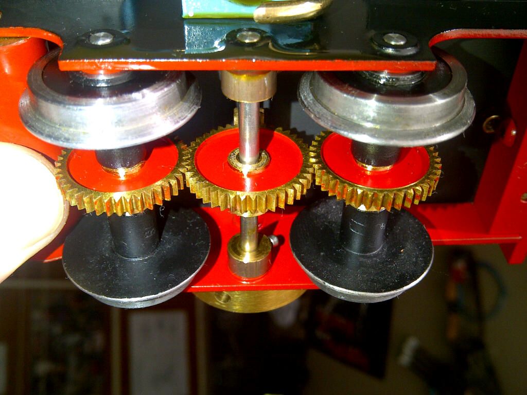

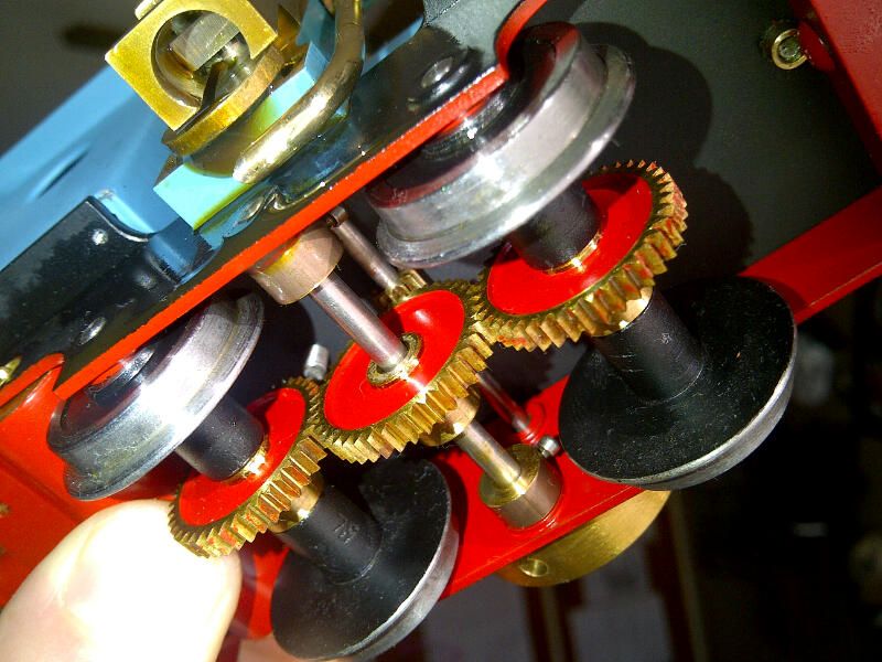

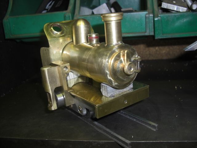

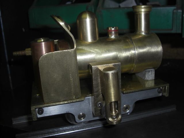

                        hi Guys this is my Cracker to date after several weeks work I still have some parts to make and making the gears I keep putting it off as I have never made gears before so it will be a challenge.
                        I have had the oscillating engine working and runs ok
                        thanks Kevin

                          hi the gears are available from http://www.hobby.uk.com
                          #173303
                          Kevin Bennett
                            @kevinbennett25223
                            thanks for that I will have a look as it may be the best way forward
                            ty Kevin
