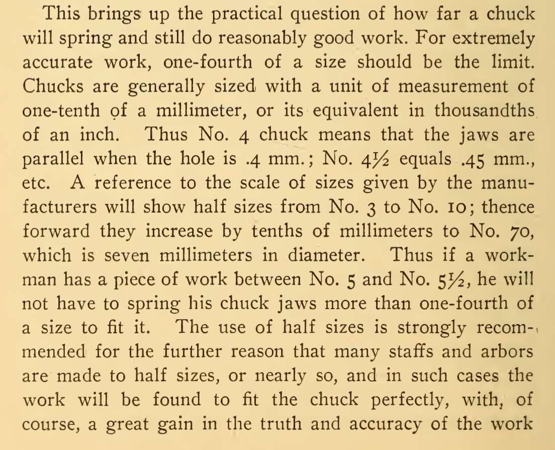

                  Maybe worth noting that 4C collets (et al) fall into the same design concept as watchmaker’s collets … and therefore are intended specifically to hold nominal size.
                  Obviously the realities of life demand some tolerance … but this very small and the quality of holding falls dramatically if liberties are taken.
                  MichaelG
                  #711488
                    A short extract from:
                    The Watchmaker’s Lathe
                    It’s Use and Abuse
                    Goodrich : 1903
                    source Right
                    Scale as you see fit, but the principle is inescapable.
