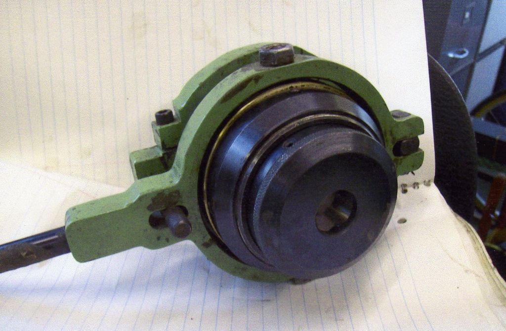

      Is the any-one out there who can inform me of the type/name of the collets which should be used with the ‘Warco’ chuck  illustrated and where they can be purchased ?
      The collet drawing shows approx. sizes of a style that should fit. The chuck was purchased some 10 years ago but as of yet Warco have still not been able to provide me any usable collets. They did recently supply 2 sample collets for me to try but unfortunately neither were suitable. Warco’s finnal advice  was, “look on the internet, I’m sure you will find some out there somewhere” . I was not really impressed but here goes, HELP!

          Sorry I can’t identify it for you, but it looks like a fairly standard sort of spring collet, trouble is all sorts of companies made them, presumably in sizes to suit themselves. Crawford all seem too big but what about Ward, Herbert or Sharpe & Browne to name a few. Have you tried sending your sketch to some of the tooling suppliers (apart from Warco) to see if they know of anything that will fit. Trouble is you need to find an old school tooling supplier rather than a new school -” can’t help without the part number” outlet.

              Your device looks very similar to that which was originaly supplied wih the Warco 220 lathe. As it happens I have copies of some correspondence – not from me, I hasten to add – between a purchaser and Warco back in 1994. At that time the purchaser was having a lot of difficulty obtaining correct collets from Warco (does that ring a bell?) and had made some investigations himself. I will attempt to summarise what he said.
              The collet seems to be DIN 6343 144E.Din 6343 143E is shorter but with a ring on top also works.

                  It might be worth spending some (a lot) of time browsing through the Hardinge on line catalogue  http://www.shophardinge.com. If it isn’t in there then I think it will be a case of buying some bar and starting making them.
                  You’ve got the outside shape already, and a chuck to try them in for fit, so with care that should be achievable. Then fit the collet holder to the lathe, insert the blank collet and drill/bore to the size you need in the holder. That should give you the best chance for concentricity to your holder. Repeat for all the sizes you want and then rig a simple holding device to allow indexing to 3 positions 120 deg apart and slit with a slitting saw.
                  There have been a number of article in MEW over the years about making collets of various styles and they all boil down to pretty much the same sequence. All say leave the collets soft as there is too much danger of distortion during hardening, and anyway in normal hobby shop use they’ll last a long time anyway. Probably get a better grip on a hardened shank such as a milling cutter as well.

                      In our part of the world these collets are called F-type. However, a collet with shaft dia of 25 mm has a total length of 77 mm and a nose dia. 27 mm. The cone angle is 32 deg.
                      The given dimensions seem to be converted from metric ones?
                      So I suspect it is really a ‘special’.

                        The Warco 220 lathes were and in fact still are made by Mashtroy http://www.mashstroy.bg/c_210_t.html   I seem to remember a collet chuck being available although I can’t see one listed on their website now. They maybe worth a quick e-mail though.

                            They look like a smaller version of the Ward 2A collets
                            The rough angle on a ward 2A collet I have is about 15 degrees…yours is 14.5degrees
                            So Ward 1A? which are an inch in diameter

                              I had thought I might be able to assist with these, as I have a box of similar shape collets that came from a scrapped automatic capstan lathe.
                              But when I dug them out today, while they are the same nominal shape they are different dimensions – overall length is 2.531″, the ground end opposite the taper is 0.471″ , the parallel section ahead of the taper 0.498″, taper max dia. 0.734″, taper min dia. approx 0.485″, taper length approx. 0.451″.
                              I cannot recall the make of lathe, but seem to recall that the collets were refered to as “dead length collets” – i don’t think that the length of material protruding changes as the collet is tightend. The collet chuck on this machine was either pneumatically or hydraulically actuated & there was a bar feed fitted.
