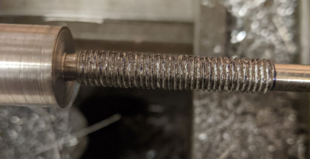

                          Tried some threading today, quite enjoyable, but the cheap chinese carbide threading tool I used was not providing good results. Took me a while to figure out the process, but since it was metric, had to leave the half nut engaged, but still just a good bit of fun before uni.
                          Threading video

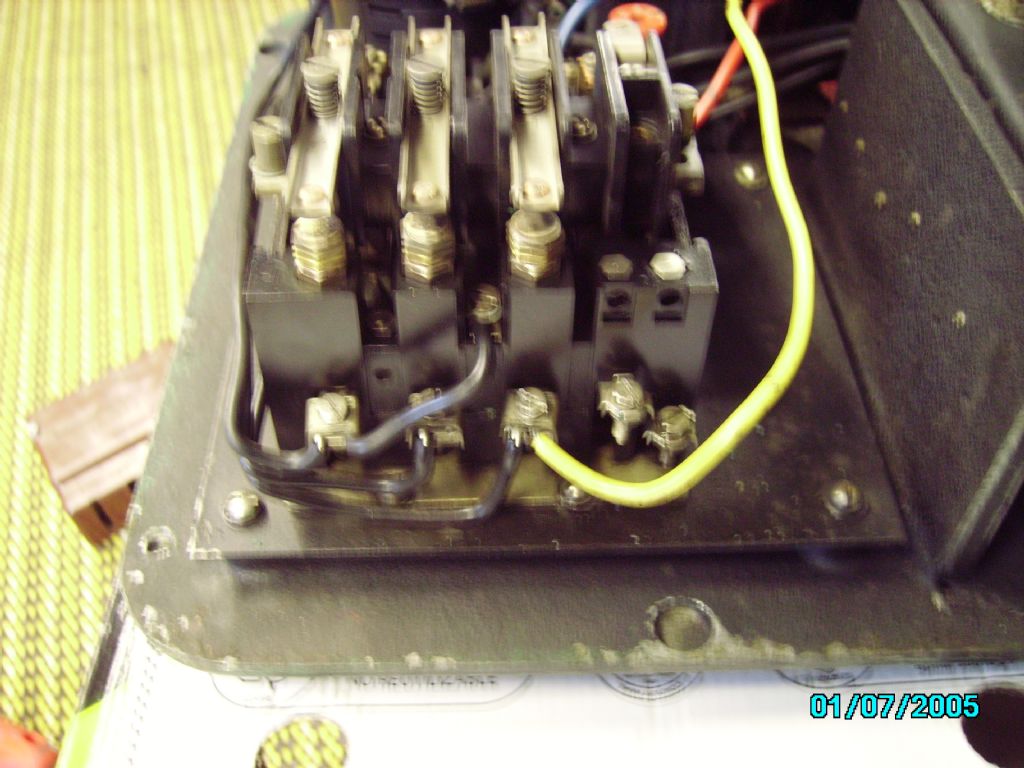

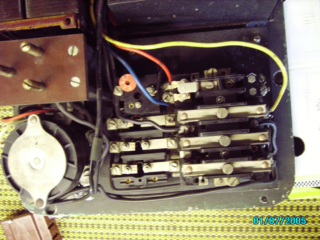

                            I'm home for the weekend and I need a little advice on replacing the contactor. The new motor is 3hp and is rated at 5 amps, so I've found a suitable contactor and overloads. (I think). My question is, how many poles do I need on the contractor. Is this appropriate? I have a friend who can help with wiring.
                            Contactor
                            Relay
                            Thank you

                              They look right Richard and they will come with a wiring diagram showing you the now famous holding in circuit, and the remote start curcuit Not to difficult to wire ip, especially if your freind is a sparky! If you get stuck give me a shout!
                              Phil.

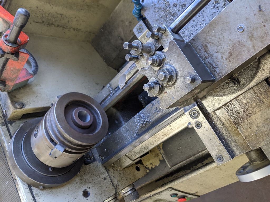

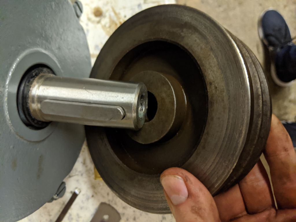

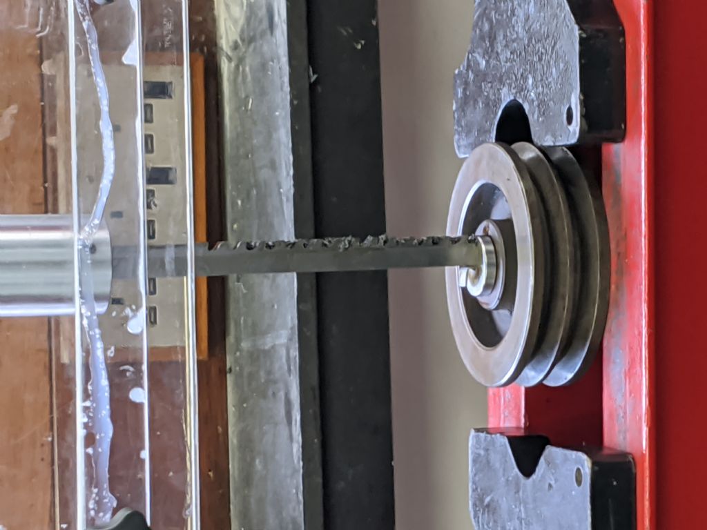

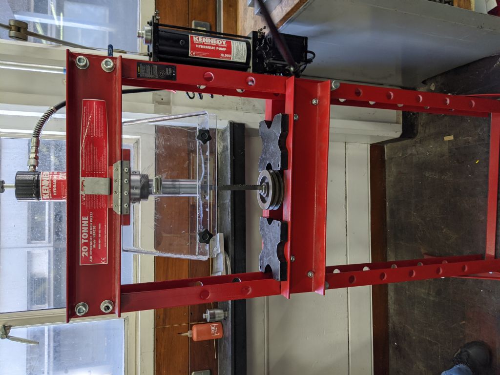

                                  Spent the weekend at home, just a quick pop back to get a few things, however I managed to make quite a bit of progress. I purchased a replacement contactor, overloads and a suitable lighting transformer to go where the old one used to be. I also picked up the motor pulley as the center needed boring and a bigger keyway put in since the new motor has a 28mm shaft with an 8mm keyway

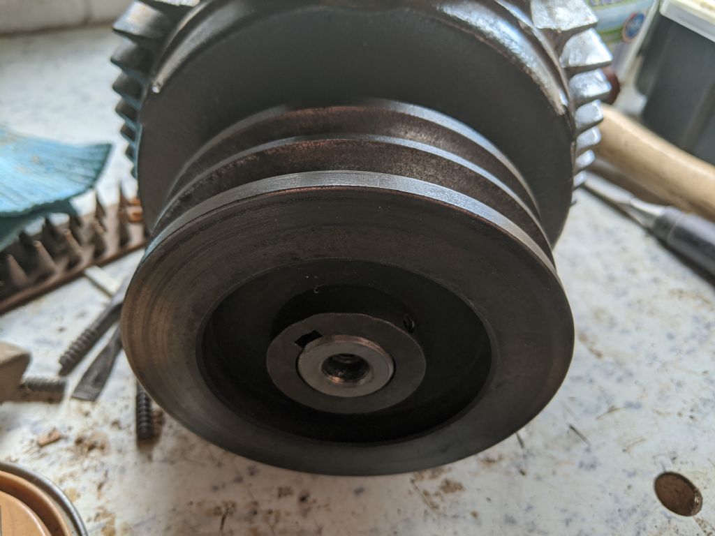

                                  First task was removing the pulley from the motor as it was pretty well stuck on.

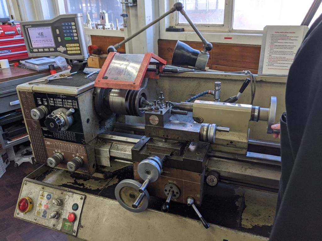

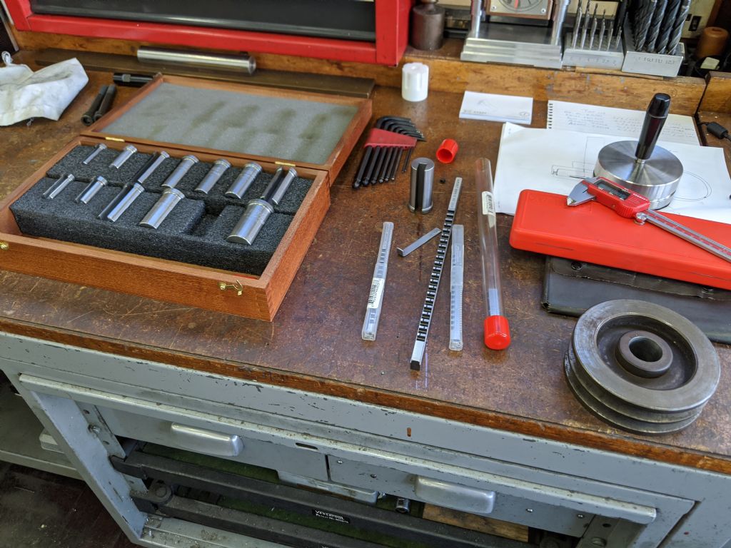

                                  Eventually I managed to get it off, so I brought it back to uni with me so I could take it to their machine shop
                                  The pulley was chucked up and bored on this harrison lathe. Having seen one like this up close, It would have probably been a much more appropriate size for my garage. Probably would have been a lot more expensive, and not nearly as much fin to fix up and annoy everyone on here with!
                                  The pulley was cast iron and was very hard to machine, luckily I had help from one of the workshop guys.
                                  I also had the opportunity to use some internal bore gauges for the first time.
                                  Then we moved onto the 8mm keyway using a broaching set. The workshop men found this quite fascinating as this kit had never been used before. One of them had used a kit before so he came and supervised the other man doing it, then another two watched.
                                  The broach slid through quite nicely, not much pressure was needed. I was quite surprised at this, but I suppose the press helped with that
                                  With that deburred, it's ready to go on the new 3hp motor!

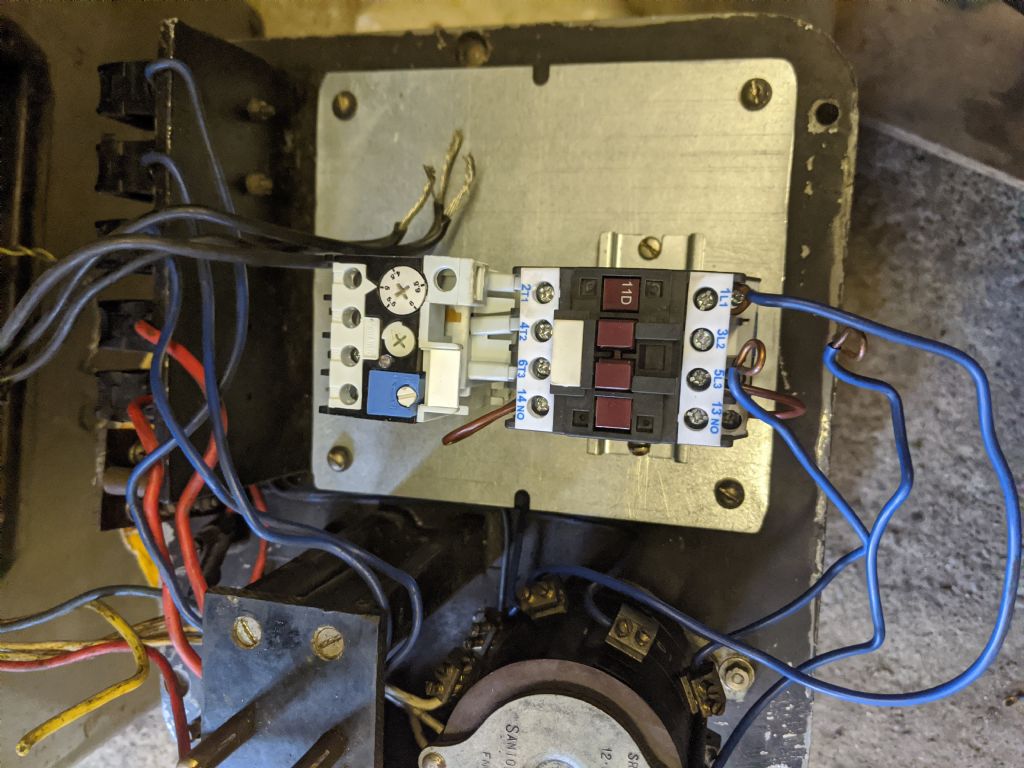

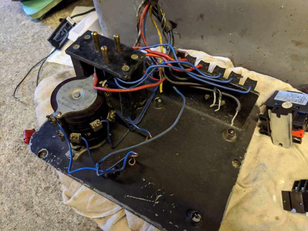

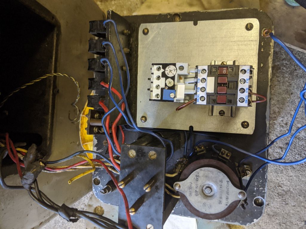

                                  However, when I was still at home, I had my "sparky" friend round to help look at the contactors and things. I'm not sure sparky is the best word to describe him, but he knows more about this stuff than me.
                                  Anyway, i showed him all the diagrams and things, took him a while to get around the idea of the switch being having 3 positions and having 3 wires coming from it, but after he read Phils descriptions he understood perfectly, So thanks to Phil once again.
                                  The mess we started with
                                  Taking the whole contactor and overloads out was a bit daunting. It wasn't too worrying to remember where the wires used to go since they had been swapped around and altered before.
                                  I proceeded to make a plate to mount everything to as my friend was wiring the contactor to work. This is as far as we got since I had to get the train back to Hull. Still, progress. I need to go to the limit switch and attach the wires back into their original positions as seen in Phils one. Then we can figure out which points the red yellow and blue wires need to go into the contactor.
                                  #455511
                                  Richard Kirkman 1
                                    @richardkirkman1
                                    The lighting transformer is simple enough to wire, so I'll be able to get that done and just have my friend check it. I have a nice red switch (with a satisfying click) which I want to use for the on and off switch, the main issue will be mounting it in the hole securely. I'll have to make a plate to go onto the back so its set at the right depth. I doubt i'll end up using the light very much, but I want it to function properly since otherwise there'll be an empty hole.

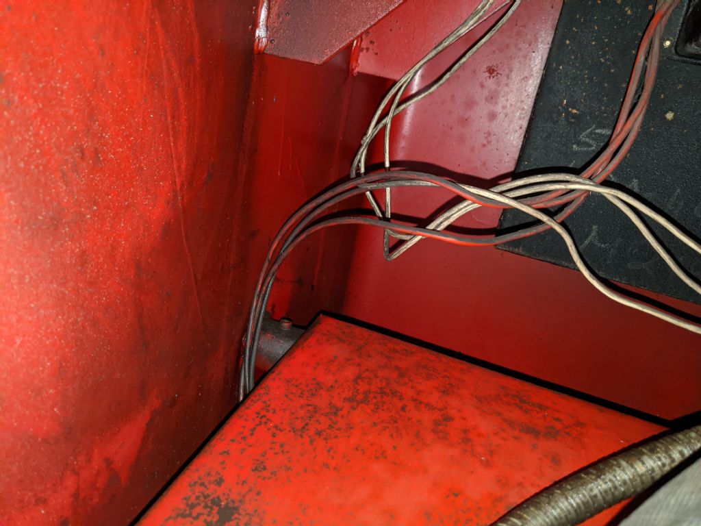

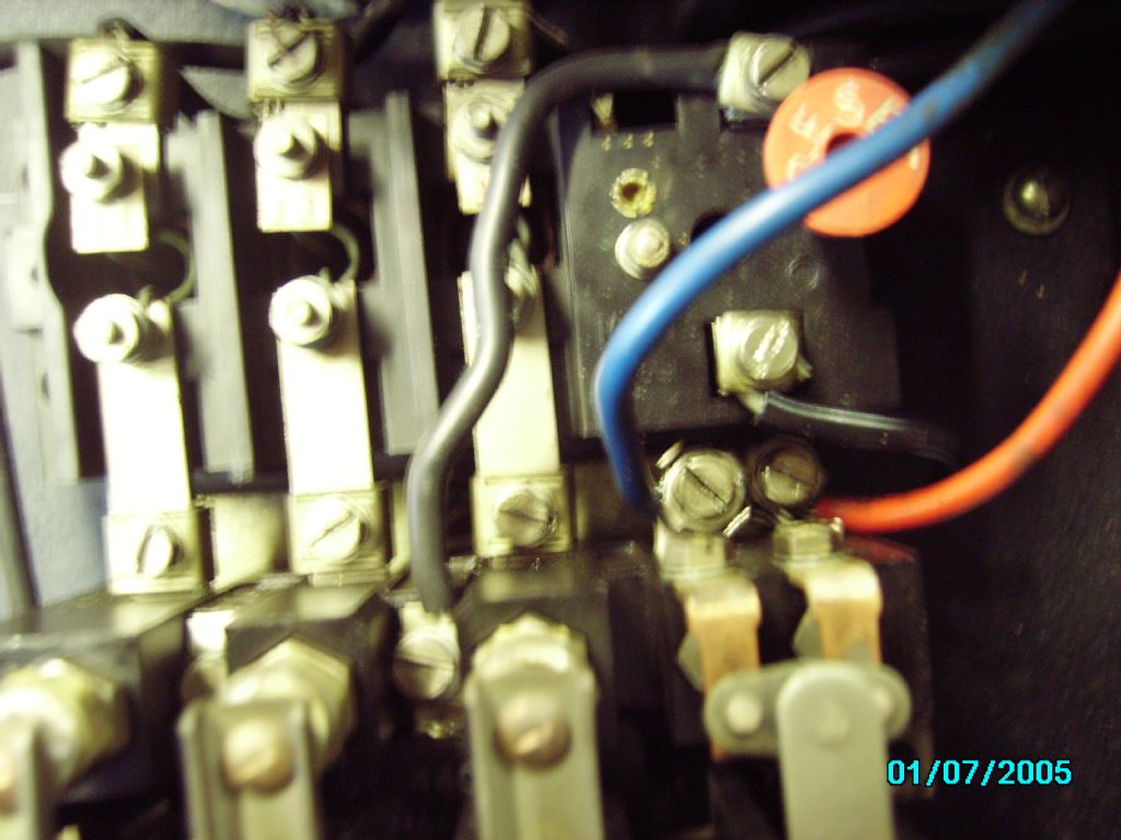

                                    Phil, would It be possible for you to take some more pictures of your contactor with the brown cover off so I can see exactly where each wire is going?

                                        Thanks Phil, no rush with the pictures, just whenever you have the time.
                                        Just wasn't worth getting my own broach kit, the workshop guys said it was about 180 quid I think. Which isn't too bad, but not good for one time use
                                        The machine shop is honestly one of the main reasons I can't to Hull, no where else seems to have it. They've got a large selection of machines. Sets of 4 mills 4 lathes and 4 large pillar drills, all Chinese but look flash for the foreign students and stuff. Whereas the machinery that interests me is the older stuff that most students don't look at, they have the small Harrison m250 I think? And an m300 or something, it's probably 3 meters long, which for me is pretty fascinating, especially now I've used both machines. They've got a CNC lathe in there too. But the main event for me is the radial arm drill in there. Probably the smallest radial arm drill you can get, but still taller than me. Also some nice vertical metal cutting bandsaws, plus a power hacksaw.
                                        We're currently in workshop every Monday building robot that can pick up a can of coke and pour it. Needed to use some lead screws, but the workshop doesn't have any trapezoidal taps. They're about 80 quid per tap. Luckily I found one cheap on eBay for 9 quid, so I'll be able to make some stuff at home with it too. I'll put some pictures up when it's finished, just for fun. It's an interesting project as we're having to do it as a group from all the drawings I've made.

                                        #455752
                                        Phil Whitley
                                          @philwhitley94135
                                          Here you go Richard, make of them what you will, if you get stuck, give me a shout!

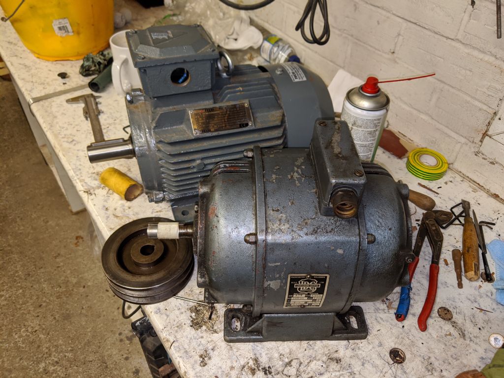

                                              Incoming progress, University has been cancelled (all lectures and exams moved online) thanks to the dreaded Corona Virus. So, I'm able to do University from home, which really means I'll be able to go in the garage!

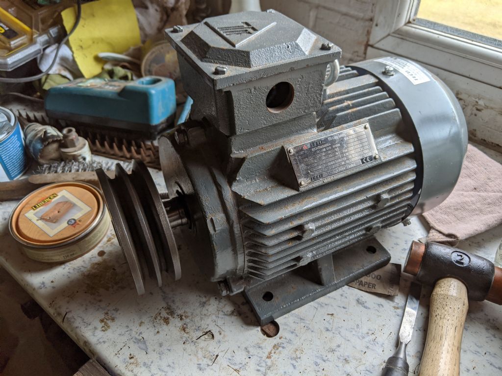

                                              Just got back today, test fitted motor pulley onto new motor since machining.
                                              When the pulley cooled down to the ambient temp of the garage, it slipped on perfectly, and more importantly, it will still come off with a little pressure.
                                              I'll look at finishing the contactor and modifying the motor mounting plate next. Still making progress on getting the three phase fitted back in

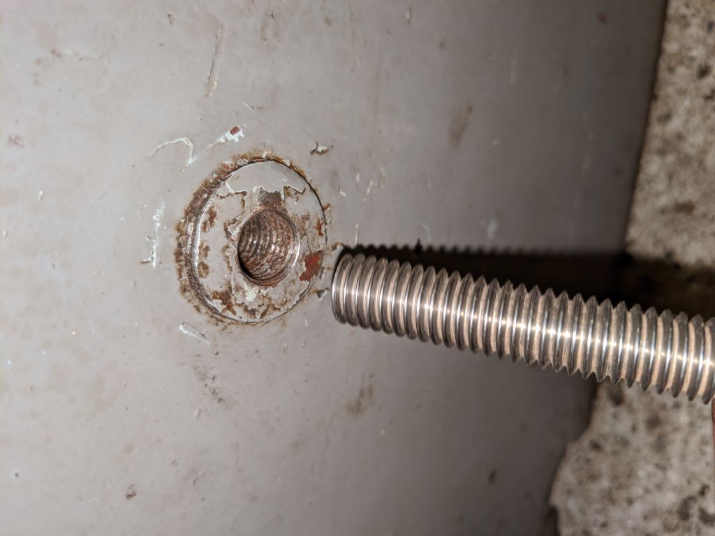

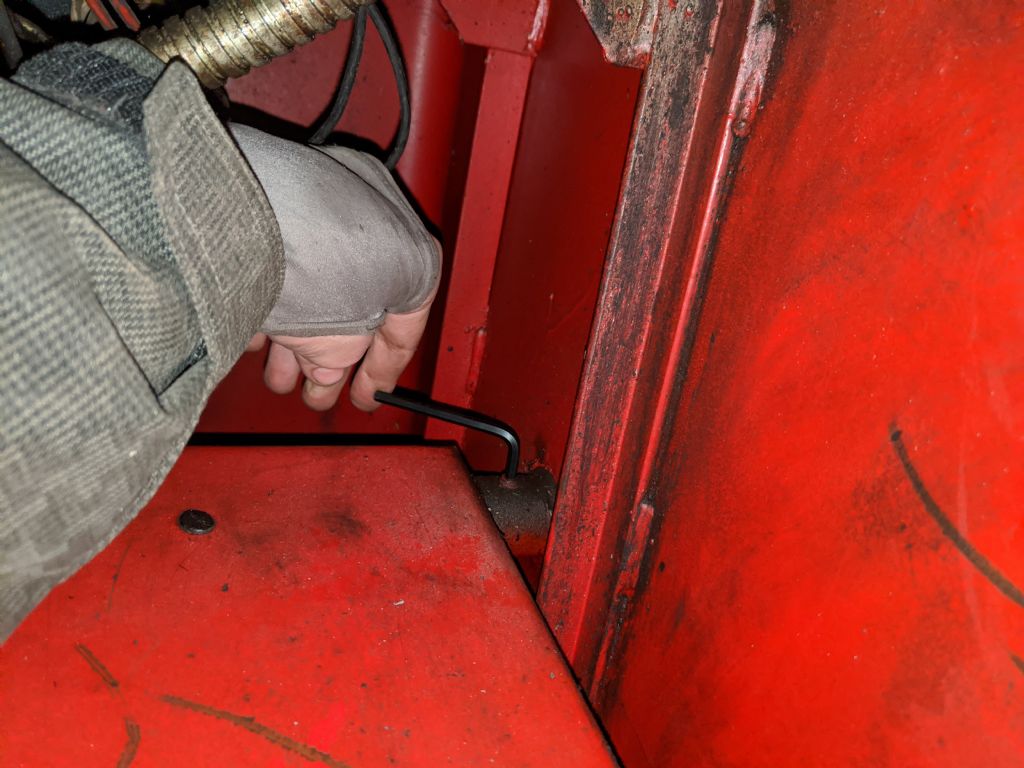

                                                  So, today was spent tidying the garage. Somehow my dad manages to get it into a complete mess in a month, while not doing anything in there.
                                                  Anyway, it's all tidy now, so I started looking at how to remove the plate that the motor attaches and hinges on. There seem to be two set screws holding the shaft that the plate rotates on in place, then there's a hole in the end with a thread which I presume a bolt is meant to go into to provide a way of pulling the shaft out as its only accessible from one side. The manual doesn't show any of this, and in the later manual it shows a different way of being secured.

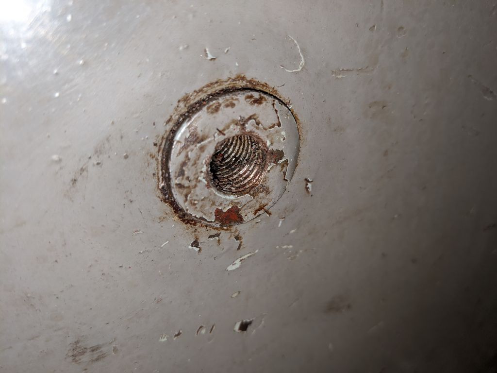

                                                  So the hole is half inch from what i can see, but a half inch threaded bolt does not fit.
                                                  Probably just got the thread wrong, but any thoughts?
                                                  My wiring friend wants to keep a low profile so it'll be a few weeks before we get the contactor finished. Plenty to work on meanwhile,
                                                  Pitch seems too course? Imperial threads aren't my forte
                                                  #458889
                                                  Phil Whitley
                                                    @philwhitley94135
                                                    That stud you are holding looks like Whitworth, try a BSF bolt, A lot of the fixings on mine are BSF. This is where you need boxes of assorted old nuts and bolts so you can find a fit, and then measure it with a pitch guage, measuring an external thread is a lot easier than an internal. 1/2" BSF is 16 TPI.
                                                    Stay Healthy!
                                                    Phil

                                                      I've only got a metric pitch gauge currently, will look at getting the others eventually. Possibly very soon now i'm not having to spend my student loan on food!
                                                      I don't have a box of old bolts and things, not something I've really had time to collect
                                                      I'll have a go at getting it out from the inside once I've finished a bit more of my essay. Still got uni work to do, unfortunately!
