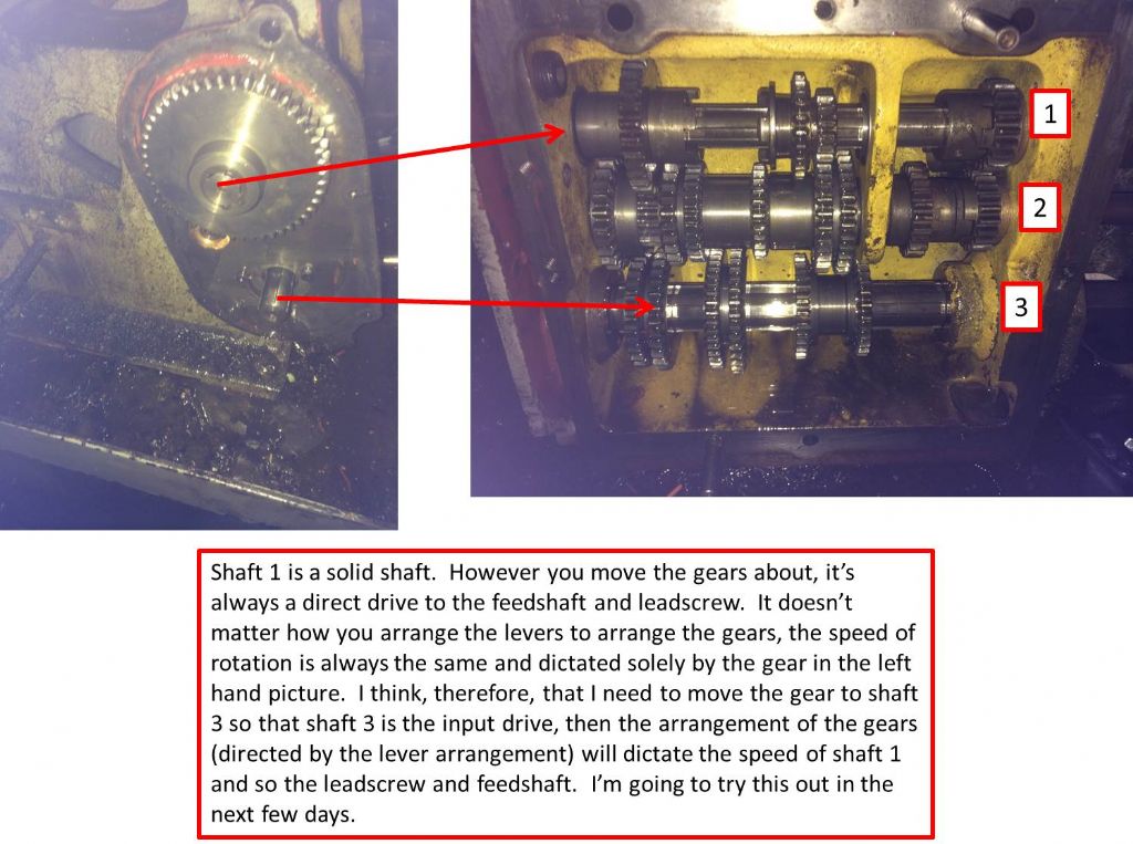

                Hello All,
                I hope this is the right place to ask my question and seek advice.
                I've just acquired a Bantam 2000 and have got it up and running and have even taken a quick facing test cut with it and it all seems OK.
                However, I am having some difficulty with trying to change the feed rate. It seems that, whatever combination of the screw cutting gearbox levers I engage, the speed of the feed shaft doesn't change and nor does that of the leadscrew (I've tried to explain this clearer in the pictures in my next post). Both shafts turn and transmit power OK and the levers feel like they're engaging properly (I get that having-to-wiggle-the-spindle-to-fully-engage-the-levers feeling when I'm engaging them) so I don't think anything's broken. I feel like I'm missing some crucial step but don't know what. Can you offer any advice, please?

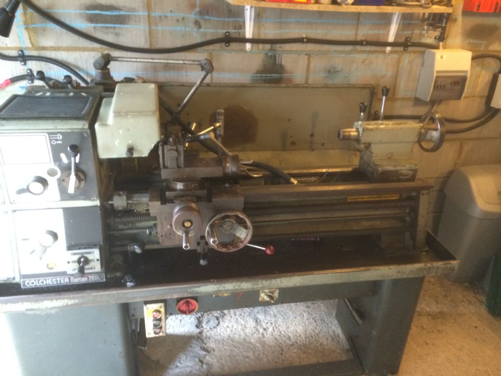

                          Clem Sayers
                            @clemsayers49444
                            Hello All,
                            My lathe is a Mk 2 Bantam (see 2nd attached picture).
                            Thank you very much for your replies. I bit the bullet and pulled the covers off the screw cutting gearbox to have a look. I think I've worked out the problem (see attached picture with notes). Bit of a funny one but I'm going to try my solution out over the next few days and see what happens. I'll let you know the outcome.

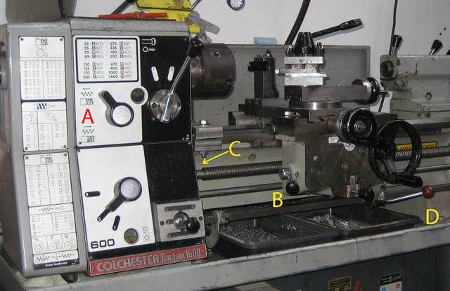

                            Breva
                              @breva
                              colchester lathe 2  copy.jpg.
                              Your lathe is probably similar to the above, but note the above has a metric leadscrew.
                              First, There are three different sets of gearing ie. N, P or Q as seen on the bottom left of the front cover. See above. These are set on the left end of the lathe.
                              Lets assume you want to cut a 1mm pitch thread. On the panel it shows that a 1mm thread can be cut using either the combination PS1 or NR3. Choose one of these and check that thats the gearing setup that is actually in place under the end cover on the left. Lets say you pick gears P. (as in PS1). Set the two appropriate levers on the gearbox front, ie. to S and the joystick to 1
                              Set Lever A to the required direction of cut. Engage the dog-clutch C. Use lever B to engage/disengage the half-nuts.
                              Use lever D (red knob) to drive the cutting tool to the left, and when the cut is finished withdraw the tool and use lever D to reverse the tool back to the start of the cut. (Leaving lever B and the half-nuts engaged).
                              Do not use the clutch lever on the front of the apron while screwcutting.
