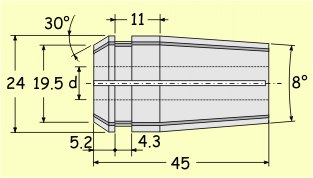

              Have a look at post No. 16 here:
              https://www.practicalmachinist.com/vb/general/newbie-what-type-collet-239158/
              There, they are called Q24-16.
              Life is very circular. That site also references this site:
              https://www.model-engineer.co.uk/forums/postings.asp?th=102111&p=1
              where the drawing above first appeared.
              #521607
                Posted by DC31k on 21/01/2021 20:29:02:
                Drawing appeared before that on ARC's website where I snipped the image from.
                Note the Q24 are shown as 10deg, the Arc as 8Deg
