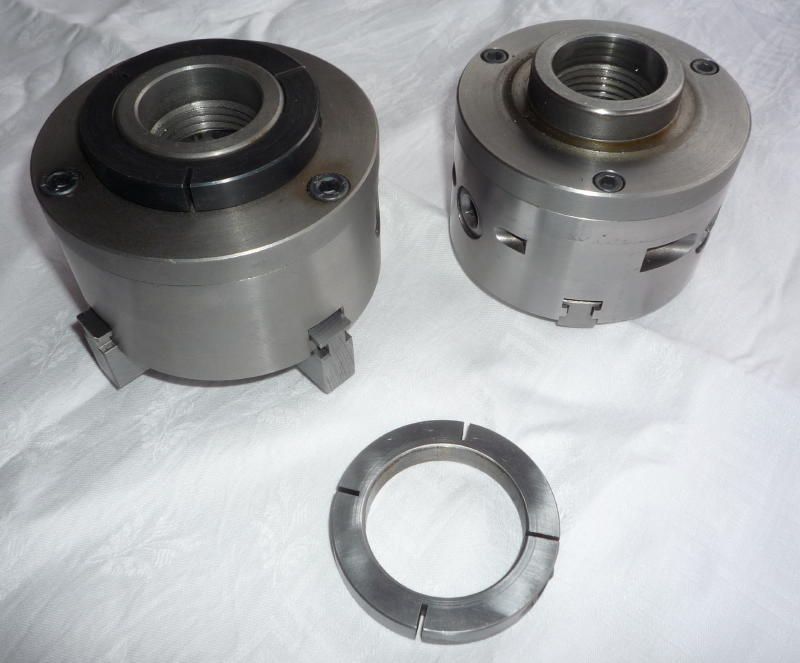

      I have placed a photo in my collection of a chuck with a locking ring.
      This is the method used by Schaublin to stop screwed chucks from unscrewing in reverse.
      The back plate is machined to accept the ring and I do believe the rings are obtainable commercially but have not found a source.

        A clamping ring that will stop chucks unscrewing in reverse

          How does it work?
          I have looked at the picture (in your Myford album?) and I can see it gripping the backplate collar tightly, but what does it connect to on the spindle?
          The main point is though, will it work on a Boxford?

            Ian, its purely compression on the machined seat of the back plate, all the time I have used one I have never had a chuck shift.
            It will clamp on the parallel portion at the end of the thread.
            The ring is76mm dia, is 12.95 wide, the bore is 49.99 dia.
            It has a step on one face to clear the fillet on the back plate.
            Slots are 10mm deep at 90deg and the 4th one cut thro. The clamp screw is M6 Skt hd.
            Hopefuly you would have enough meat on the backplate to fit such a ring?

              Sorry for being thick, I can see thet the ring closes down to grip on an OD but Is the bore stepped so that it clamps on the OD of both the backplate -and- the exposed part of the spindle?

                Ian, the bore of the ring is plain and the small step is just 1.5 x 1.5mm to clear the machining fillet in the corner of the back plate where the round nose tool has machined it. It could be a large chamfer if that is easier.
                The ring is the full width of the seat on the chuck back plate and does not touch the mandrel.
                The concept is that it clamps the back plate down onto the mandrel plain portion which seems adequte to lock the ring tight.
                I will take another photo dismantled shortly, and post it for you.

                  I’m with Ian on this one. I cannot see how it works. If I read you correctly you are compressing the back plate register onto the spindle! mm! Am I missing something.

                    Yes, it must rely on the clearance between the mating parts being very, very small and the compliance of the backplate register to allow it to be crushed sufficiently to grip the spindle.

                      It’s a standard fitting on all Schaublin chucks and has worked fine on all four of the Schaublin lathes I used.
                      When I ordered a new chuck for a Schaublin lathe it came with ring and backplate complete. I did not have to machine or develop it at all.
                      It is a viable means of locking the backplate to the mandrel, unless someone comes up with a better one for a screwed chuck.
                      I have used the bolt on type chucks and I prefer the locking ring type much better.

                        An old story, going back almost to the time when Noah built the ark. I mentioned this system on other places, more than once I think, and almost everytime I saw the same reaction. No one seems to believe that it only works by compressing the neck of the backplate. There is no place where the ring touches the spindle!

                            I can fully understand the concept of the clamp reducing the ID of the backplate collar so that it grips the mandrel better. What I cannot get my head round is how an M6 bolt can provide enough force to close down such a thick annulus of cast iron.
                            Metal is certainly compressible, I once saw a test rig that compressed a 1.5m length of 3″ diameter steel (big diesel engine con rod) repetitively, at a guess it shortened by 5mm then sprung back every time). With this chuck clamp, any clearance on the register would certainly nullify any reduction in diameter.
                            Unfortunately I don’t have a Schaublin to look at but wonder if there is anything else involved that we don’t know about, like slits in the collar to allow it to move?

                              Remember that the ring will exert a magnified clamping force across the diameter of the flange by virtue of the fact that a reduction of the circumference will be multiplied by the function of pi.
                              So a change of 1 unit of the circumference (by tightening the clamp) divided by 3.142 equates to a theoretical change of 0.3182 units of diameter.
                              A kind of gearing or leverage effect is in action here and very little movement is required which is why – counterintuitively, it works.
