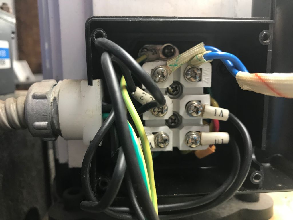

                        I have put pictures of the existing capacitor and motor junction box in my album, For some reason they will not add to this post.
                        Les, I do not know how to check centrifugal switch. Picture of junction box is in my album

                            Hi Colin,
                            I can't follow The wires in the connection box well enough to identify the connections to the centrifugal switch directly. I think I can follow it well enough to see that the capacitor connects to the top two terminals. If you disconnect one of the wires to the capacitor then measure the resistance between these two terminals I would expect you to get a reading of about 10 ohms.(I am guessing it will be about a 0.75 HP motor. It would be lower on a larger motor.) This reading will be the centrifugal switch in series with the main and start windings. If the switch is open circuit the reading will be quite a lot higher. (A high reading could also be caused by one of the windings being open circuit but this would be unlikely,) You could do a very rough test of the capacitor by connecting a 100 watt old fashioned tungston filiment lamp in series with the capacitor, When connected to thje mains via the capacitor the lamp should light almost as bright as if connected directly to the mains. As the reactance of a 150 uF capacitor at 50 hz is about 21 ohms the voltge across the capacitor should be about 8 volts. Only try this if you are confident working with live mains circuits.
                            Les.

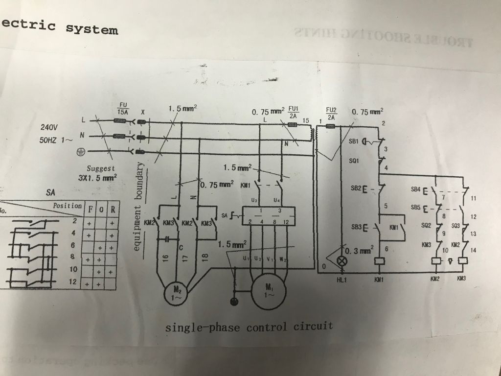

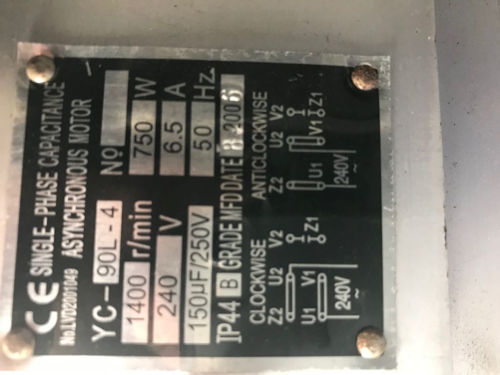

                              img_4312.jpgimg_4311.jpgOnly just had chance to take a look. Powered on and worked 4 or 5 times. Enough to think will set a job up to mill couple of slots in an arbor. Got job almost centered and it stopped again.
                              Took left hand capacitor lead off junction box and put meter across capacitor connections on junction box (no reading), tried across capacitor leads no reading. Meter set to 20 ohms scale, displays a 1 when nothing connected sand still displays a 1 when connected across the junction box or the capacitor.
                              Loathe to try live electrical test as no one else at home at present.
                              Pictures of junction box, electrical circuit and motor plate below.
                              Colin

                                  If the machine is still in the not working condition do the following WITH THE POWER REMOVED. Disconnect the wires U1 and U2 from the motor terminals. (These are probably the run winding.) Measure the resistance between the teminals they were removed from. If you get a low reading Less than about 15 ohms then this is the run winding. (If you get a low reading go to step 2. If you get a very high or infinite resistance reading then this will be the start winding in series with the capacitor and centrifugal switch. With the meter leads still on the terminals short out the capacitor terminals. If the centrifucal switch is close (Which it should be with the motor stopped.) then the meter should give a low reading. ( Less than about 20 ohms.) If you still have a high reading then the centrifugal switch is faulty. Goto End.
                                  Step 2 Connect the meter leads to V1 and the bottom left hand terminal. (The lable is obscured by wires. I think it will be Z2 or W2) You should get a high reading. Short the capacitor connections. The reading should drop to less than 20 ohms. If it remains high the the centrifugal switch is faulty.
                                  End. Report the results.

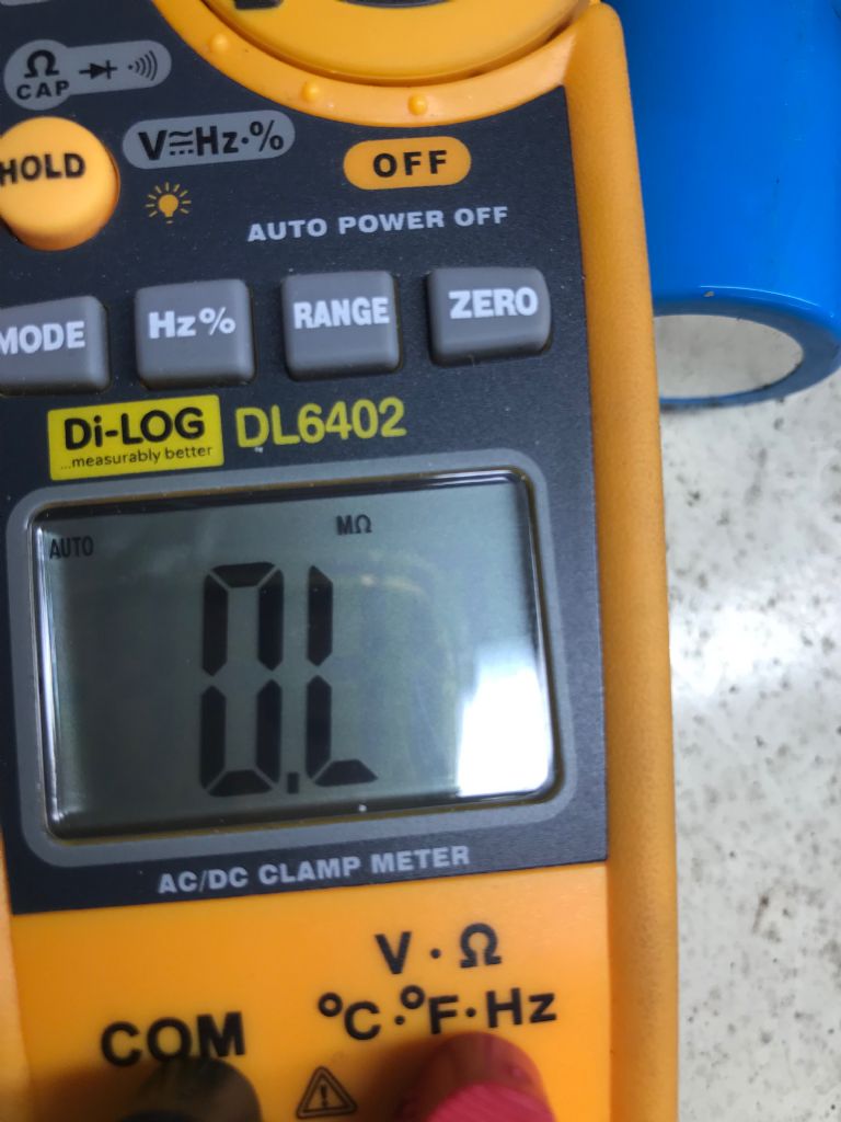

                                          Carried out step 1. and get reading of 3.1 or 3.2 ohms across terminals (2 different test meters)
                                          Step 2 – NO reading on either of two meters. As I did not get a reading I did not short out the capacitor connections.

                                              When you say that you did not get a reading do you mean that you got an infinite reading ? An infinite (Or at least very high.) reading is what I would expect with the start winding in series wth the capacitor and centrifugal switch. The idea of shorting the capacitor out is so you measure the resistance of the start winding in series with the centrifugal switch, that should be quite low less than 20 ohms. I have no susspicion that there is any problem with your mains supply.
                                              Les.

                                                By no reading I mean he display on meter does not change from that shown when nothing connected. As per picture below.
                                                I commented about the voltages that I see at home as several people had commented earlier that it would be a sensible thing to upgrade the capacitor from 250v rating to a 450v rated device. Though I am struggling to find one other than in China with a suitable long lead time.
                                                I shorted out the capacitor terminals whilst carrying out step 2 but the meter reading stayed as per photo.

                                                  Hi Colin,
                                                  The OL display means that the resistance that you are trying to measure is higer than the meter can read on the range it is set to. If the reading did not drop to a low value when the capacitor was shorted out then the centrifugal switch or the start winding is open circuit, (It is not likely to be the start winding.) If the capacitor really does only have a capacitane of a few nF then it is faulty. (There are 1000 nF in 1 microfarad.) I find it difficult to believe that both the capacitor and centrifugal switch are faulty.
                                                  Les.

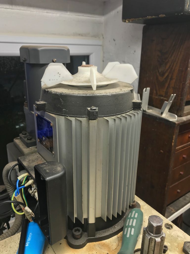

                                                    I will try Chester machine tools in the morning, their Burntwood site is only a few miles from my location. Will see if they have a capacitor in stock. Have you ever opened up this particular motor.
                                                    I assume that once I have levered the fan off (no fixing screws just a location flat on the shaft) and undone the three screws around the perimeter of the end case it should just lift off. Hopefully the connections to the end case will be on spade terminals.
                                                    Colin
