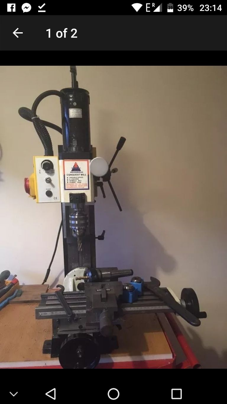

        Hello everyone. Im just after buying a secondhand chester mini mill (x2).could anyone be able to answer a few questions I have with this mill? Its an x2 mill with a tilting column. Has a gas strut, 130mm x 300m travel. The motor is a 350w version with a xmt 2335 control board.
        1. Can the solid column sold by arceurotrade be a direct swap or will the dovetails need machining to fit. Or would I be better off just making up a bracket to lock the column and brace it.
        2. Is it true the 350w is hobbled by the control board so it won’t break the gears. If so are there mods that can be done to get the the full power for the motor.
        I’m planning to get a belt conversion.
        I’m mainly going to be using the mill for motorcycle stuff. So I’d like to be able to fly cut and hopefully be able to make 1mm DOC in steel.

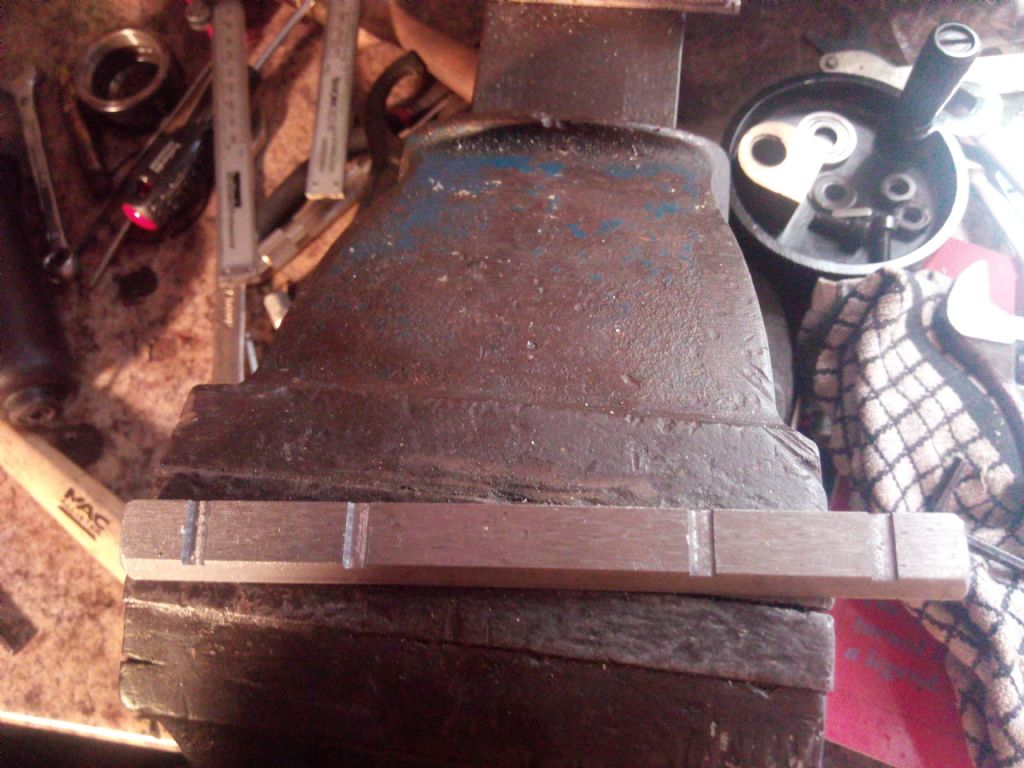

                                    Your comment: 'I noticed all the gib strips where not machined correctly for the gib screws , so I'll sort that before I put the table back on'
                                    My suggestion: make vertical slots where ever the dimples on the gib are. This will allow the grub screw to locate more easily in the slot rather than a dimple which may be higher or lower than the centre of the gib. If this fails, then you can consider re-drilling and tapping new holes in the casting, next to the original holes.. more in line with the centre of the gib.

                                      Looking at the picture of your mill, I am not sure but it looks like you have a milling cutter held in a drill chuck. If this is the case then it is a bad idea holding a milling cutter in a drill chuck. If it is a drill bit which you are holding in a drill chuck, then my observation is retracted, and maybe I need new glasses. teeth 2
                                      Ketan at ARC.

                                          It appears from your picture that the ER collet chuck, with a milling cutter in, does not have the collet correctly inserted in the collet nut. If that is the case the collet will not self extract and the cutter may not run true.
                                          Dennis

                                                      Thanks very much for the all the help guys , I milled slots in the gib strips and it helped quit a bit. Looking at the base of the mill it looks quite easy to make up an adapter to fit a solid column and I think that will be the route I will take after I use the tilting column for a while. 1525540337175.jpg
