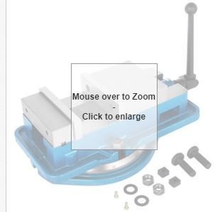

      What are peoples thoughts on this cheap 3" milling vice for use on a mini mill?
      EDIT
      Link removed see CofC
      But to keep the discussion going this is the vice up for $89auD on ebay

          The basic design is fine but with the swivel base may swamp a minimill though they are not needed very often.
          The real question is what factory did it come out of and what's the quality like. If a decent source then they work fine, I use a similar looking 80mm one on my CNC but there are also some that are not made so well depending on source. It's only a few dollars less than the ones from mainland companies like Ausee so is it worth taking the risk on quality.

            They are bigger than you envisage blush

              It's one of the things better bought where you can see and handle the goods – to check, for example, how well the jaw edges line up for setting and whether the moving jaw lifts, tilts or stays accurately aligned as you tighten.
              I bought mine (visible in some album pics) at an ME exhibition for about 20 quid and have no real complaints.

                Put an endmill or fly cutter into the spindle of your mini mill and measure the distance to the bed. Now subtract the height of the vice you mentioned from that to see what size of material you can fit into the remaining space. You may decide that the swivel base will take up too much of the space available for the amount of times you will benefit from the swivel.

                  No-one knows unless they've tried a real one.
                  I've got the same generic type and it's fine. Mine is painted green and has a simpler handle, so it may not be from the same factory, which is part of the game. Almost any firm with light-engineering capability could make them.
                  Maybe this example is cheap because the maker over-produced a well-made vice and is trying to reduce his losses. Or it could be cheap because it's a reject or was made too cheaply. Too cheap means fragile, off-true surfaces, jaws that lift, and a nasty lead screw etc.
                  It's probably reasonable but there are no guarantees. Buying inexpensive tools is always a gamble. Less so today I think than in the past. Before WW2 there was a sharp divide between good tools and utter rubbish and very little in between. Much less clear-cut today because many tools are in the middle; not the best by any means, but far from being a waste of money.
                  If a tool has to be unambiguously fit for purpose, there's no alternative to paying full whack for the industrial version. Unfortunately prices rocket to meet the higher specification. How about a nice Kurt? It has to be a new Kurt, because second-hand may be damaged or worn.
                  I hate empty descriptors like 'quality' and 'decent' in connection with tools, preferring instead to think in terms of "fit for purpose" and "value for money". If this vice is a good'un it's certainly 'value for money', but there's a risk it won't be fit for purpose. It's particularly unlikely to be fit-for-purpose used for heavy accurate clamping in a busy professional workshop, but mine was OK.  Note a vice that's too big for the machine isn't 'fit-for-purpose', and this one is quite chunky.
                  We all have to make judgements about how reliable our tools need to be. In my case, the answer is 'not very'. Provided they do what I need, which is relatively genteel, I don't need to waste money on tools that last. It's not a perfect system because there's a fine line between inexpensive and cheap and nasty! I come unstuck occasionally, but don't moan about it because on average the balance is strongly in my favour.

                    I've got a bigger version of this, a good vice.
                    Got rid of the silly handle and 3D printed a "speed" handle. Being able to move the jaws to the extremes of the vice has got me out of trouble more than once.
                    My other vice is a "K4" type and still gets used.
                    Neither has ever had the swivel part fitted.

                        I have on of these I bought from a reputable source and I have to say it is no better or worse than any other tool I've had from China. It certainly wasn't inspected or stripped down before I got it. The key between the fixed jaw and the base had been hammered in, there were still the hammer marks and it was bent. There were burrs on the jaw under surface. and the jaw faces don't line up perfectly. Having said this it is ok and usable and I continue to buy cheap chinese tools. I'm not prepared to pay over the odds for old battered machine vices on Fleabay.

                          I made the mistake of getting an "entry level" vice bundled in with my Mill purchase.
                          The fixed jaw wasn't even perpendicular to the base. A milling vice is a fundamental piece of kit in your workshop, and accuracy depends on it. Subsequently I purchased a Vertex and have had no issues.

                            I bought a 5" model from ARC which opens 6". It is as big as I would ever want to use on the drill mill and too big for the Tom Senior. have used it recently on the TS clamped in line with the X axis. This type of vise is best used without the swivel base attached. The swivel base takes up Z axis space and is best left for those jobs which actually need it. However, it you have the choice between getting the vise with or without the swivel base, always get it as there are rare times when it is worth its weight in gold. They are prone to getting a lot of swarf in them, and need to be dismantled and cleaned regularly. I would think the 3" that you are interested in will work very well with a mini mill, when you get it, check that it is square and will hold your work properly.

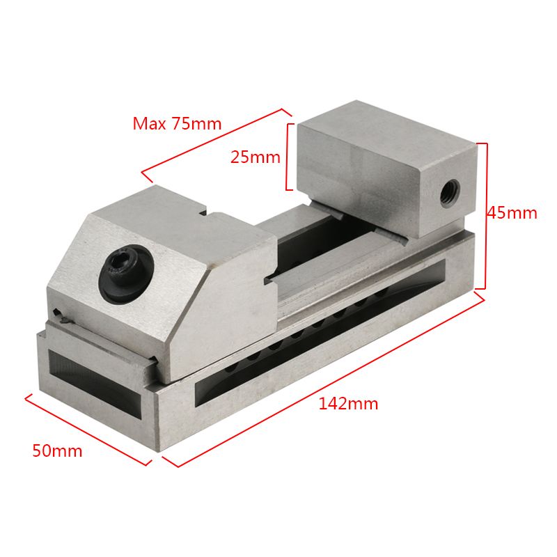

                                        I know two people who have bought this type of "machine vice" off Aliexpress and the quality is outstandingly good. Price is about the same as the one you were looking at. But its only a 2-inch not a 3-inch. But a darn nice bit of kit. Hardened and very nicely ground all over. Square, straight and parallel in all the places it should be. And the clamping action is downwards thanks to that angled clamping bolt.
                                        You have to use a pair of clamps and bolts to hold it down but can be made a bit easier by mounting it to a piece of flat plate with bolt slots cut in it.

                                                  For those that would want to hammer their handles the same style of vice that Blue Healer is looking at can be had with all the spheroids needed for an extra £20 or so for an SG Iron bodied version. Maybe it's the 90% of buyers who don't want to pay the extra who complain when they bust the bargain basement the vice.
                                                  But hopefully the lighter nature of these mills means they use far smaller cutters so should not need the vice hammering closed unlike a big horizontal with a slab cutter would.
