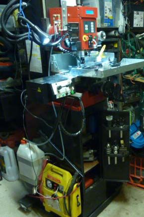

              Paul Lousick
                @paullousick59116
                Hello Johan,
                I made my coolant sytem from a 12 volt car windscreen washer pump and a 4 litre plastic bottle. Power from a 12v battery and variable resistor for speed control. Plug pack charger to keep battery topped up.
                Suction for the pump is from the side of the bottle, not the bottom so any swarf is not picked up.
                Paul.
