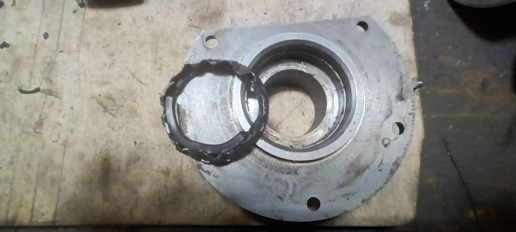

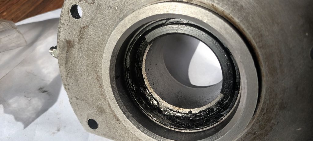

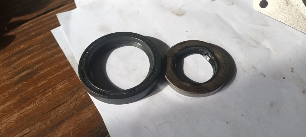

      I've got a colchester chipmaster and I'm attempting to change the 2 oil seals on the clutch shaft. They are two different sizes. The smaller of the two popped out with just a little effort. The second larger seal does not want to come out at all and i ended up really giving it a bit of a pounding (any more and i am definately going to damage the flange). My replacement seals are made of what looks like a hard outer plastic casing with a more pliable seal face with a garter spring. The original smaller seal has a metal casing with the seal with garter spring bonded to it. The smaller seal was fitted so the bottom of the metal casing was facing out of the flange but on the larger it seems to be fitted the other way round so I think the metal casing has been pressed into the flange. How can I get it out? The two things I've been thinking about are heat or getting someone to try and turn the casing so thin I can get it out?

          Got an old 1/4" wood chisel? Round off the square tip and tap it in behind the seal at the shallowest angle you can manage. Do this in several places and the seal should slowly come out. As the gap gets bigger, something blunter will be needed.

                    I believe that the picture is showing the inside face of the end cap, so the seal is the right way round. The rubber surface type can usually be fitted with just thumb pressure working round bit by bit.

                      I was wrong ,looking at photo again ,I can see that is a cap which covers the bearing .The seal is in right way round.

                          Thanks for this but not sure how it would work in this situation. My seal is fitted with the metal face in the recess. I don't think I could drill the seal without damaging the part it's mounted in

                            That makes it difficult. Try heating the housing to make it expand. Then get in there with a seal puller as linked to above, or carefully with a small screwdriver to pry the seal out. Or a seal pick, which is a tool like a small thin screwdriver but with a sharp point on the end. You buy them in a set and they have various angles bent over on the end to get in behind seals and pick them out. LINK

                              Possibly try using a Dremel, if you have one, to CAREFULLY cut a small groove in the metal ring to relieve some of the pressure before trying to lever it out.

                                Mart – thank you for the wood chisel tip. That and a bigger hammer sorted it!!

                                          Colin, when fitting the new seals, do apply some lubrication to the shaft (Don't touch the seal lip! )
                                          Running dry will shorten life considerably.
                                          If the shaft is worn by the original seal, try to locate the new seal so that the lip does not run non the worn area.
                                          (Ideally, the shaft and lipseal need to run in against each other, and a worn / polished track makes this process more difficult. )

                                            Thanks for this. I fitted them on Monday. I did oil the shafts before assembling. I was back down there tonight and the oil was still in the lathe so I'm hoping it all went well!
